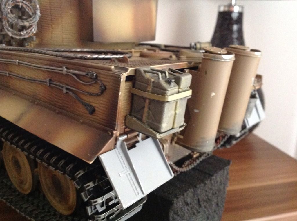

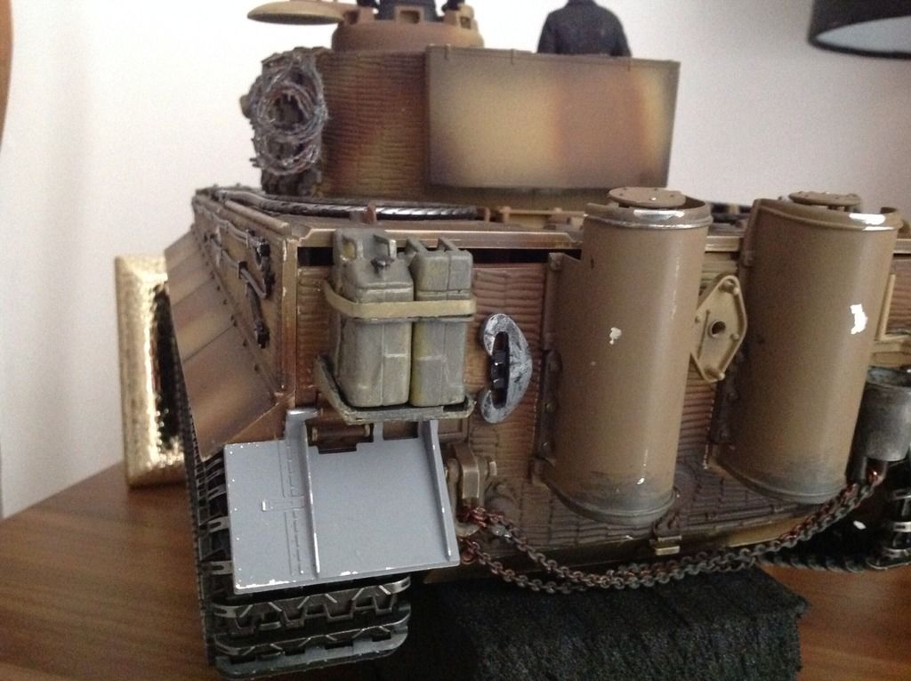

Looking great Kaiser ! Here's a pic of my rear stowage for jerry cans.....not perfect but I'm fairly happy with them for now. Also the hull reinforcement I've done has made the hull solid with no flexing at all. The front one also slips between the gearboxes. So will be running today thanks to you :). Excuse the grey mud guards....there's a bit of painting to do round the back yet :)
Cheers buddy
