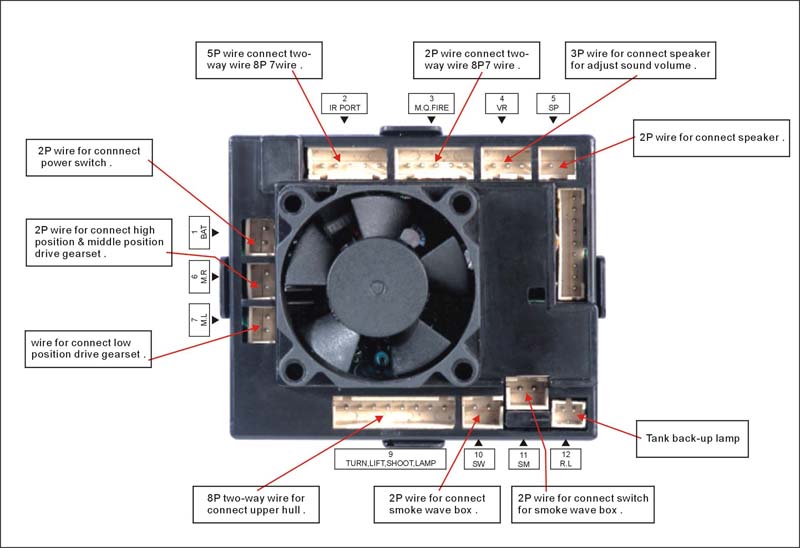

OH! And here I thought it was an RX18 all along! Geez!
Here's the cover:
I am now so confused.... So the 2.4Ghz board apparently is NOT an RX-18? Does this mean I can safely install a more powerful motor (in the future) and not risk burning the board? What exactly are the specs of these 2.4Ghz boards?

Re: How to install cooling fan for RX18?
Post by MichaelC »
the 2.4Ghz is the latest from HL, so if the latest revision of RX-18 doesn't seem to have a problem with over heating, then chances are the 2.4Ghz won't have that problem and you should be okay to upgrade to stronger motors, like the red ones I PM you from Tankarmy for example. I think their black ones are similar to 400s, and the Red ones are close to 480s.
The only real difference obvious is the radio frequency, but there are also couple of versions with different functions (smoke and volume) moved to be controlled by the radio. It looks like you have the earlier ones which is basically an RX-18 running on 2.4Ghz instead of the old RC crystal 27 Mhz.

While I won't be installing a fan anymore, just for future reference, where does one connect the fan to the powersupply? is there a need to solder a resistor or something?
MichaelC
Posts: 2449
Location: Toronto, Canada
Post by MichaelC »
Tomas,
On the Taigen 2.4Ghz MFU it is solder to the main power on the MB and not directly to the power supply/battery. I think these fans are usually 3v-5v so it would have to be step down somewhat and the MFU already have to do that for the LEDs/Motors.
You will need to find out where the main power contact is on the HL 2.4Ghz MB and solder it to there.
