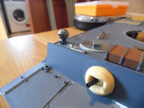

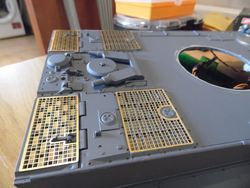

Latest 'bits' added between work, study and waiting for baby arrival!!
Gun mount supplied by very generous forum member :clap:
What next??
My first ever photo etch
Metal slit headlights
Forum member supplied gun mount

Love the photo etch looks really good

I agree about the "P E" very nice, For people who are new to fitting engine grilles to Tiger 1's the ABER Photo etch is the one to buy as the cheaper "Asiatam" now Taigen is oversized or at least that is what I have been told. :S I am watching this build with interest but knowing that builds never seem to end, Witness my Tigers, still work in progress and TFTM's Tiger and SOV'S Tiger we all will be well into pensionable age before we are done! and of course Painless with his revisiting of perfection, for goodness sake they are all outstanding so please leave them alone :haha: :haha: :haha: shaun

Thanks for comments gents, much appreciated.
The PE is the cheaper Taigen type, and I did have to file the edges down to fit.

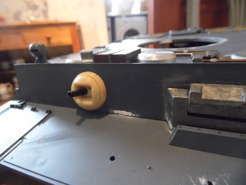

A few quick pics before back on shift tomorrow.

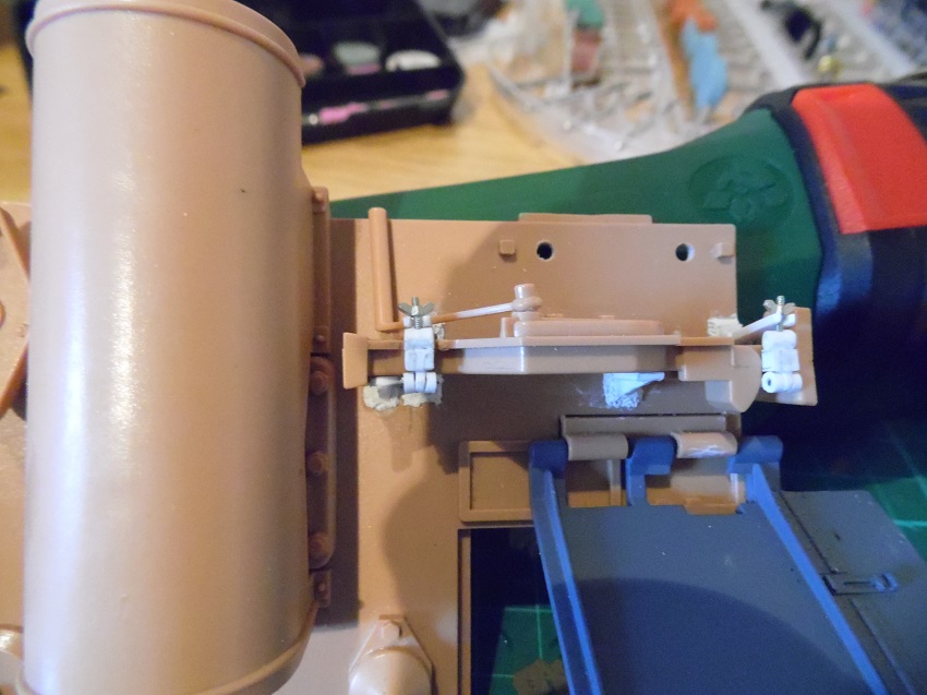

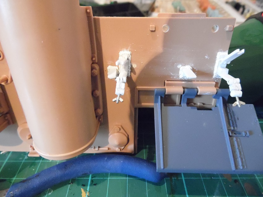

Pleased with these wing nuts from tank zone. Will add two to the side of MG mount also.
Waiting for scale antenna to arrive in post next :)
Thanks again for comments, its nice to know others are out there :wave:
Mark
And jack mount project complete.
Love this small detail added.
First order from TankZone and very quick delivery.

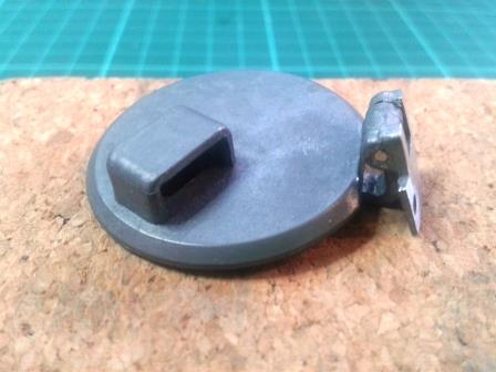

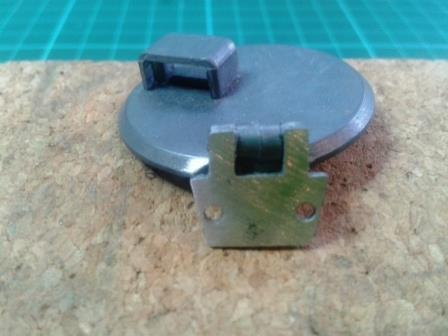

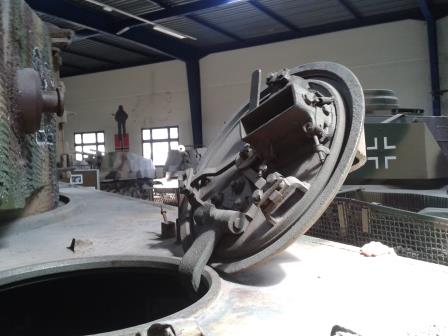

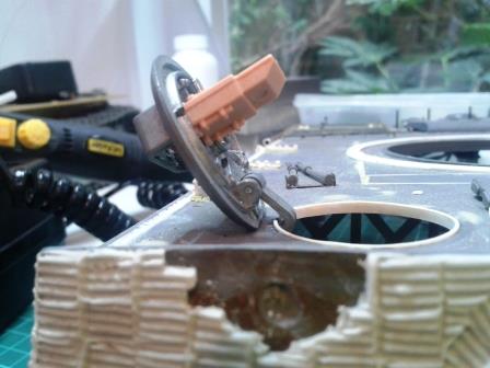

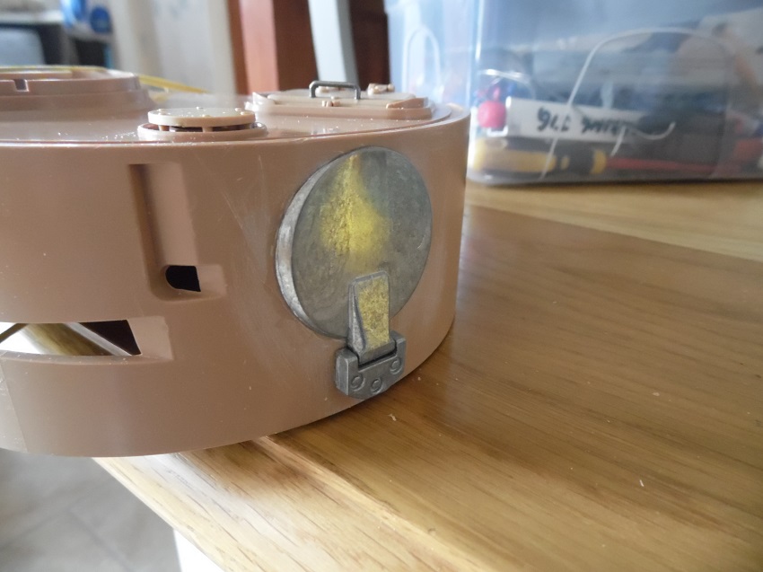

On the topic of the front hatches this took me a while to work out. The metal hatches fit very snuggly into the tabs underneath the hull but for some reason they don't open quite enough to swing past the vertical when open.
They should look like this:
Drivers's hatch on the Saumur Tiger 1 showing how it swings open past the vertical.jpg
Drivers's hatch on the Saumur Tiger 1 showing how it swings open past the vertical.jpg (31.17 KiB) Viewed 3644 times
I did cut out a notch in the lip of the hatch ring (not strictly accurate as you can see) but this didn't have the desired effect.
The simple answer turned out to be this: just sand down the mount so that it's about half the thickness and then fit it back in place. Since this means that the hatch is now raised up slightly it just allows it to open a little wider. This should keep it from moving about as well...
Taigen driver's hatch with the hinge mount sanded down to allow the hatch to pass the vertical when open.jpg
Taigen driver's hatch with the hinge mount sanded down to allow the hatch to pass the vertical when open.jpg (27.76 KiB) Viewed 3644 times
Here you can see the two holes which fit over the lugs on the underside of the upper hull.jpg
Here you can see the two holes which fit over the lugs on the underside of the upper hull.jpg (26.17 KiB) Viewed 3644 times
This is how it works once the modificiation is finished....jpg (29.7 KiB) Viewed 3644 times
Good luck!

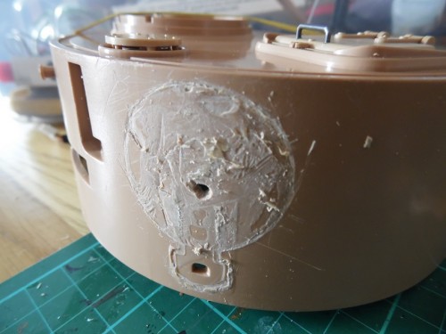

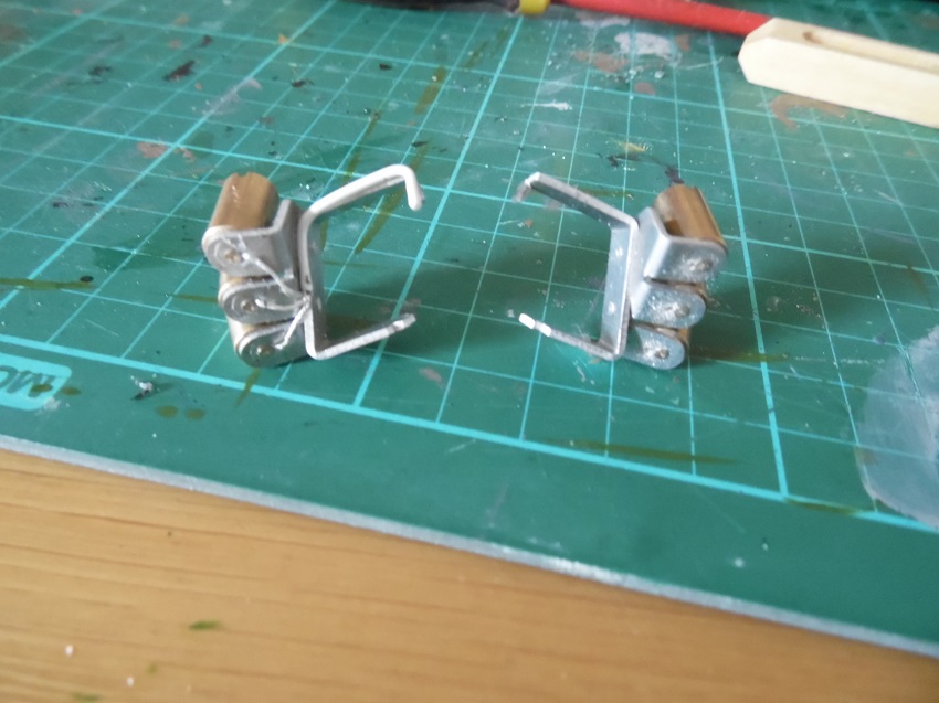

Latest small upgrades added.
The might not be perfect but happy with wiring smoke launchers.
I added a small bracket, from brass etch, to the cable on the turret.
Feels like closer to painting time :)
Smoke launchers wired up ready for fit.

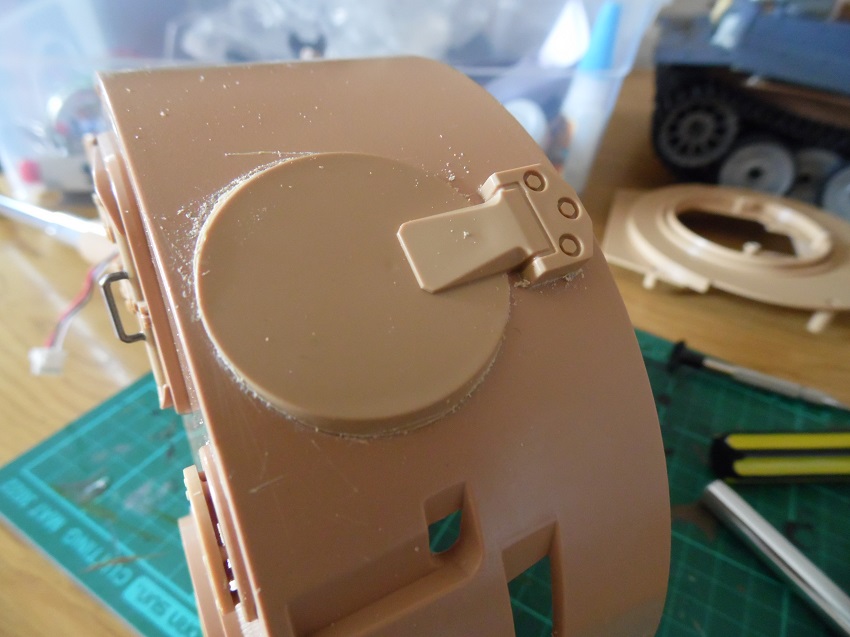

Emergency escape done.
Bit of cleaning up required
Starting to cut away old hatch
