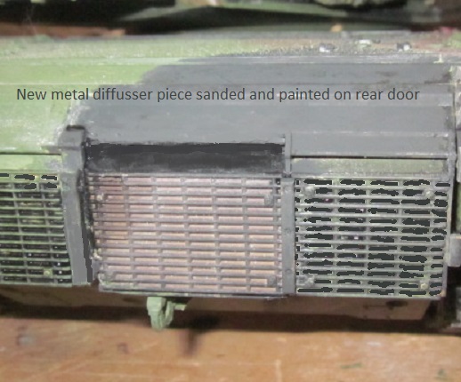

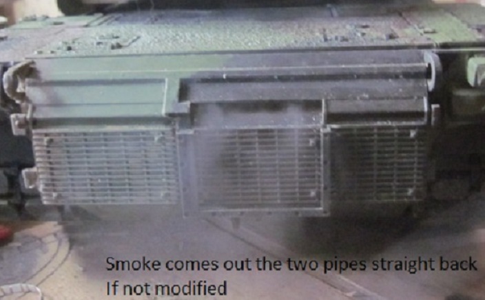

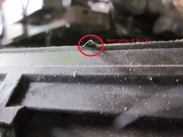

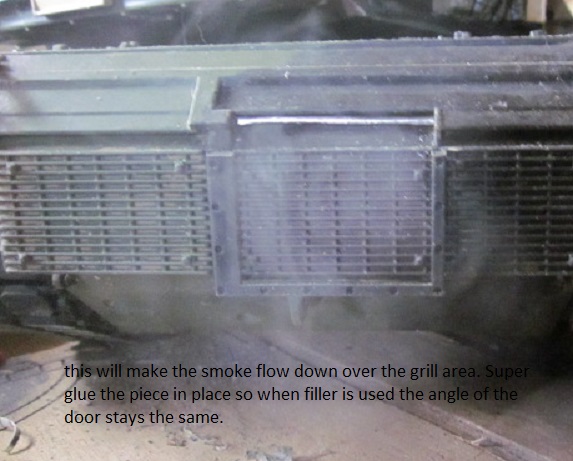

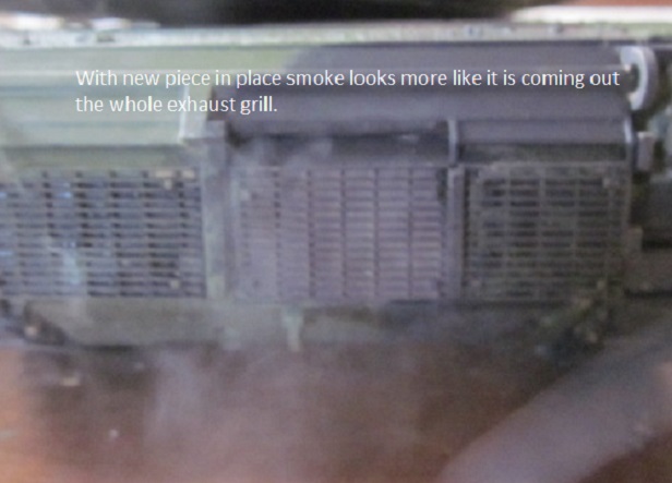

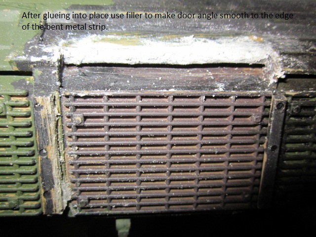

Finishing off lower hull by making tin diffuser so exhaust smoke appears to be coming more from the exhaust grill them just shooting straight out. Also did away with the to and bottom of the exhaust grill flange ( the on HL included is ment to be used to add a very large diffuser over the exhaust grill and I've only seen one or two pictures with the flange and only one with the actual large diffuser mounted ).
HL Abrams smoke diffuser tin angle 005.JPG (64.94 KiB) Viewed 7335 times
HL Abrams smoke diffuser tin angle 004.JPG (80 KiB) Viewed 7335 times
HL Abrams smoke diffuser tin angle 002.JPG (89.78 KiB) Viewed 7335 times
HL Abrams smoke diffusser tin angle 001.JPG (86.14 KiB) Viewed 7335 times
HL Abrams smoke diffuser original 001.JPG (80.64 KiB) Viewed 7335 times

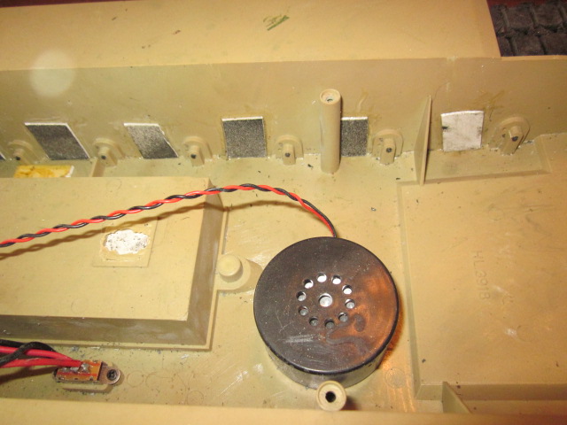

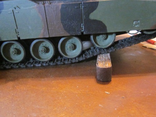

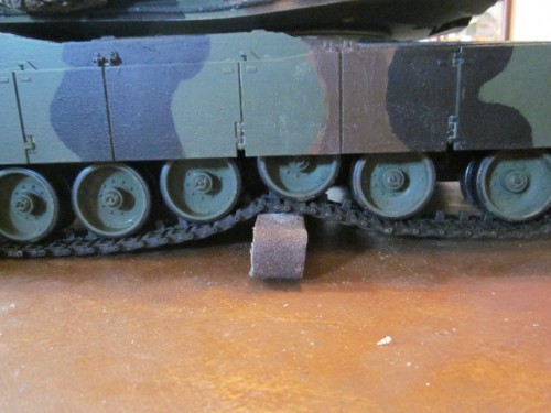

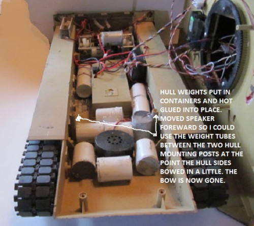

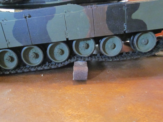

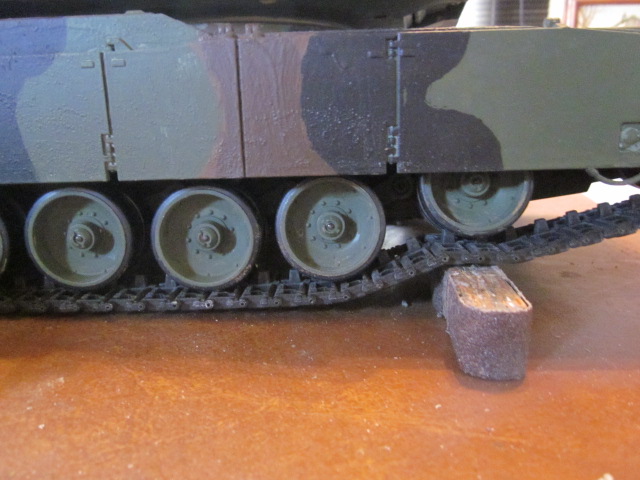

Got correct weight to make suspension use all the travel it has.
The first two pics are without the added weight the second two are with the weight installed ( weight equals about what 5 additional battery packs would weigh).

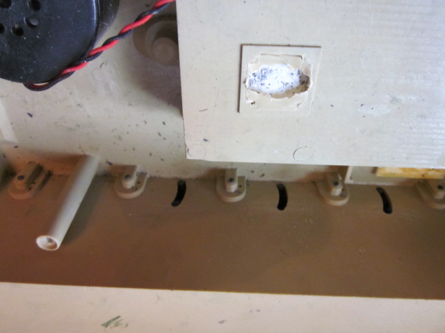

Added covers over slots that run through hull for road wheel arms to keep gunk out of hull. The right side pegs on the arms need to be sanded slightly as the very ends stuck out a tiny bit into the hull, the left side ones did not.
If you make these covers make sure you use a very thin amount of super glue and only on the very outside edges of the styrene squares or it may wick its way to the road wheel pegs sticking them in place.
HL hull gunk covers on inside of hull 003.JPG (97.66 KiB) Viewed 7329 times
HL inside hull road wheel arm slots through hull sides 001.JPG (84 KiB) Viewed 7329 times
HL hull wheel movement with the equivelent of about 5 battery packs added 003.JPG

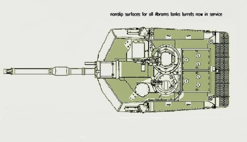

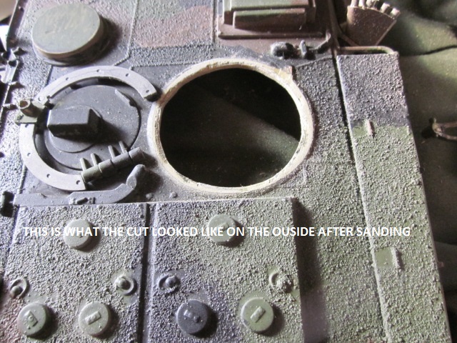

greengiant wrote:Received my HL Abrams a few days ago and have started to correct some things HL missed.
This first batch of pics are a way to get the nonslip surface on the tanks upper hull. All Abrams in service since the gulf war have this coating painted on.
I used sandbox sand that I sifted down as much as possible so I only had the smallest particles. It ended up a little thicker looking then I wanted but I think as I add more coats of paint that will diminish.
Tomorrow I will start to do the same thing to the turret.
Awesome " how to" I was wondering how to do this ...... 8)

Did you take any photos of the masking up of the turret prior to non slip addition????
greengiant
Posts: 1138
Re: HL Abrams detailing build
Post by greengiant »

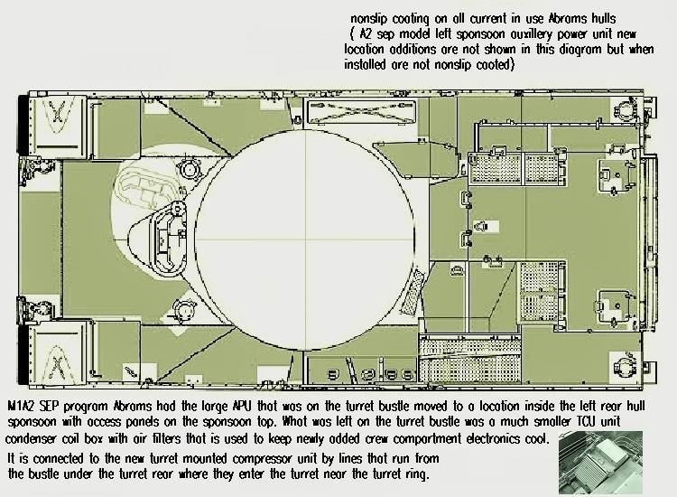

No I didn't. but these pics show were to mask both the hull and turret.

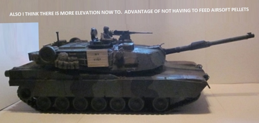

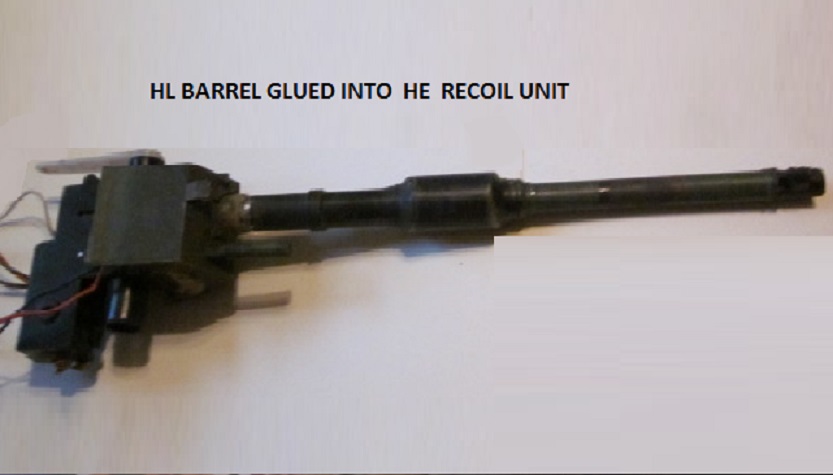

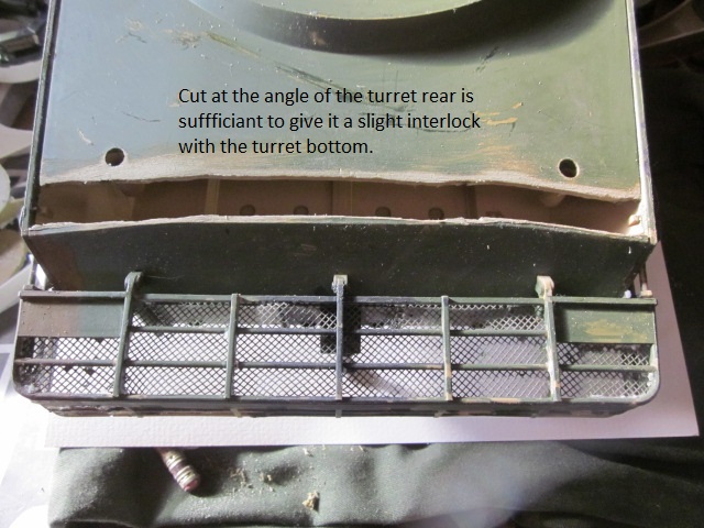

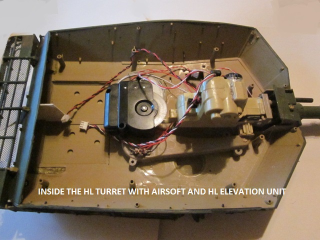

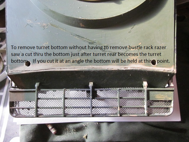

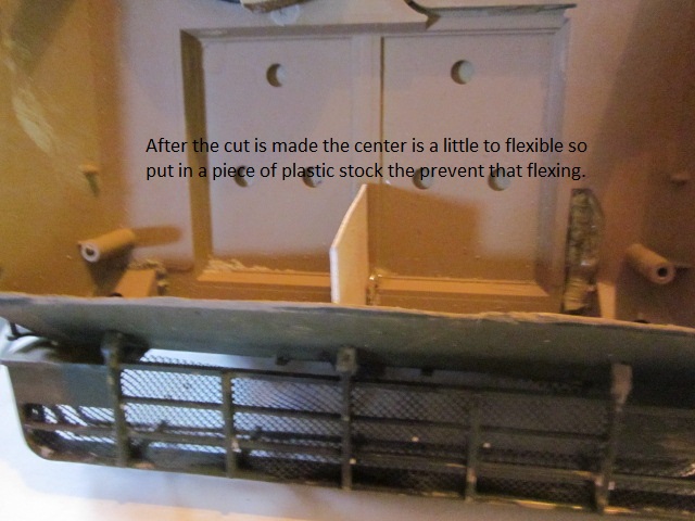

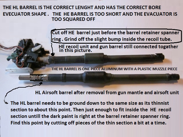

More pics of hull bottom inside.

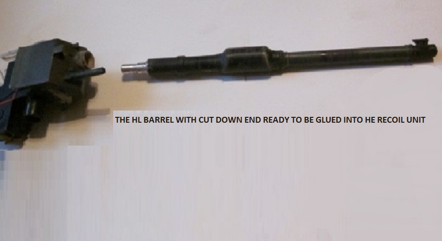

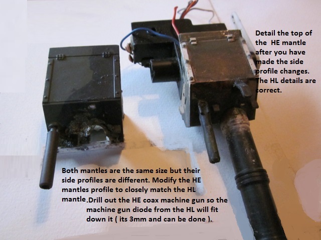

The start off work on turret interior change over to HE recoil and elevation units.
greengiant
Posts: 1138

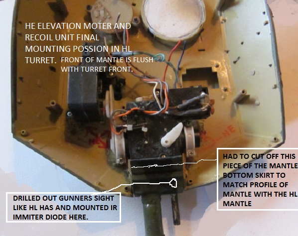

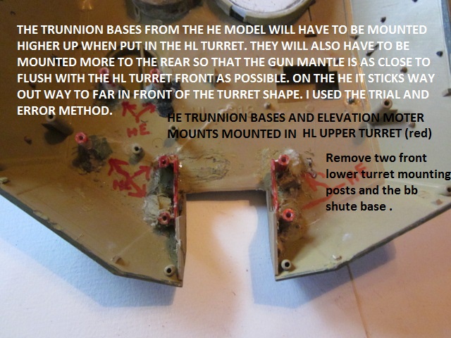

HE parts mounted in HL turret after much adjusting of location of HE trunions and the profile of the gun mantle.

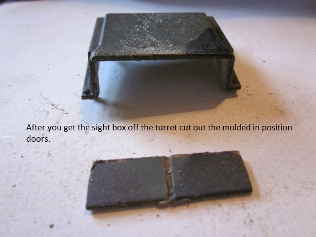

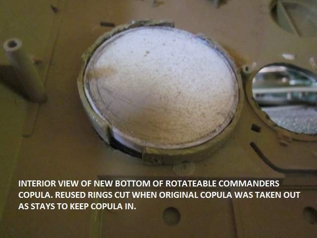

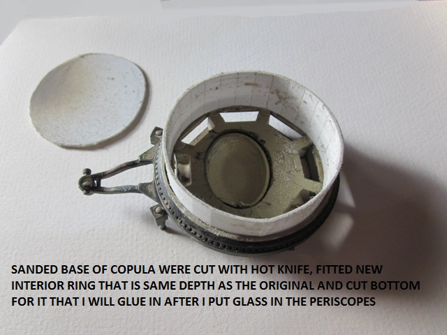

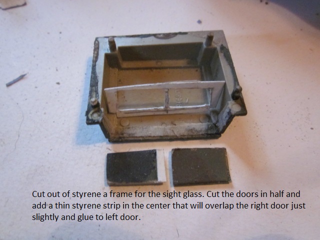

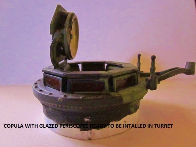

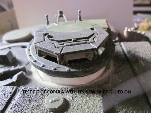

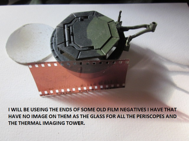

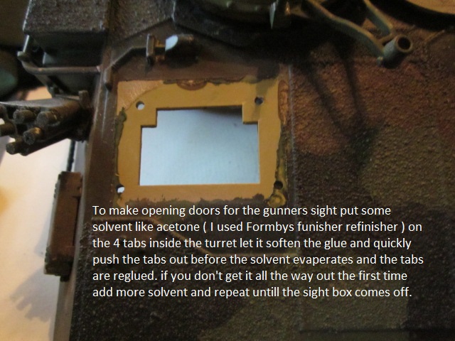

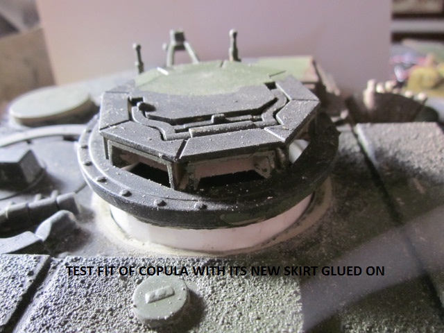

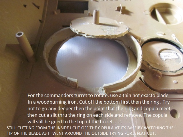

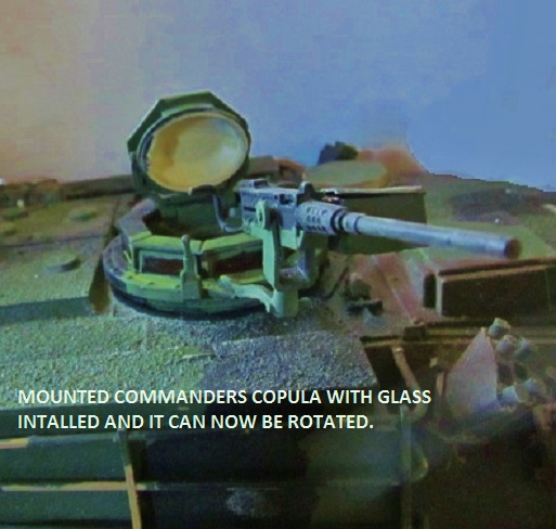

How to make the commanders copula movable and operating gunners sight doors .
The whole copula will rotate which I discovers is not correct for Any A2 Abrams since the copula is stationary and only the 50 cal gun mount ring rotates on the copula.
At the end of this build thread I will post new picture of how I corrected my mistake.
working gunners sight doors 2.JPG (79.94 KiB) Viewed 7266 times
The arms that go out to the 50 cal pintle must be slightly bent up at copula and down to level at pintle like the real one is

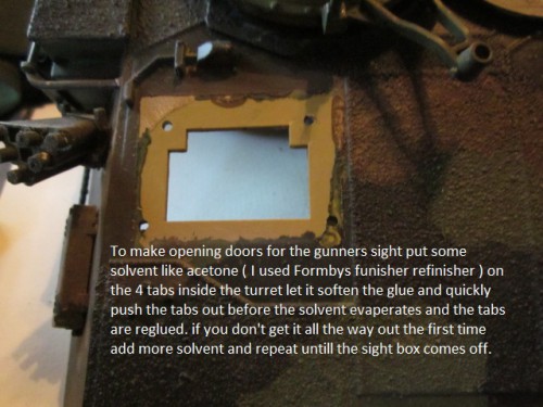

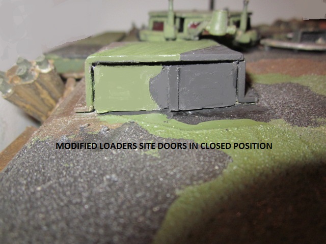

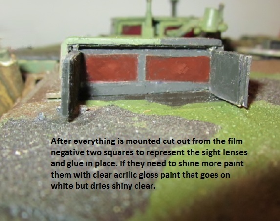

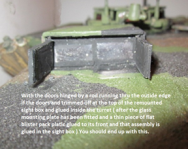

Finishing the gunners sight doors.

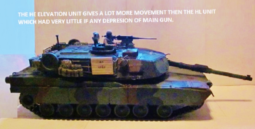

A quick look at the basic complete HL Abrams with HE recoil and elevation units.
working gunners sight doors 6.JPG (97.87 KiB) Viewed 7266 times
working gunners sight doors 3.JPG (89.25 KiB) Viewed 7266 times
AlwynTurner
Posts: 2656
Post by AlwynTurner »
Hi Greengiant some brilliant and innovative build tips there and especially like the tip on blank negative for red-tinted periscope, coming along really well. Following with great interest. :clap: :thumbup: Alwyn
