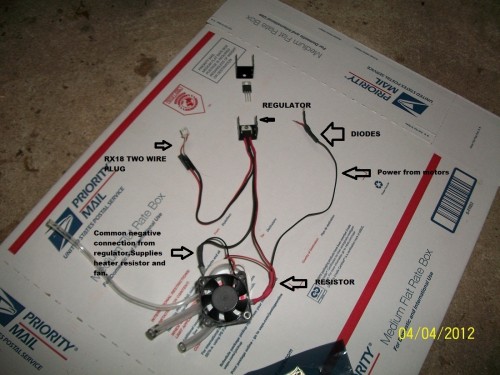

Super Smoker II Unit Description  ( Not the best picture but I have found the file and will sort through and present a series Wed, to allow tankers who have units to use the original wiring circuit and create a functional unit.

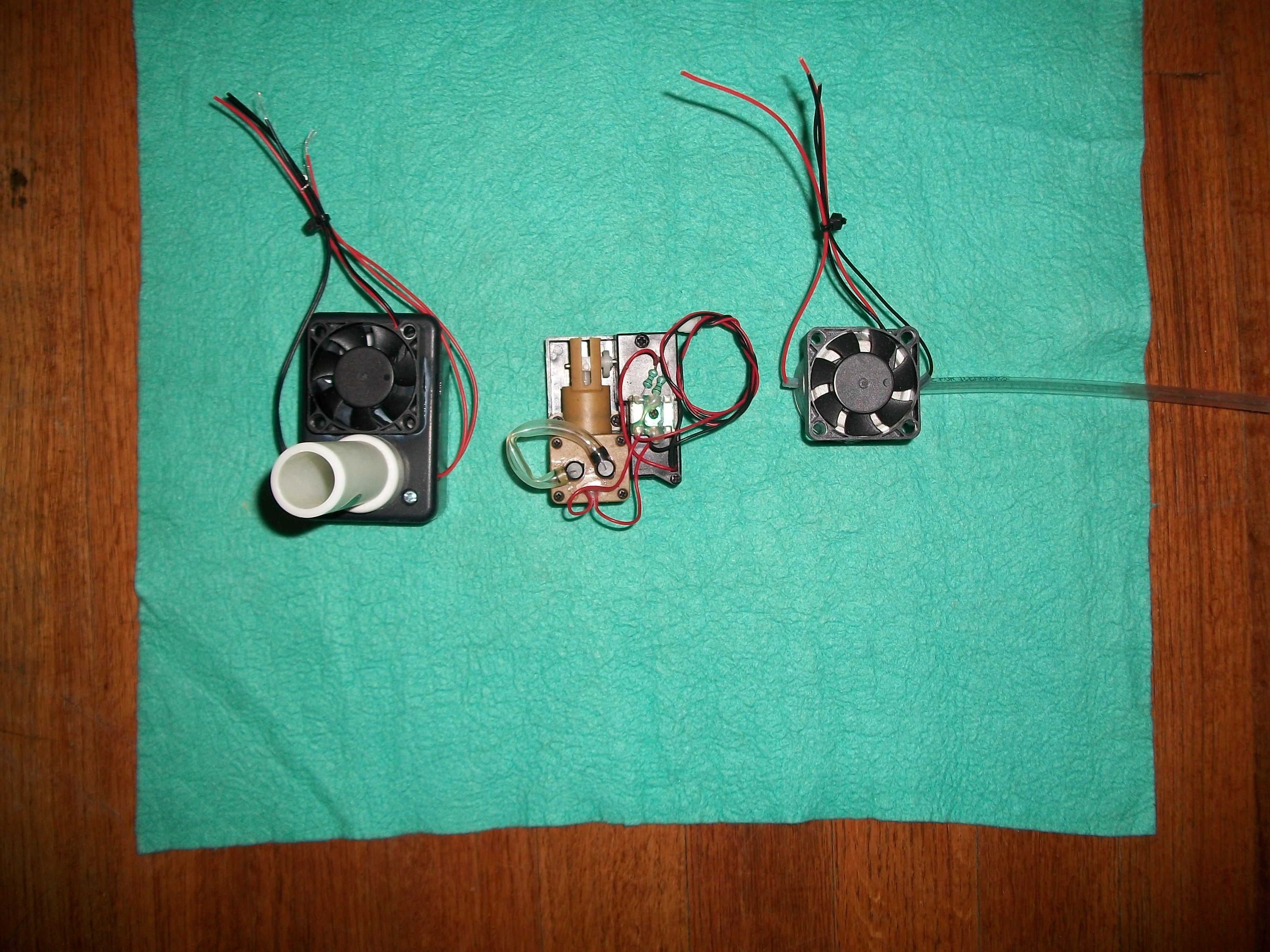

Original Super Smoker,HL SMOKER and SUPER SMOKER II sold by RC TANKWARS

I will return asap to post the original unit design specs. The unit does not require any link with the Control unit. The entire fan control circuit relies on the motor voltage to power the fan.
I will post asap guys, the circuit is simple and the parts are available online at Radio shack.
