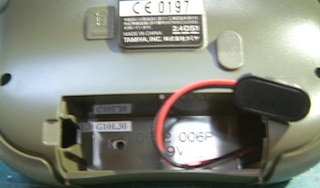

- many brands if you can afford eneloop pro are good
- DSCF0054.JPG (31.59 KiB) Viewed 4155 times

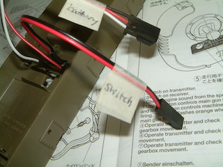

- test the Control Unit by adding batteries, note the position of red wires on the plugs

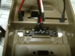

- with swich and battery wires in and battery box made up you can in effect test your 4 Motor Control Unit before going any further
- DSCF0055.JPG (31.89 KiB) Viewed 4155 times

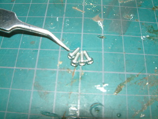

- watch out it's easy to get the wrong screws
- DSCF0047.JPG (28.36 KiB) Viewed 4155 times

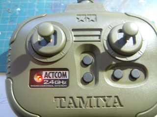

Thanks very much for the tip on boiling the old tracks. I'll have to give that a try. Running the older Tiger 1 is pretty much like the newer ones I would surmise. The controller looks somewhat similar but uses push toggles instead of joysticks and there is no elevation control.

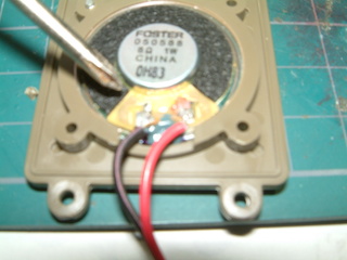

- Personal MOD, don't like orifices for dust etc. so added some clear tape as barrier (sound is little muffled) Tape is on the inside
- DSCF0035.JPG (34.78 KiB) Viewed 4147 times

It may be too late for this build but get yourself down to a Flea Market or electronics shop and pick up some old speaker covers. There is a wealth of the material designed to keep dust out of speakers on those. Cut to size and Bob's your Uncle. It won't muffle the sound like tape. Even nicely engineered stuff like Tamiya produces can benefit from an upgrade. This works well with any Hobby speaker like HL or Visaton as well.
