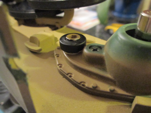

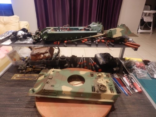

Here we go again, perfectly good Panther(!) now an entry of Panzer Wrecks ;) !!
Tore H/L the aerial mount out, removed the engine cover hooks, removed the spare antenna/cleaning rod tube from the side, got carried away with things in general :)
The sides will be clean of any accoutrements, like the real late Jagdpanthers.
Any necessary gadgets will be on the rear plate or engine deck as space allows, and track links will be on the turret.
As this is a late 'G' not an 'A' I reckon the similarities with the JP fleet will be acceptable.
Looking at the hatches for making workable, the rear deck hatch also has the bloody hull joining spigots moulded to the underside, so no point in making the hatch work-no gain really for me as against the hassle of repositioning the joining spigots to be effective.
The front ones though, they can be handy for lubricating the gear sets, so I might do those if I can get the right metal replacements.

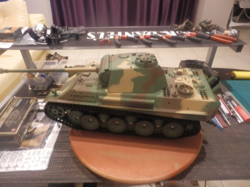

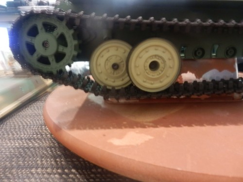

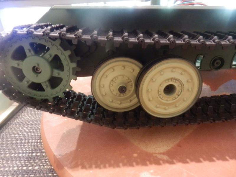

I had a bit of an experiment with the steel wheel conversion. Dragged out the boxes of plastic left overs.
Fitted the plastic King Tiger suspension arms to the Panther chassis & fitted a couple of KT wheels.
Now after placing the plastic track on the drive sprocket and over the idler, the track guide horns run in the centre of the 2 sets of fitted wheels. Now I get that the real ones ran in the middle of the track between the guide horns & the outers ran outside the guide horn, but as a quick go, this will work.
I want to use good quality steel wheels like the ones I fitted to my KT, and without 'hackin' them up, this way will look close enough & fairly straight forward to complete. IF I can separate them without hacking, the spacing shall be done.
The alternative is to space the lead wheel into the centre of the track guide horns, split the KT outer wheel sets, space the outer-out & the inner- in. This may indeed be "hack free" but at this stage I'm happy that Ive got TWO options.
The only thing is the KT wheels are smaller diameter than the H/L plastic Panther wheels.(yet to do the work out on this)
The track droops to much on the run up to the drive sprocket & catches on the moulded bump stop.
For the sake of progress this bump stop shall be sacrificial & covered by wheels & side skirts, so would not be missed.

Just a thought, the spacing on Tiger 1 late steel wheels might be closer. They would certainly look closer hub-wise anyway.

Don't forget your track slack roller that sits right behind the sprocket. That will stop your tracks from catching on the bump stop.

Brilliant thought that big guy, will look at that roller for sure. Really a puzzle as why the H/L panther wheels are quite a bit smaller than the KT ones :think:

Did some measuring & calcs.
The KT wheels are 2.5mm per side smaller that the Panther's in scale.
KT = 800mm
Panther = 880mm
Leaves 40mm divided by 16 = 2.5mm per side, smaller.Or, 80/16 = 5mm over all.
Which is about 1mm out on my wheels.
So, the roller you put on the drive assembly was supposed to stop the track 'bunching up' when reversing in real life, so it might not quite have the ability to feed the track up to the sprocket if I use these Tiger late type steel wheels.
Well worth the sussing out though. Either add a roller, or delete the bump stop :think:
