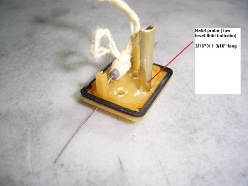

I tough you guys were using the refilling probe as a low level fluid indicator like I've been doing since I started modifying the H.L. smoker...
Whenever I see smoke coming out of the probe; I just add 3 ml. of fluid and I'm good for till the next time...

Strmnd54, that tube is a good idea! No smoke from it until the level drops and then smoke. Just not sure how to use it in the super smokers body. :think:
