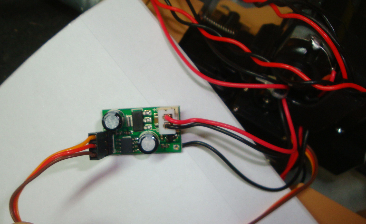

whether it is a Taigen system with the Asiatam canon recoil? there is no problem of adaptation, except maybe rewiring? for that it would take some photos of the existing one, to confirm (easier)
is this system?

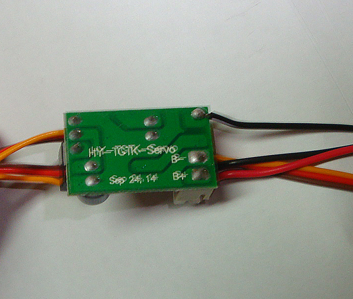

if I understand ? it is the Airsoft system with recoil of the barrel by servo? to operate with an RX 18 you need the following module, connected to the power supply, and take the most 5 volts on the small switch of the reversing system !!!
https://www.rctank.de/Taigen-platine-de ... l-Servo-BB
