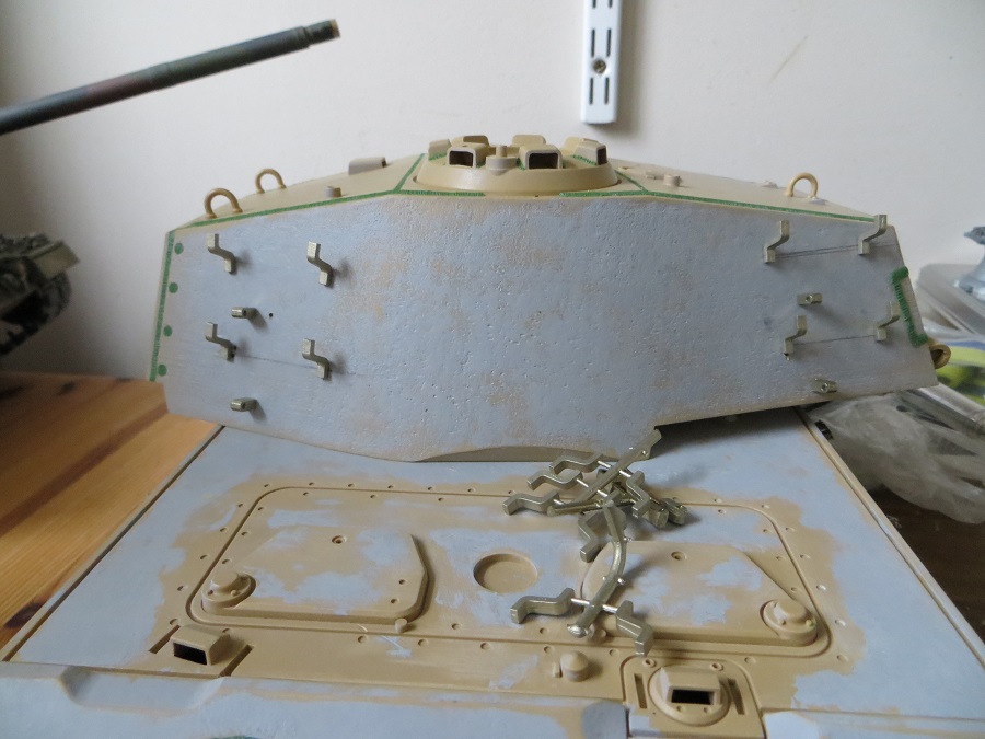

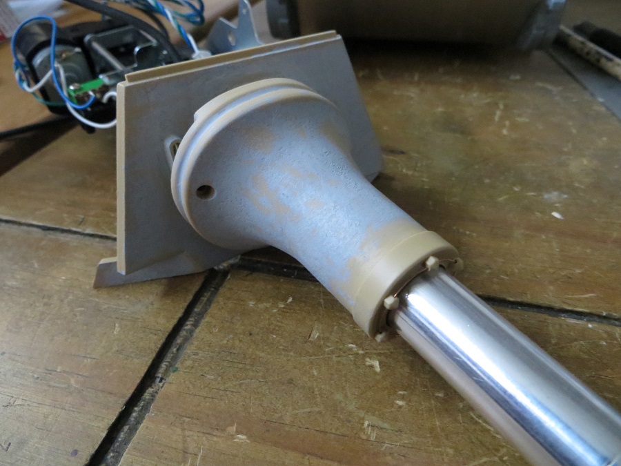

While I wait for the gearboxes I've been making the casting on the pig snout mantlet and added the wire to stop the bolts coming loose when the gun fires.
Interestingly I thought there were two versions of this mantlet. In fact there is only one version, the ones with the rings round them haven't been ground down in the factory.
The Shumo track holder set. Made some small errors drilling the holes for them and initially had the loop at the bottom the wrong side and had to do a couple again. Also finished off the welding. I made a mistake on my last KT by putting weld lines around the cupola, turns out it's actually bolted onto the top of the hull and not welded.

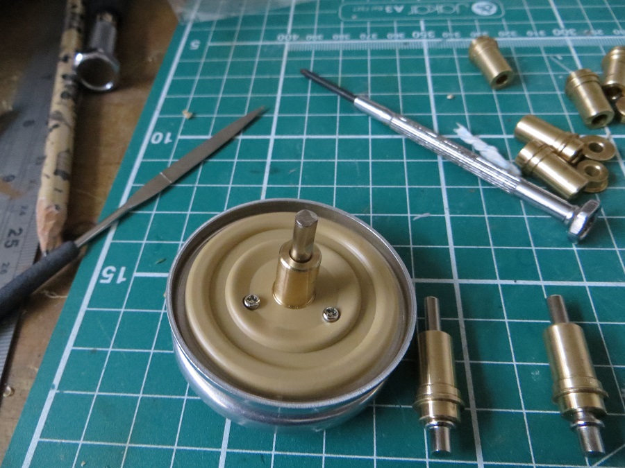

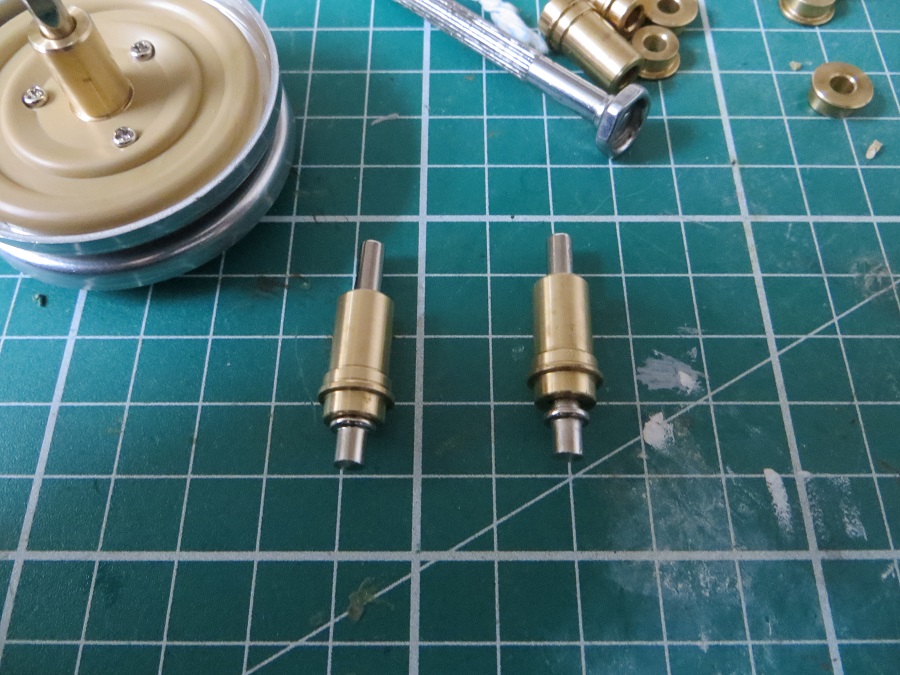

Since I had to buy new axles and bushings, I bought both the Impact bearing set and the Shumo bushings set. There is now a bearing at the front and a bushing at the back so there is almost no play in the wheels any more. Unfortunately there is a problem: the end of the bushings is too narrow to fit the axle properly. It's completely stiff! So the hole at the end on the wheel needs to be ground down a little both inside and the end. You can see the difference between the one that is ground and the one that is out of the bag and untouched.
Once altered a little, they look great and there is no play in the wheels any more and no chance of dirt getting into the housing, definitely worth the small cost and minor adjustment.

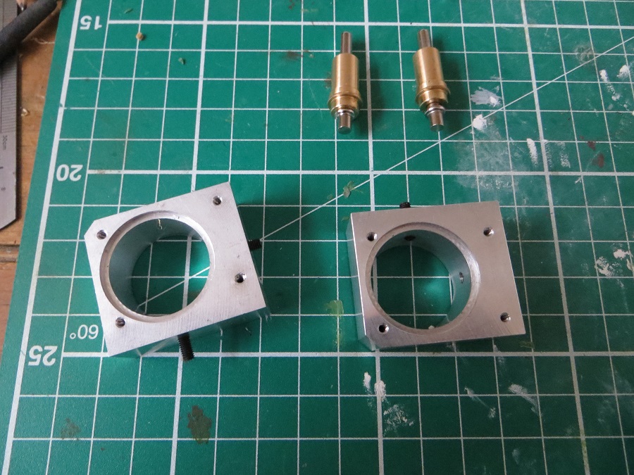

Lastly these are a waste of money.
The holes are no drilled in the right place - which I can live with but they don't actually fit the Shumo drums designed to go inside them. It's not even a tight fit, they need about 1.5mm take off the insides to fit them in. Not sure what i'll do with them, probably sell them with all the other left overs from this project, of which there are many.

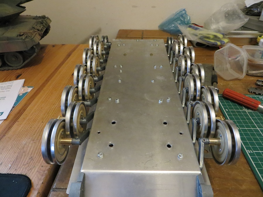

Perfect fit and alignment!

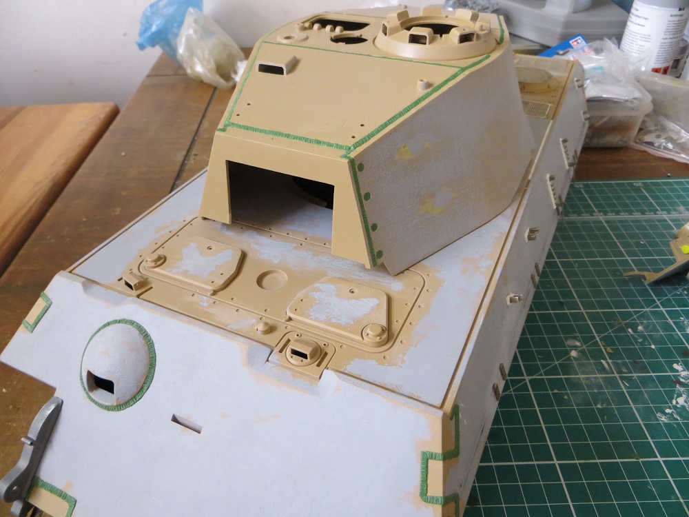

Once the dog has been walked and pub lunch has been consumed I'll finish off the external work on the turret. The PE will go on once its in a state where I'm no longer fileing, drilling and filling.
Taking a step back and adding up the costs, its coming to more than the brand new FO kit which can be bought for about £380. I could have bought cheaper gearboxes and settled for an RX18 but then it would defeat the point of having a tamiya. Even then when you add that the completed static wheels are not suitable, a completed static turret needs careful deconstruction, a new barrel or extension, the hull needs modifications as it doesn't have the underside to the sponsons etc. It all adds up to slightly eye watering amounts and a fair amount of cutting, filling and general work not needed on the FO version.
Maybe the newest static model is just the FO without electronics but I would be extremely wary about taking a partially finished static and making it battle ready which is the goal.
