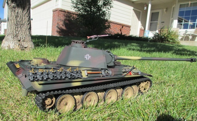

Mag,
She is a Beauty. Great job on the details! The new Panthers are some of the best tanks out there. Just charge the battery and Fun results. Here is mine from last Autumn. They really got it right with the Panther. Enjoy yours, Sir.

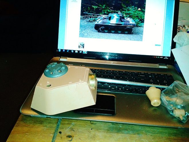

Sounds like a plan magman... the firing mech is going to be complicated though ...not much room in that turretmagman wrote:The new gen 2.4 set is out on ebay UK, you can buy the 2.4 set or separate 2.4 mfu and separate 2.4 handset.
I will post a few more photos of the Panther G soon .![]()
I will buy a separate 2.4 mfu, for my next project Panther F.
Re: My HL Panther G
Yeah I know.... several use Tamiya style works in them .... much smaller ...using servos... not really compatible with Heng Longmagman wrote:
Alpha, a few Panther Fs on this forum, I can always ask for help from the guys here.

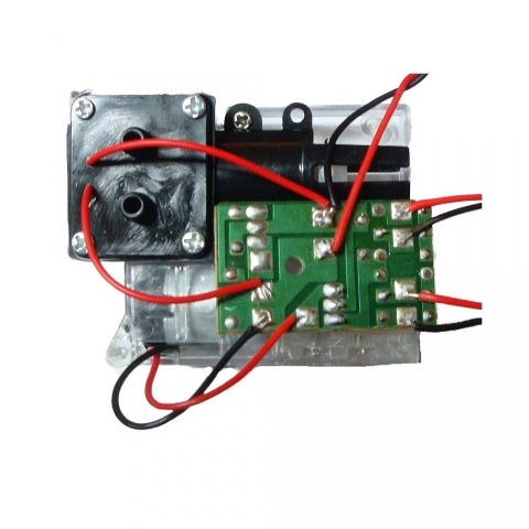

They do work... but yeah ...you don't get the same amount of smoke at idle like the standard ones ...you get more smoke as the power increases ....so at idle there is almost nonemagman wrote:So the HL proportional smoke unit arrived, what a load of rubbish.The smoke came out like a putt putt motor.
This is the new transparent plastic model,I have put the original unit back in.![]()
scalawag
Re: My HL Panther G
I too suspect that this is the proportional electronics rather than the smoker itself. I use the clear ones all the time and they produce plenty of smoke and are much less sensitive than the black ones.
As ALPHA says the problem is that the proportional unit reduces the power to the smoker at idle reducing the smoke generation and pump, so that you get very little smoke in slower puffs. As the speed increases the power to the smoker does too, increasing the smoke volume and pump. This however can be hard to see as the motion of the tank tends to disperse the smoke. The end result is a smoke unit which does what it is supposed to, but looks like it does not work as well.
Try the clear one out with the board from the non proportional unit, I think it will work better.
