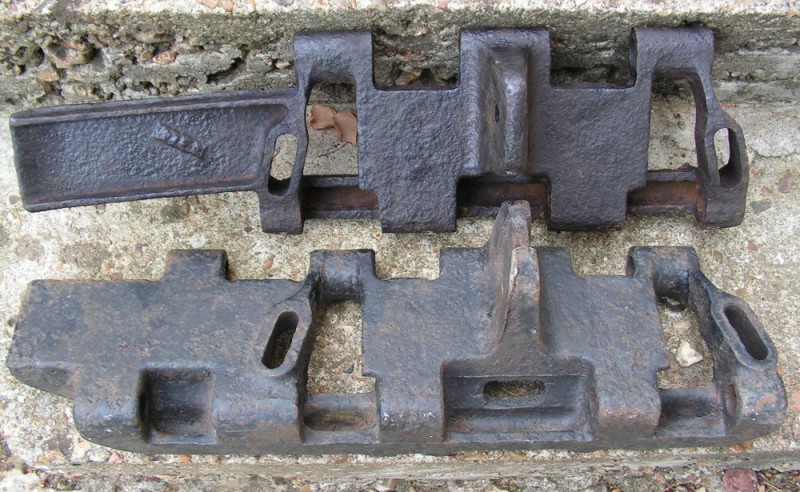

The real thing is about timing - again.
The winterketten was the first to be bought in for the III's and IV's during the winter of '42, Schurzen not being really in as far as side plates go until mid/late '43. Seems the winterketten was an expedient.
The Ostketten was issued after this and was designed to be an actual wider track that could last the rigours of heavy mud and the dry season with less failure rate. The Ost had bigger pins, and an extra hinge.
The Winterketten were basically a recast standard track with the outer blades which seemed to do well for lowering ground pressure in the snow, but could not cope with the duty of harder dry terrain(pleanty of pics with missing blades). Carting the other set of tracks around must have been a right pain in the ass logistics wise.
The Winterketten and Ostketten are almost the same width, so fitting either inside side armour can be done. Tight-yes, but can be done.
It seems that the picture of Tiger '100' with the schlepper with side armour was a double rarity. This picture would have been post white tiger subject picture, and by then the word has it that as a gun tank, the III was being phased out. So to have one as a schlepper, still with armour is quite a picture (wouldnt you put side armour on a StuG or gun tank ?). I would say that III's with turrets and winterketten did not then have schurzen side plates because they did not have schurzen side plates as common fixtures. In a matter of months though, that changed, winter went, and most were back on standard tracks with schurzen fitted en mass. This is supposition, but most of the info points to the poor old III's getting through to the point of being no good in a T34 fight & either being upgraded or converted in a quite truncated timeframe.
Track width wise - skirts & wide heals will fit
