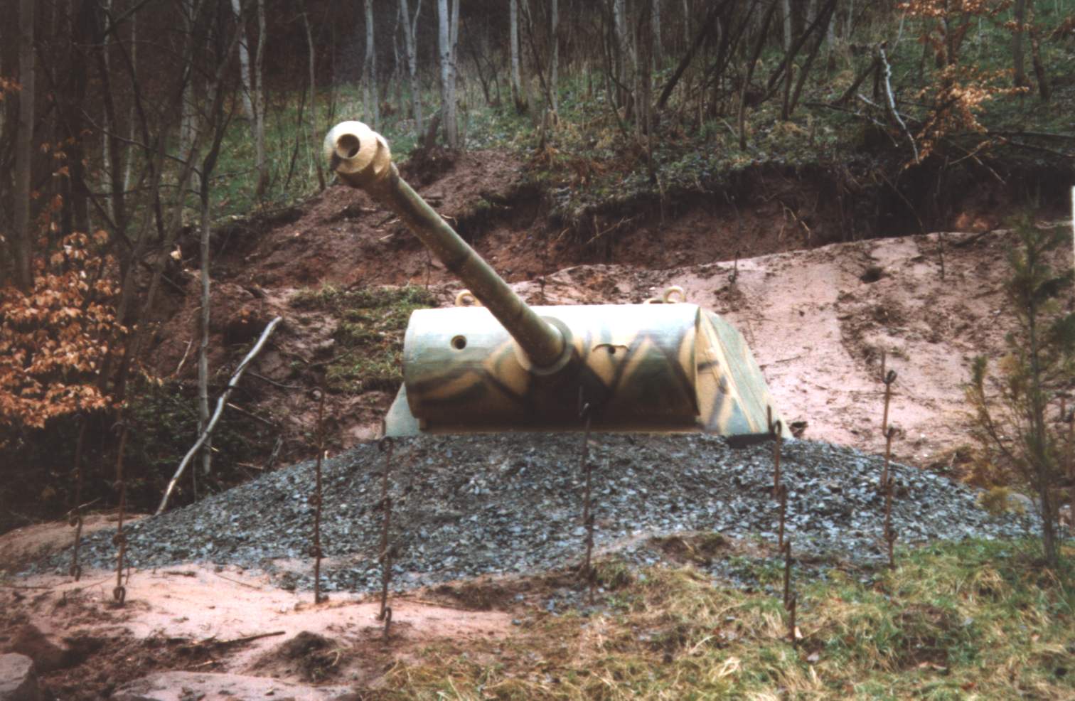

Post by ALPHA »
BOOK STUFF 4 LATE "A"
A PEEPING PANTHER
