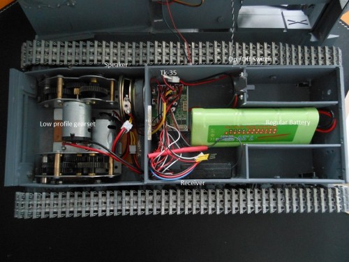

Re: Dicker Max
Posted: Fri Jul 04, 2014 12:58 am
by MichaelC
CHIEFSSON, I have a slightly more detail thread on the build on the local board:
http://can-amrctankclub.forumotion.ca/t ... -max#11121
But just to summarizes, I had started off with using the Clark Tk-22 with the new smaller battery that comes with the Taigen Stug III, but I couldn't get the battery as parts so I ended up with the Tk35, which is the latest Clark board for the 1/35 scale. The major difference is that Tk-35 is only 7A and not the 20A like the Tk-20s, and smoker function is disabled. When I first hook up the Tk-22 the gears and motors were too fast and not to scale speed, but with the Tk-35 it feels and moves right, but I don't know if there will be enough torque. Having said that this is not meant to be a hardcore battler so as long as it moves reasonable well I am happy. Here is the interior picture of the lower hull:
As you can see, I had hope that the small battery would fit between the two hull cavity but since I couldn't get them I have to use a regular one and lean it up against the side to make it fit, and it intrudes into the main area. I have to also remove the speaker from its housing to make it fit where it is, as you know the front hull slopes quite a bit down to meet the lower hull. The receiver is a Turnigy one so it is quite huge, and I could have fit it into the bulkhead next to the speaker, but since I ended up with a Tk-35 there is now more room in the main space.
Tk-35 size solves most of the problem and I could have also use a smaller receiver as well if needed (Like a HobbyKing one for my Turnigy radio) but it creates other problem. The board is small which means all the plugs are the extra small ones (like the flash and IR plug on the Tk-22). I initially even have reservation about the voltage it would carry since Clark gives you all the connectors to the new board but they are all gauge 24/26 wires including the power feed and the motor feeds. In order to keep things transferable with my other Tk-22 boards, instead of soldering new plugs into the power/motor/MG/Light feed, I solder male JST plugs on the other end so that everything can be moved between Tk-22s and the one Tk-35:
What you see here is actually the CN2 connector but it is splitted into two on the Tk-35, 3 pin one for the battle unit, and two for the programming/hit LED. Basically I did this for all the connectors I needed on the Tk-35.
Lastly, I didn't bother with elevation or rotation, but they would have to be hidden in the upper hull as there is absolutely no room on the lower. I put the recoil servo directly under the breech block as you can see in the picture.
Hope this helps, let me know if there is something specific and I will take more pictures.
MichaelC.
Re: Dicker Max
Posted: Fri Jul 04, 2014 3:14 am
by ALPHA
Hello micheal... just wondering (after reading your last post) why don't you use a lipo in this? I have a 7.4 that is waffer thin..not even a half inch when stacked...and maybe only 3.5 inches in length...it would fit easily in that space you have
Re: Dicker Max
Posted: Fri Jul 04, 2014 3:28 am
by MichaelC
ALPHA,
I have considered using different kind of batteries (like Lipo) that are of smaller form factors, but the cost of the new battery/charger etc would have been more than the Tk35 itself which I got for $80 Cdn. That's really the only reason. Just didn't want to get into a new and different battery setup just for this baby. Besides, one can always use an extra Clark board........
Michael.
Re: Dicker Max
Posted: Fri Jul 04, 2014 3:47 am
by ALPHA
MichaelC wrote:ALPHA,
Michael.
Ah... that's a good sensible reason... that waffer LIPO was about 30 US... and the charger about the same...I don't use the fancy one..it's prone to starting fires... the simple balance charger works perfectly... seen them on EBAY running around 4.00 to 25 US
they look like this
http://www.evike.com/products/41649/
I got mine locally here in Hawaii... so I paid retail...if you have any airsoft shops were you are you might be able to locate the battery for a better price... I call them waffer ...but the real term is "two leaf" they are very thin... not very good for airsoft don't ask me why they market them in that category... because I've found them way more useful in RC tanks
here's what those look like
this is an online airsoft shop...pretty good ... you're in Canada? ...they should be able to help if you ever decide to go in this direction
http://www.evike.com/products/38231/
mine is a 1200 mah... relatively low in comparison to normal batteries... but it packs a punch....lasts for hours once fully charged...in something like this tank probably longer ... I haven't charged mine in weeks...and yet I can still run my Panzer IV :haha: (let's just say I push the edge lol )
It might be something to consider down the road ;)
Have a good one Micheal Image
