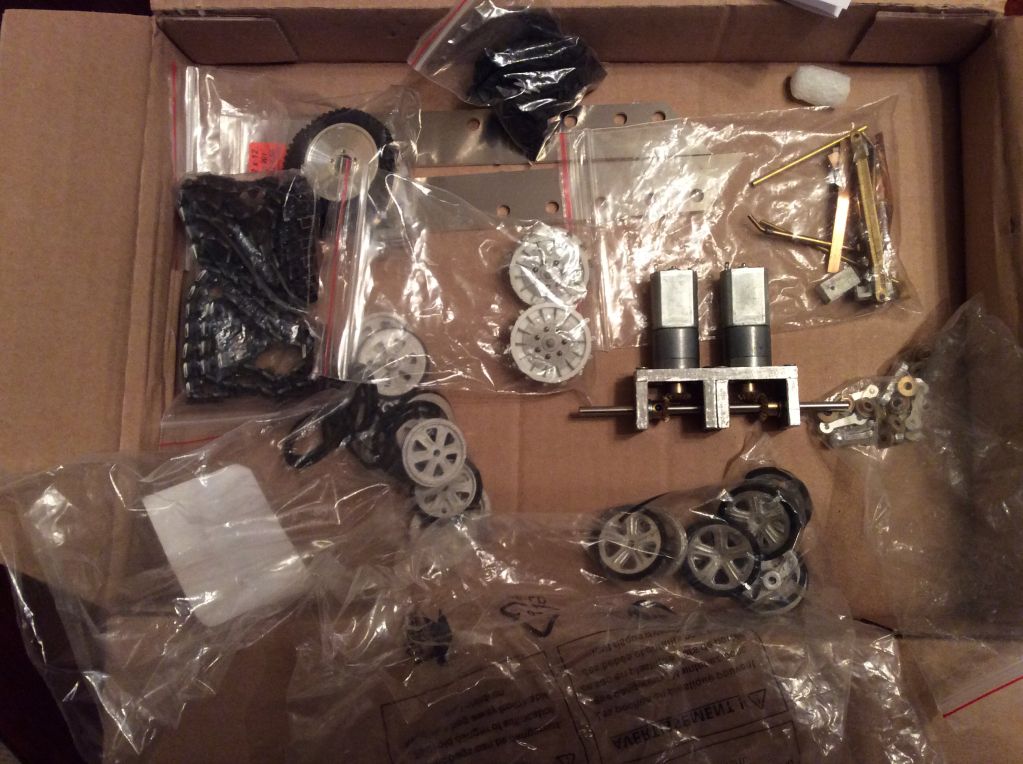

A nice parcel turned up from Christian Ludwig this morningImage beautiful parts can't wait to play with them.
Looking forward to some modling time bought the transminter and receiver a couple of weeks back got a plant 5 got to start looking at control boards next
Will keep you posted

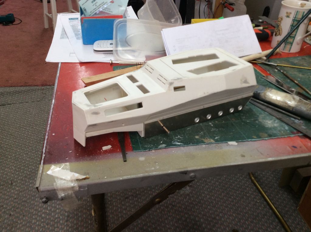

Hi everyone

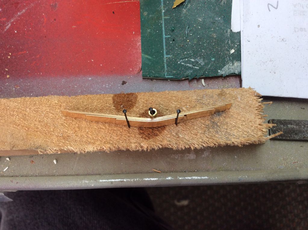

Started on the front axle today and also installing the gear boxesImage
Axle coming together I made a mistake I did not get the centre pivot dead centre so will have anther go in the week photo to follow
Most of the joints have been filled on the body gear box in place and aluminium chassis sides ready to be fitted
Tony

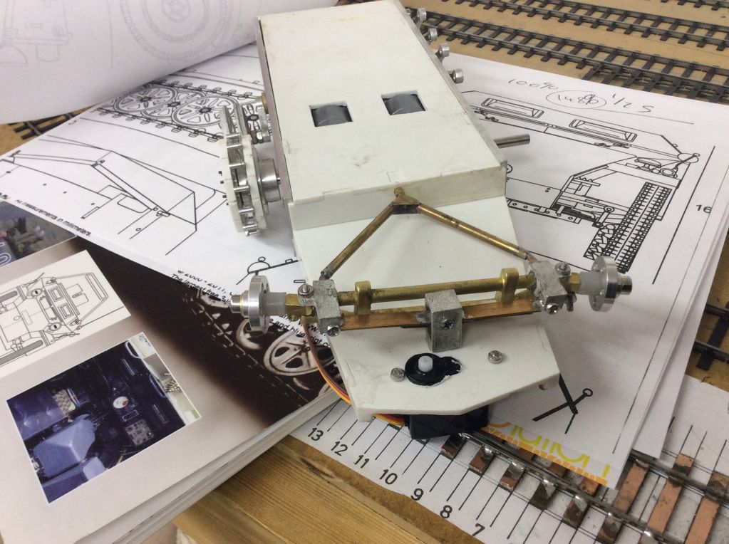

hi all

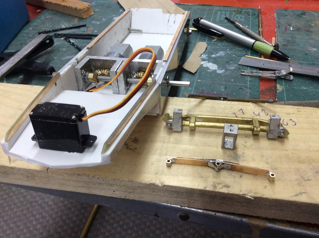

here is some more photos managed to get down the shed for a few hours .
i made a mistake on the front spring that has now been corrected ( did not center the pivot)
servo is installed got to make a bracket up for the other pivet point
will keep you updated

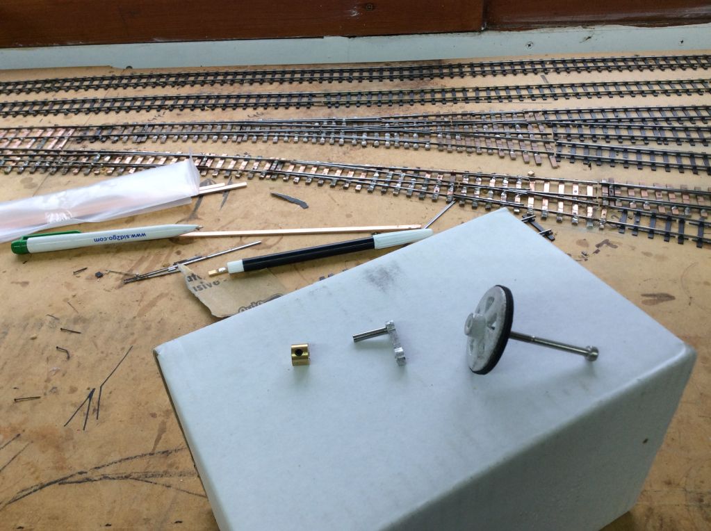

Busy day down the shed been working on the swing arms .
Christian supplies the arm in white metal you then have to tape them for a m3 thread and bolt .
Taping the swing arms
Swing arm with shaft attached that will go into chassis m3 socket head bolt was used then cut to size like one in bottom of photo the brass retainer you see will go on the inside of the chassis and hold the swing arm in place there will be some piano wire connect to the brass retainer to form the suspension .
Swing arm with wheel giving you a idea how it all goes together

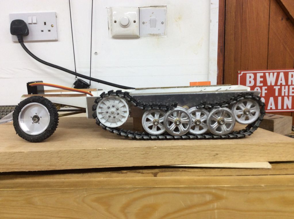

Hi
Well am getting on with the project got all the wheels in place and found tracks did not meet sent email to christian and he told me what the problem was and sent me some extra track links free of charge Image

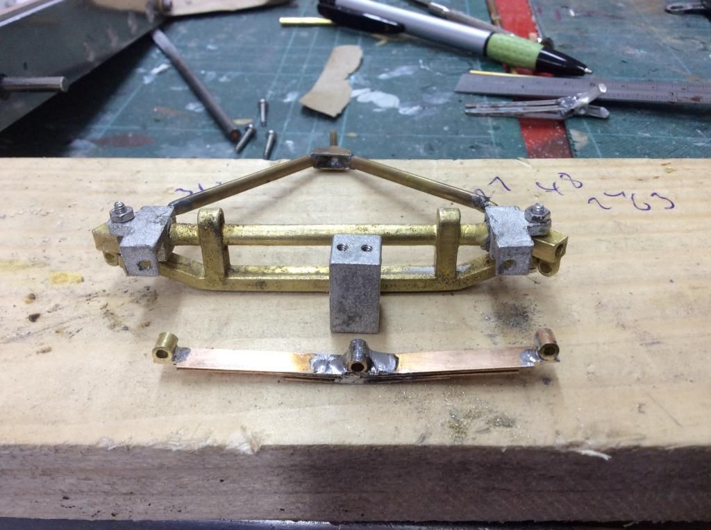

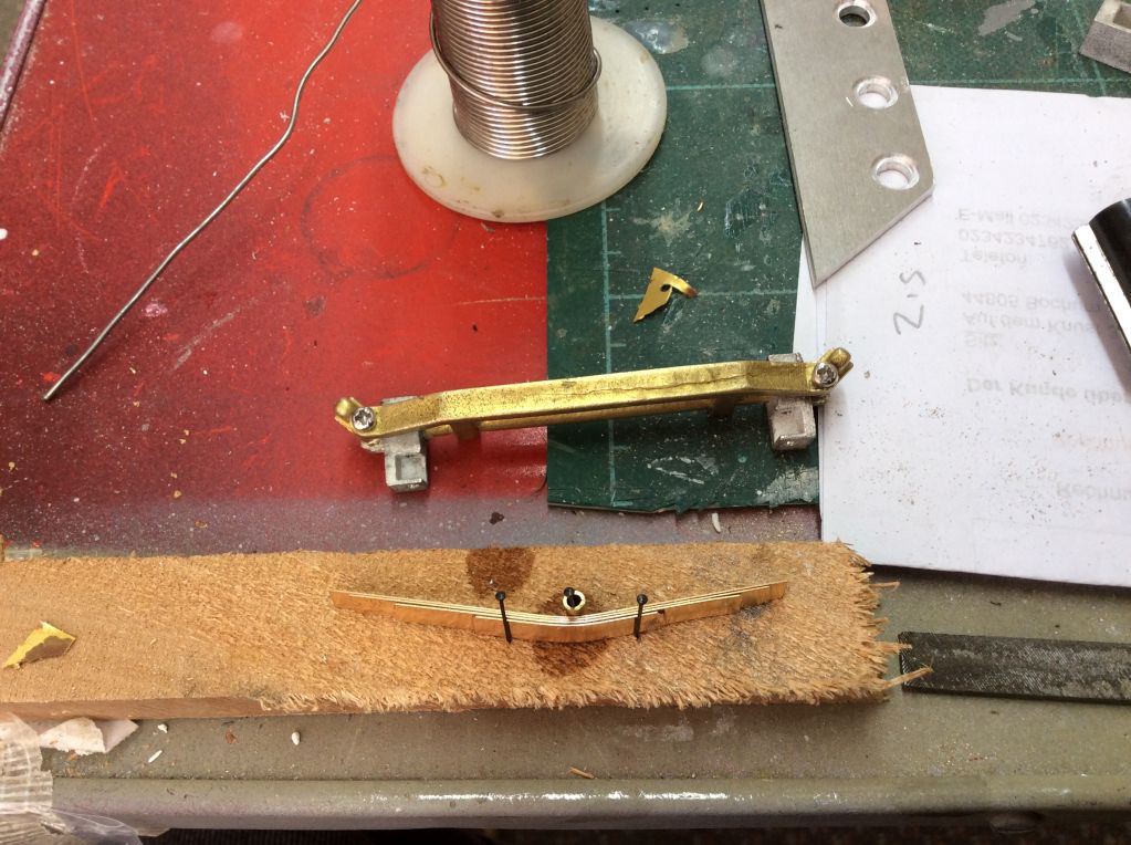

Have also been working on the front stering had to make some spacer on the lathe out of nylon to put the front wheels at the right distance apartImage

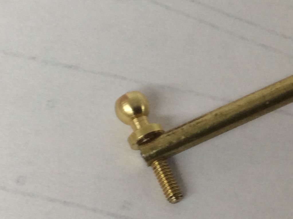

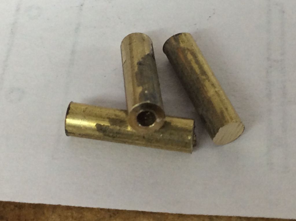

Just started to make the track rod ends drilled the end of some brass rod to take m2 rod I will hopefully tomorrow drill a vertical hole to take either m2 or 8 ba boltsImage
ImageTest for track rod ends

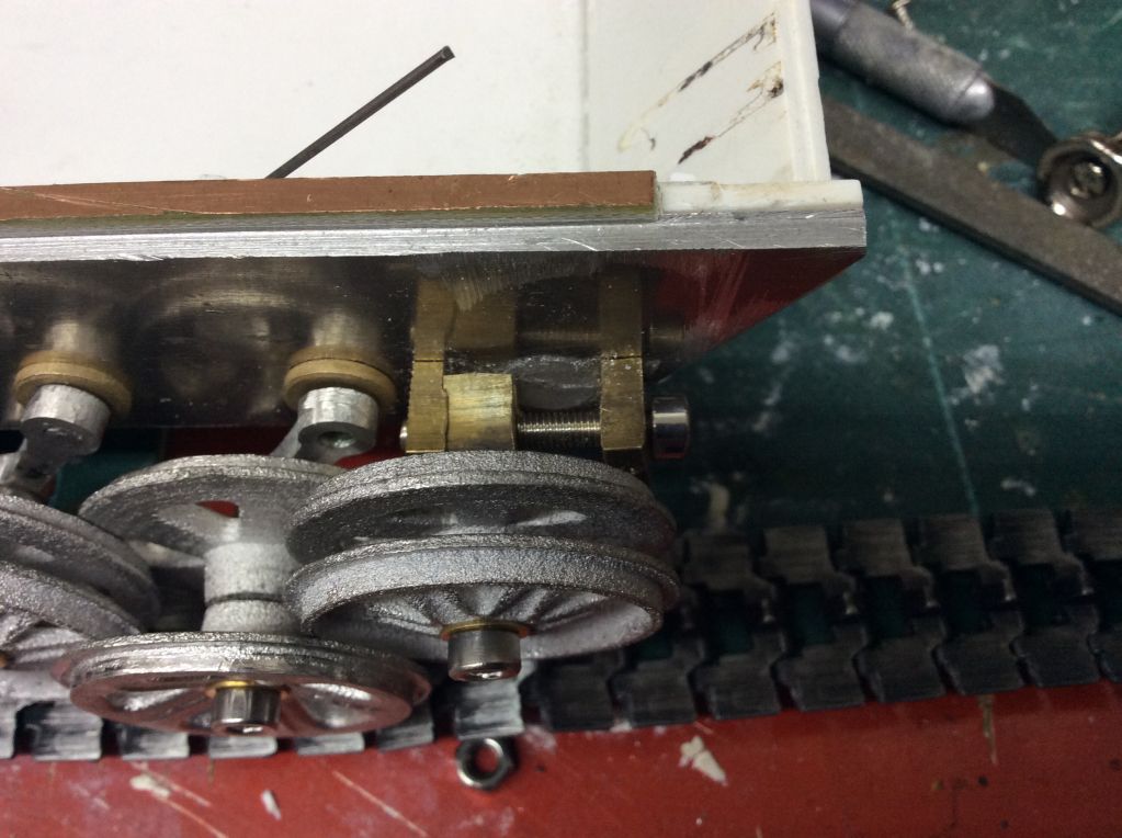

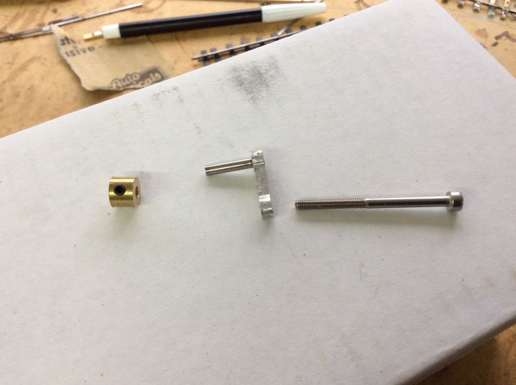

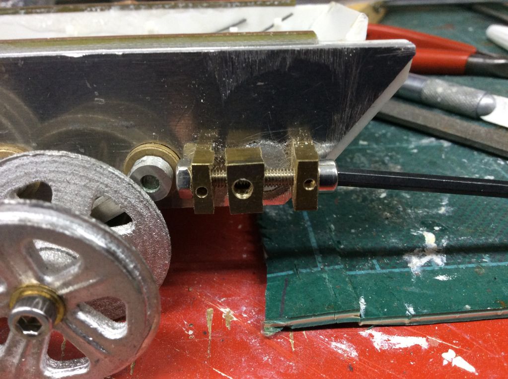

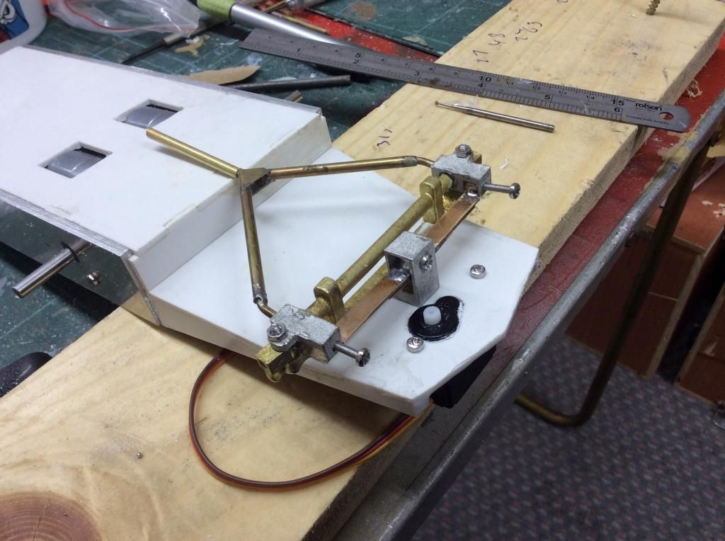

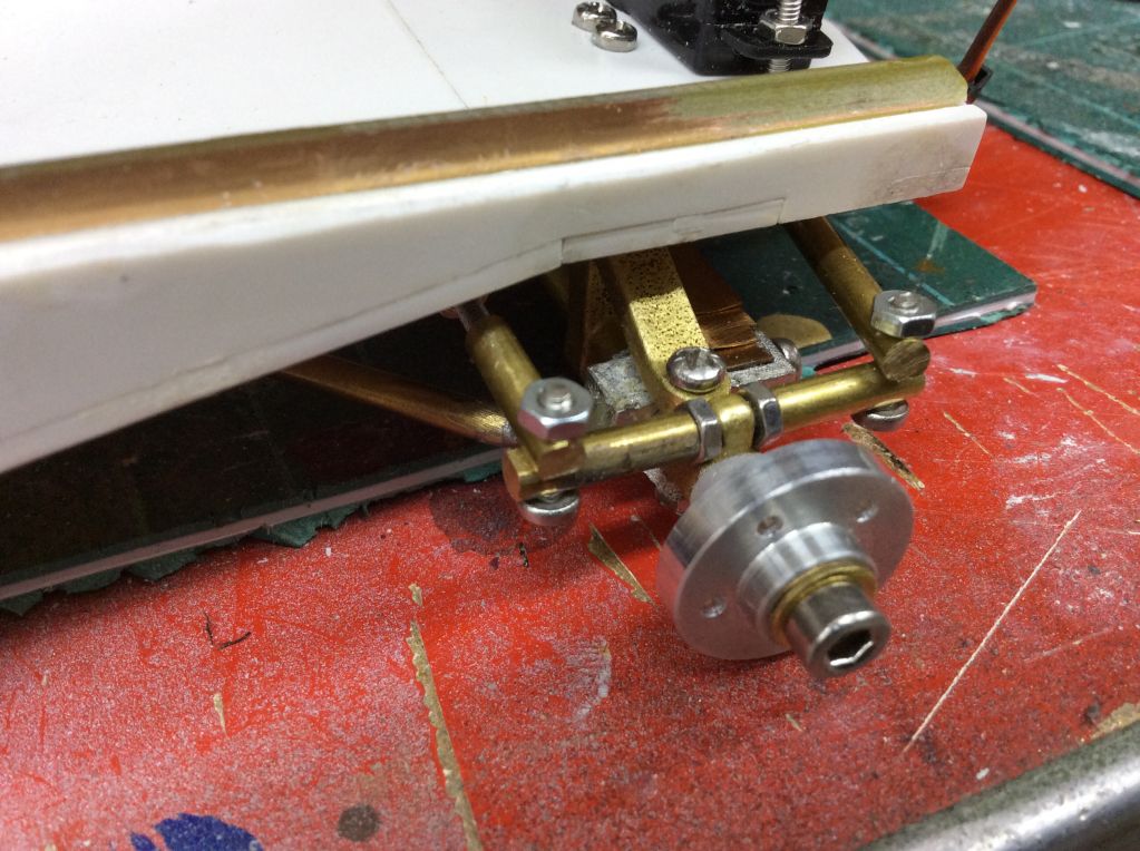

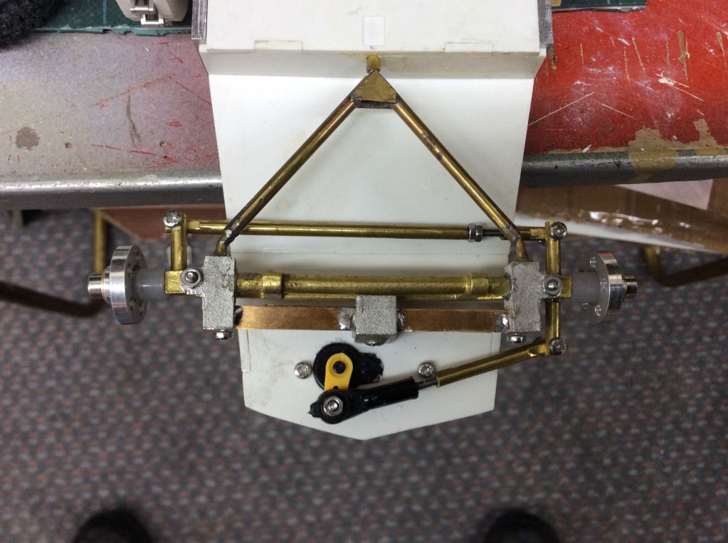

Front axle coming on change my mind on how to do the track rod endsImage
Over view of front axleImagefront steering track rod ends ect
ImageTrack adjuster need to modifi slightly idea welcome
Let me know what you think

hi
i like it, a very good example for a track adjuster :-)
cu christian

Posts: 7633
Re: christin ludwigs SD.KFZ 250 my new project
Daktari,
That is some solid and ingenious work!
