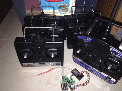

For some of us who have kids that use theses tanks, the Clark isn't intuitive for them (at least mine). Had a Pershing with a Clark TK22 they hated it. I understand most of you have many tanks and use a single radio with custom profiles to control all of them. We need 4-5 separate radios, this was the happiest for all route.
If we go IR battling we'll go the MAKO2, Hammerhead II and REMORA wireless to MANTA LCD's on each controller.
Soon to be on ebay (HL PCB's not shown):

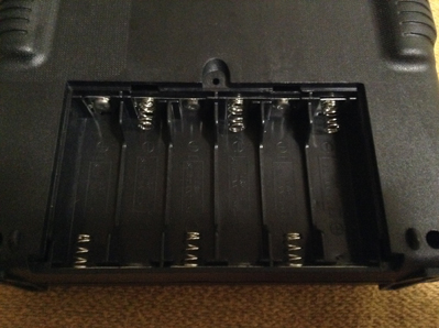

FYI battery compartment on Taigen Tx:
photo 1S.jpg (91.89 KiB) Viewed 1862 times
