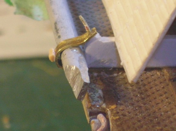

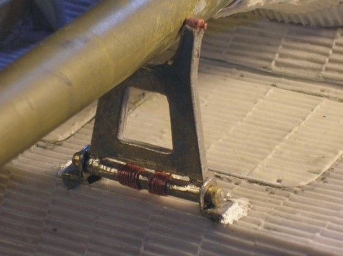

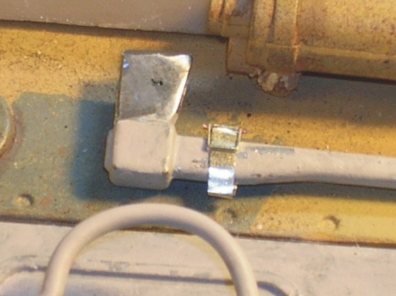

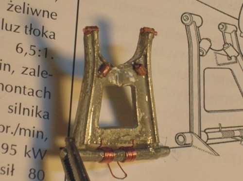

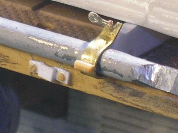

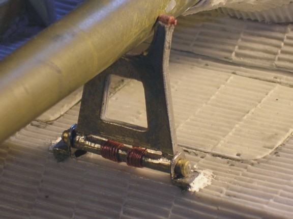

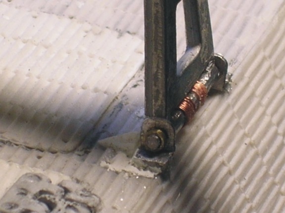

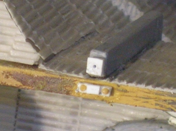

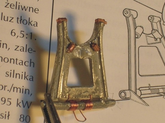

The next set of pictures is the detailing of the barrel travel lock. The stock metal one that comes with the kit looks pretty good but because it is so dominant when you look at the front of the tank I decided to dress it up a little to look more like the real one. Took the pic out of my Polish L70 reference book and added the copper/styrene and brass pieces you see here. The lock is fully operational as you can see and does help to steady the barrel when I transport it around just like it should! :D

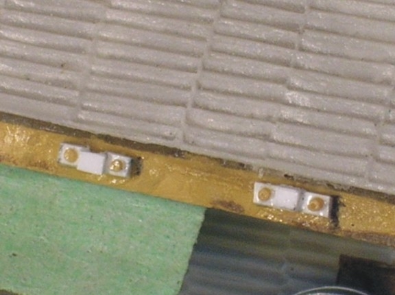

Also since I went to all the trouble of doing the zim on the lower hull I didn't want to cover it up by putting the side skirts on so I went with scratch building the small side mounts on the hull. The details I got from a great site for reference on most common tanks:
http://www.primeportal.net/tanks/dmitry ... anther_iv/
I know this is a later model but from what I can see the skirt mounting system was universal to the models.

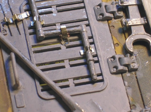

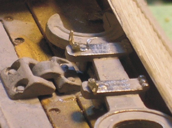

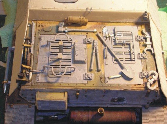

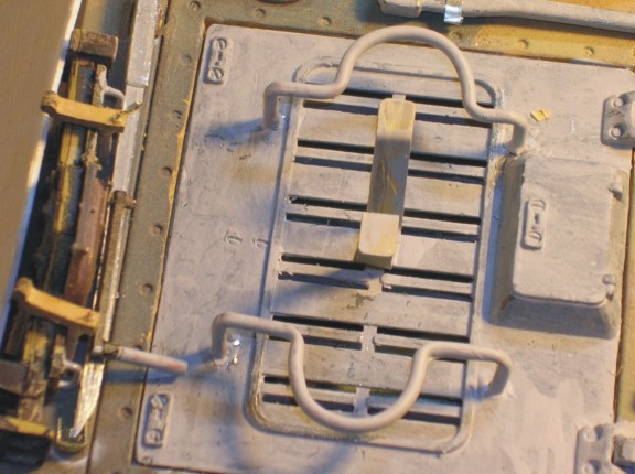

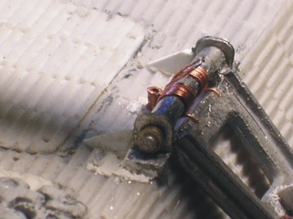

And the next pics. This is the first time I have tried PE. It's a challenge! :crazy: But starting to get the hang of it!

I wore my glasses plus a head double magnifier. The vision wasn't the issue it was the shaky hands! And like a lot of other guys talk about when one of those little pieces pops off good luck finding it! :haha:
And solder? Forget it. I couldn't do that I just used tiny dots of superglue. I would love to see someone post a youtube of someone soldering 1/16 PE. I just want to see it! :wtf:

If you can solder photo etch do solder it, it's much stronger. It's not the strength of the parts that usually lets you down it's the joint. And super glue isn't always upto it.

I soldered most of the photo etch on my norbert build. You don't solder the outside if you can help it but do it externally. When you attach I find it best to solder some 1mm threaded rod onto the PE and then bolt it to the hull (for larger items). Really tiny stuff I'll glue. Also when I'm filling I file the solder not the item so doesn't affect the brass. The other advantage of solder is it fills gaps which CA can struggle to. Each to their own though.

I sort of do the same thing on the bigger pieces Tom. I solder a little piece of copper wire and run it into the hull and then bend it down and sometimes epoxy it. I find by using a little copper wire if something hits it the copper bends whereas 1mm threaded rod snaps off. I have heard some guys talking about cold solder but haven't really looked into it...
