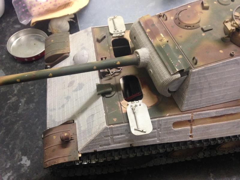

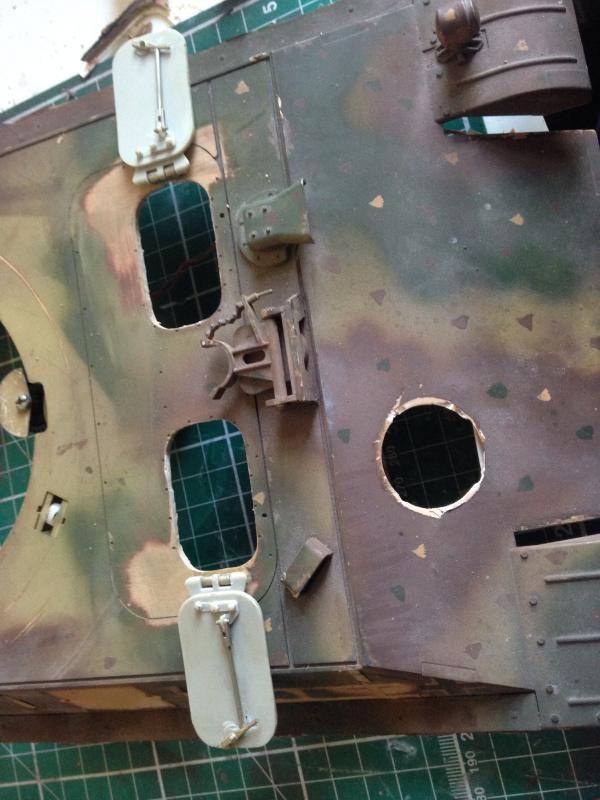

Finally pulled out the panther ready to get some work done. First job was strip everything off the hull. Then I sanded down everything to get rid of the glue marks. Next I've dremeled out the hatches and installed the schumo opening ones. I've started to add zimmerite to the hull, I've cut the moulded stowage bins off in preparation to add the aber ones.
Pics to follow.

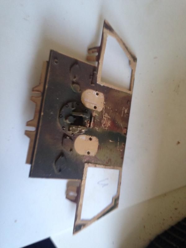

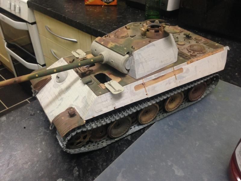

As promised pictures of the progress! I've installed impact gearboxes but the grub screw on the pinions come lose so I'll have to take them out! The sprockets seem too narrow for the kenny kong tracks so will have to do some filing.
Hatches cut out
Rear plate off with stowage bins removed
Plasticard in place to fill the holes
Rear with new exhaust bases and zim

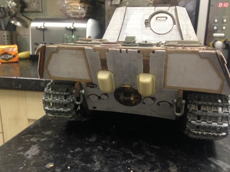

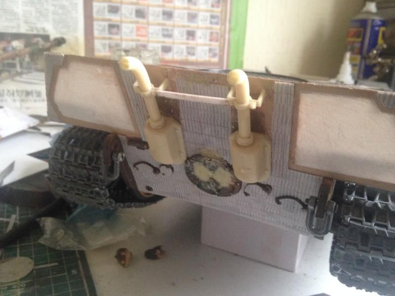

Some more progress and a setback, first the setback. I built up the rear exhausts based on a picture I found online which was backed up by some 1/35 early g's I found. Unfortunately I must have been half asleep when looking up my references as the rear I ended up making was that of a panther D! Epic fail.
So I have tried to amend this and went back into research mode and found some pictures of panther g's with the rounded exhaust bases and went from there.
The incorrect setup:

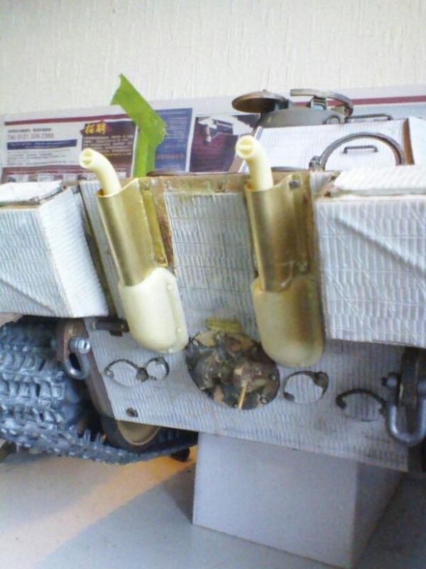

I went back and built some new exhaust covers from brass, rebuilt the tow hitch and came up with this:
Much better, looking more like this

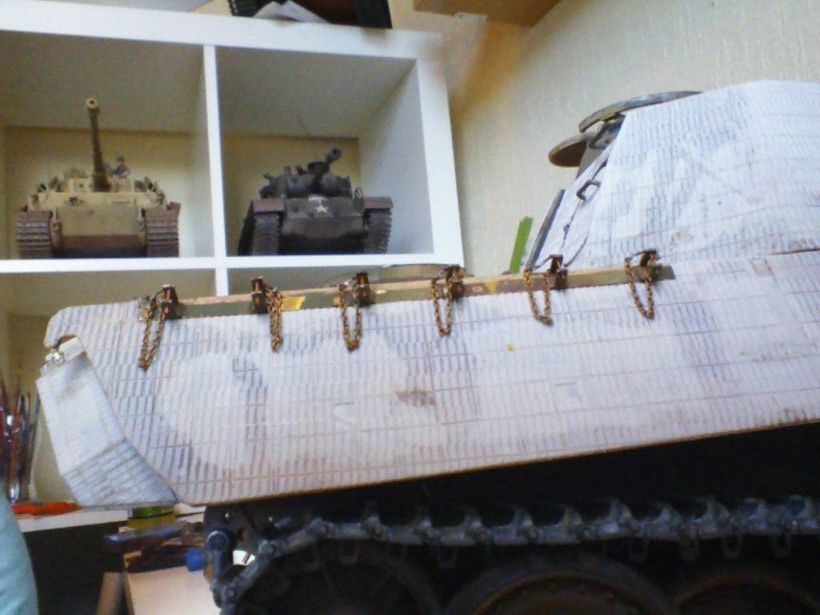

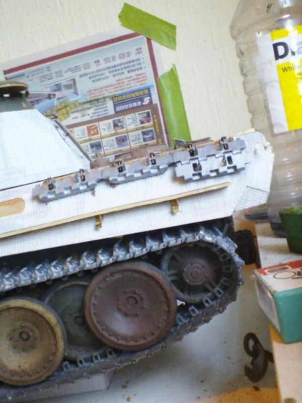

Next I added the spare track holders, new pins and chain soldered on to keep everything together:
I've also added the the running boards and attached the photo etched hangers for the side skirts.
