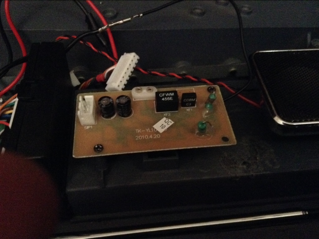

This is the reciever and i guess one of the crystals will go in there

rx in the receiver old chap ,tx in the transmitter make sure they are seated properly, no1 crystals are the norm so see if you can get some higher numbered ones 5/6/7/8/? your track judder may be clutch slip that makes a horrible noise ? or you may have your tracks to tight ?

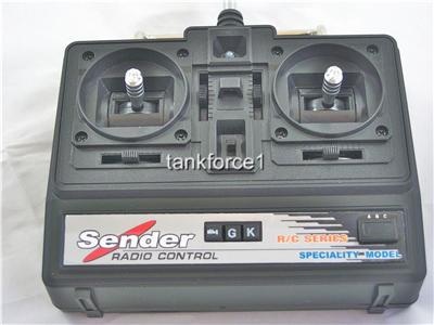

Whats a crystal a socket this transmitter is made for the smoke and sound version if you have a transmitter luke this could you show me please

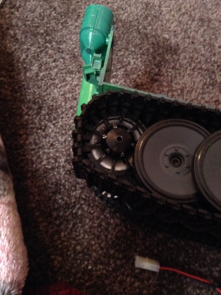

Hey guys this is the problem with right side of the tracks now i have cleaned the transmission (gearbox) but that didnt work i cleaned nearly most of everything now this tank is very older the owner had it for a long time now these has never had any replacement parts installed do you rhink i should buy new idlers and the other bit and the other end ????

Applelover786 wrote:Whats a crystal a socket this transmitter is made for the smoke and sound version if you have a transmitter luke this could you show me please
on the front, A.B.C this is the crystal socket
