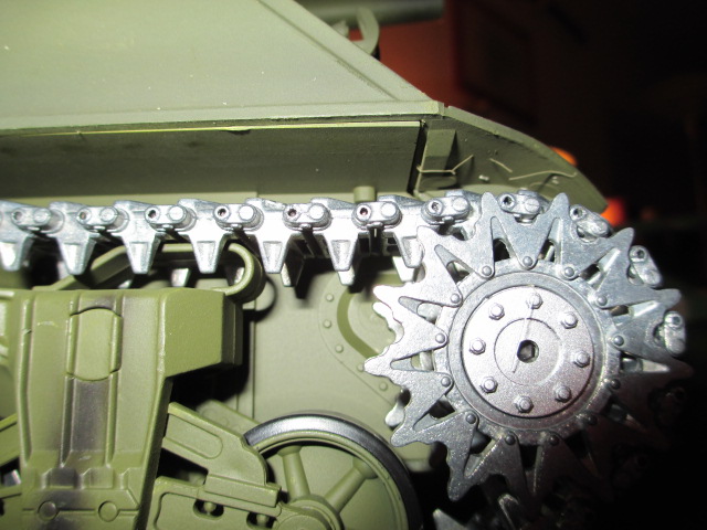

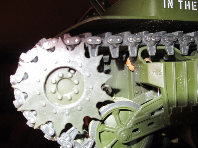

The big issue with these Heng Long tracks is that the guide horns are in the wrong place. On real Shermans and on most all of the RC ones I have seen including the MATO Sherman with this kind of track, the guide horns are part of the link. On the HL version of the tracks, the guide horns sit off to the side on the body of the track segment. This enables HL to use fewer pins
( one instead of two to secure each side of the segment ). *chuckles* A picture is worth a 1000 words so:
warm regards,
P.S. The Mato track is not perfect being a bit oversized and chunky but it is a strong, good looking and accurate track. The HL track in metal is strong and good looking but a bit hollow and with the very visible guide horn issue.
warm regards,

Looks like two different versions to me... best you send both over the pacific and let me check them out close upPainlessWolf wrote:Good Evening Jeff and Happy Early Thanksgiving.
warm regards,
