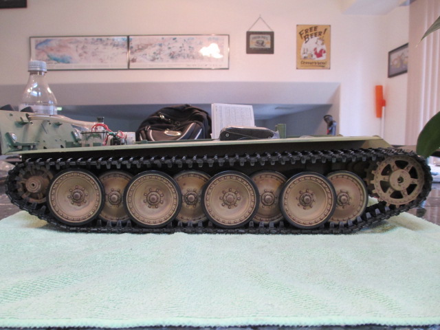

Thank you Painless. Here is a BW shot messed with in Photopaint.

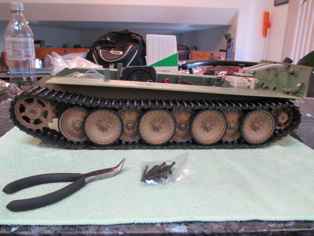

I was enjoying your paint job this morning when I noted something on your tank that is easily fixed and will give your gearboxes a much easier time of it. Add a single link to your tracks on either side. This will give them a little more slack. It will look better and drop the stress that too taut tracks put on your gears and motors. Here is an example from my recent Panther G build.
warm regards,
warm regards,

Re: My first build. Panther G
Thanks for that tip Painless. Where do I pick up the extra link needed? Thanks for the input fellas. I will take notes for the next one. I get my KV-1 IR today, and picked up a batch of used Tigers off Craigslist over the weekend.
