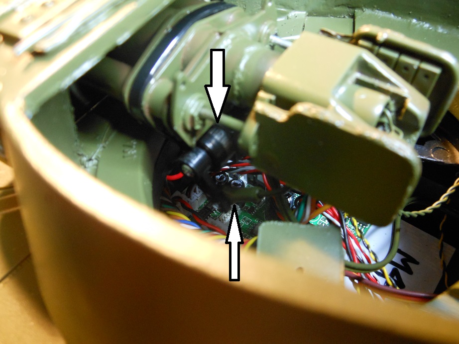

cfredbandeira wrote:Do you have any photos on the hiden servo recoil installation?
cfredbandeira,
Top arrow points to the servo which is mounted directly underneath the barrel, the bottom arrow points to the control arm and it is attached to the breech block but is hidden by the breech guard so you don't actually see the mounting point.

Here is the video prior to the mounting of the breech guard so you can see the mount point for the servo control rod.
http://youtu.be/N5FWmE5T_u8
MichaelC

Excelent job! Thank you for this post. I'm having some problems with the recoil on my M36.
