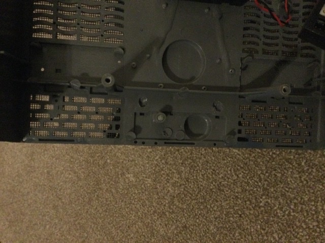

And a close up of the antenna base
Jofaur86
Posts: 2228
Location: Centre France
Re: HL-Tiger antenna position
Post by Jofaur86 »
yes the small black wire is the antenna, it is strange that the support of the old 27 Mhz antenna remains, it is to be removed, by pulling on it with pliers and a slight right-left rotation, then filling with body mastic, anyway it's out of place, so no regrets. ;D
and not in good shape either
Mickp868
Posts: 19
Joined: Sun Dec 13, 2020 4:26 pm
Location: Hythe Hampshire
Post by Mickp868 »
Thanks, I will remove the supplied antenna mount, I saw a good video on an American site where a modeller clamped a heavy pair of pliers to the antenna mount, turned the tank body upside down and then touched his soldering iron to the base of the antenna mount. The heat after a second or two was enough to loosen the antenna and it dropped straight out without damaging the body of the tank.
Jofaur86
Posts: 2228
Post by Jofaur86 »
:D
yes, it is also a solution
Mickp868
Posts: 19
Post by Mickp868 »
It worked really well, old mount came out clean, first layer of filler in, top off and sand down tonight
