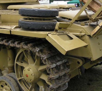

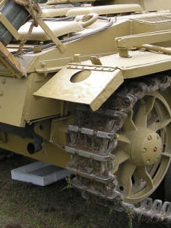

I've remade the convoy light and reflector brackets using some brass strip taken from a photo etch sprue. In order to get a good representation of the shape i've been studying the photos of the Bovington panzer III on the following link.-http://jtrowbridge5.smugmug.com/German- ... 3832_U95zQ
I decided to make new mudguards from plasticard and then glue them over the existing ones. This means that they are a lot stronger than fully scale replicas. Some scale thickness is achieved around the holes in both mudguards for the convoy light etc by making them this way.
The plastic strip pictured forms the inside flange of the mudguard.
I made two more hinges as explained earlier.
The lugs from the convoy light and reflector were cut off and the parts cleaned up.
Then all the parts were brought together.
The mudguard stays were also made from photo etch left overs. Some care is needed with the positioning so that the spare road wheel will still fit.

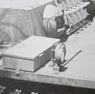

Moving onto the horn, i spent hours trying to find a photo of the mounting bracket without any luck. The scale drawings i have are so small its very hard to see any detail and i nearly gave up until i found a web site for 1/6 scale tank upgrades. There is a white metal horn and bracket available that i used the pictures of to scratch build a bracket.
Again i removed the lug to plug the hole on the fender and removed the bracket so that just the round part of the horn was left. A round piece of 'plasticard' made using an office hole punch was used to cover the hole in the back of the horn. Small strips of plastic were added along with some rod to start building it up.
I've left the rod long to ease handing.
The finished horn and bracket.

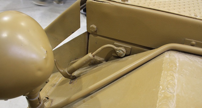

The 'Notek' light was a lot more straight forward to improve.
For this i removed the lug and opened out the middle of the mounting bracket+removed the round central part of the light. This was replaced with some finer brass tube.
With a sanding block and needle file i thinned out the bracket base. The cone structure was made by sanding down some larger brass tube which was then cut to length.
Time to add them to the tank.
The cable housing is fuse wire with 'photo-etch sprue' stays.
The light on this side was drilled out to make it look damaged.
For the purists out there i may have inadvertently modelled the fuse wire in the position of the Panzer III J rather than the L. :{
