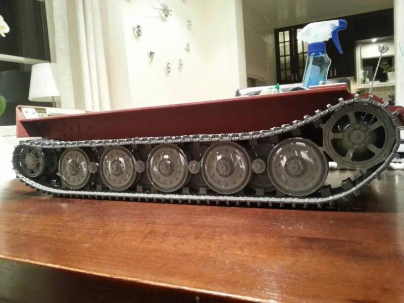

To add strength to the chassis I built inner fenders from 30x30x3mm angle aluminium profiles, these are bolted from ouside with countersunk M2 screws.
Gearbox brace is shaped from a 30x30x3mm angle aluminium aswell wich is bolted to the fenders with four countersunk M3 bolts as seen in the pictures.
Gearboxes is bolted to stock chassis with stock stand offs, no bolts to the brace.
Instead of the stock radio deck I shaped a 4mm aluminium plate to cover all the space from gearboxes to rear panel to add strength and weight. I used threaded M3 spacers to raise the deck over the torsion bars.
By doing this there is absolutely no flex in the chassis. You can put a block under one of the sprocket so it rests only on one sprocket and idler on opposite side and it doesn't flex at all. And this is a heavy beast. Far from completed and without metal roadwheels it's weighing 19 pounds.
Rear the speaker box will act as a brace, but it's not really needed.
GMV
Posts: 46
Joined: Mon Jan 02, 2012 1:30 pm
Re: Tamiya Jagdtiger conversion.
Post by GMV »

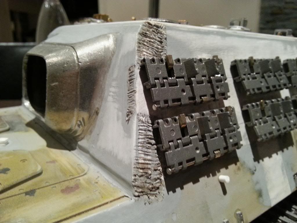

Some progress.
