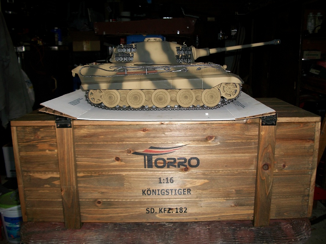

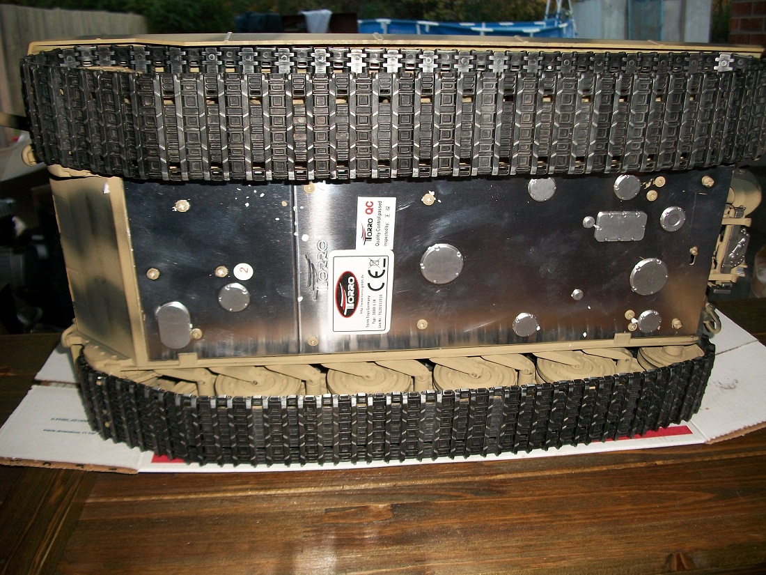

A few more picture as promised,the lower hull bottm plate,very thick,and very polished.Will not remain so after some serious driving.
Crate after drying,maybe needs a bit more clear,the wood is very dry and absorbs the clear qiuckly.This has been drying for a while and the white wood is still resurfacing a bit

Hull bottom which I scratched by accident,the latch is visable to the rear and centered.The access hatches will come off.Nice thick plate.Painting is under consideration.

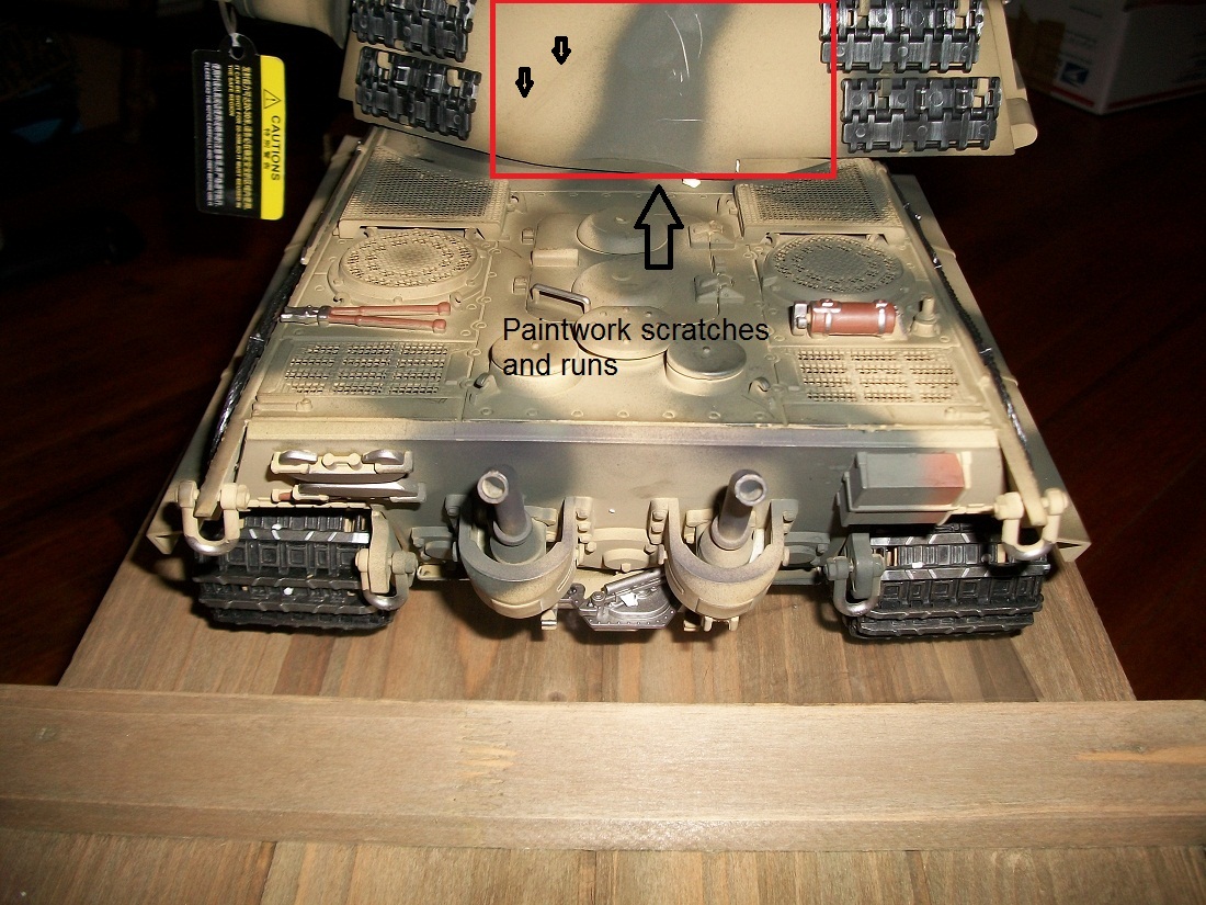

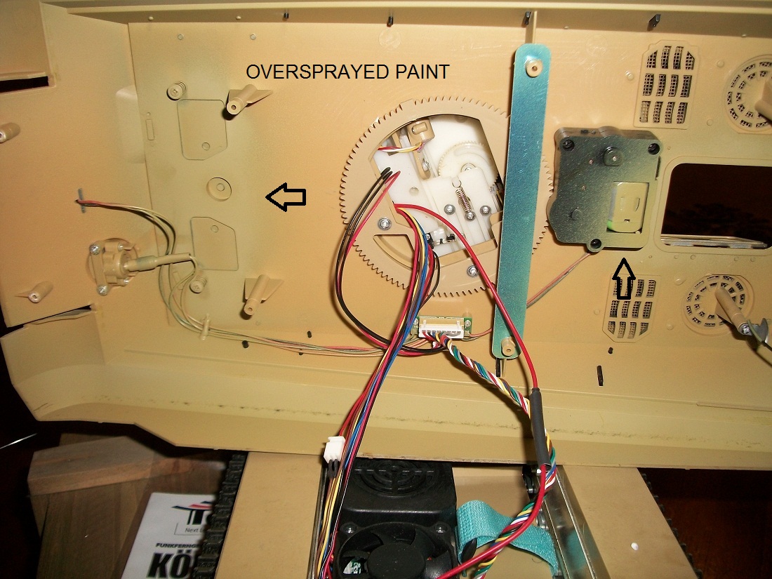

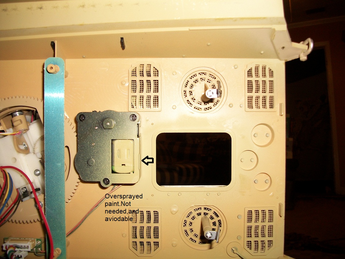

Ok Guys I have some negative points about this Tank to post. The cosmetic condition was not perfect.Mainly the paintwork,and the way in which the painting was done.
Sloppy over-spray into the interior tells me this was not a custom grade/painter. But beyond that the paint is very thin,to much thinner not enough paint and no sealer is used period. Either on the base coat ot the camo paint.
A bit less thinner and a simple coating of sealer would do wonders.
Their is a bad paint run on the turret side,several scratches.

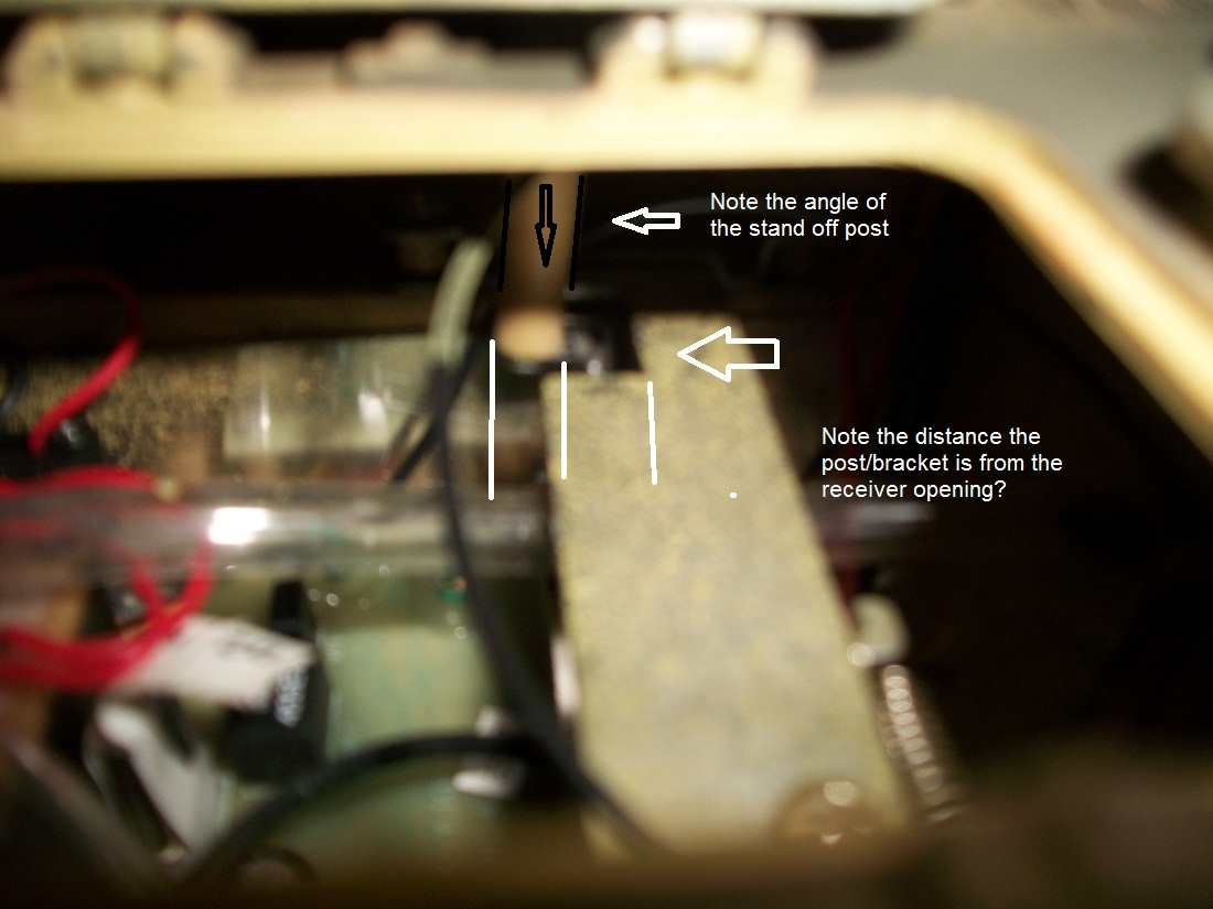

The next point is a problem that would have caused a break in the upper deck.The latch is like first Asiatam Tiger hull.A sliding bar that when closed traps two metal brackets that are attached to stand off post of the upper hull mold.These extend down and pass through the latch securing the upper hull.

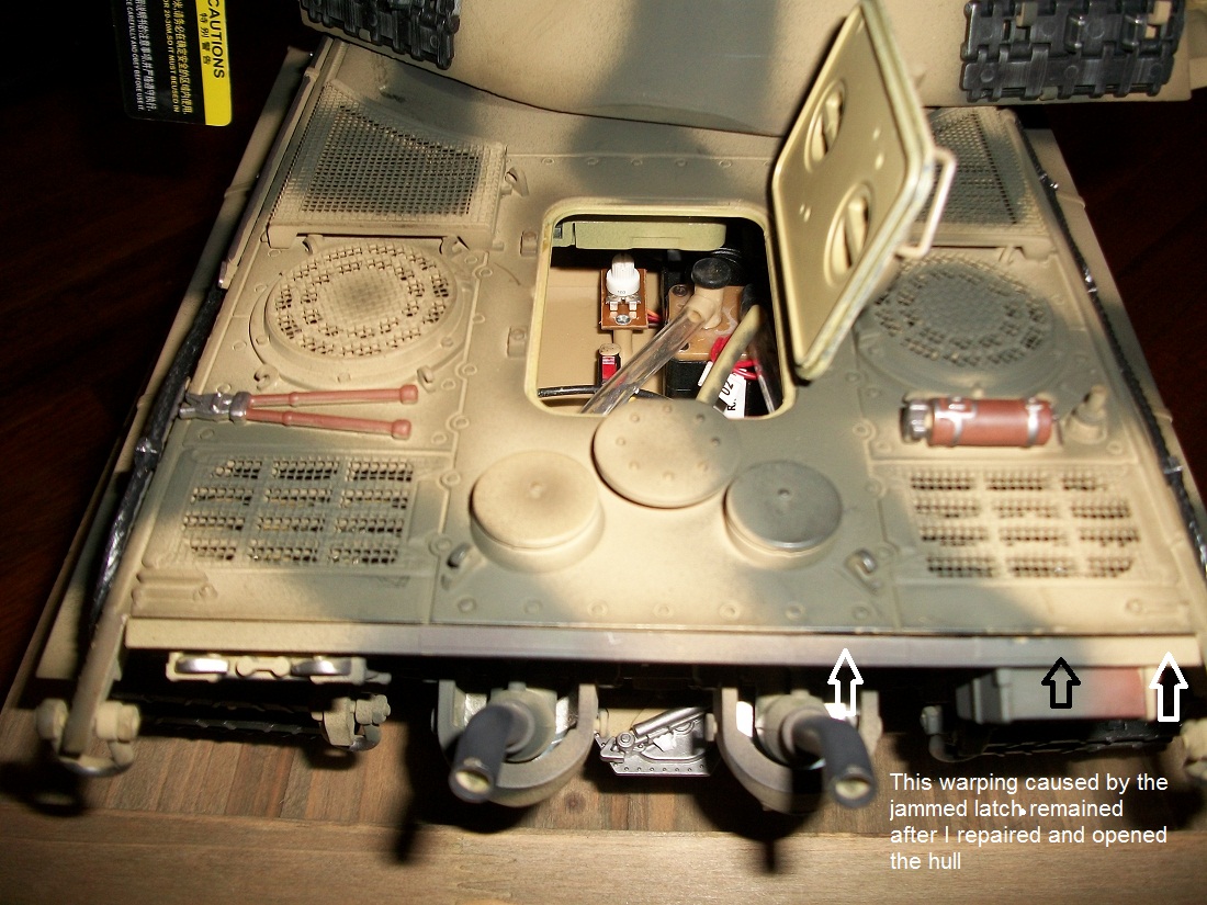

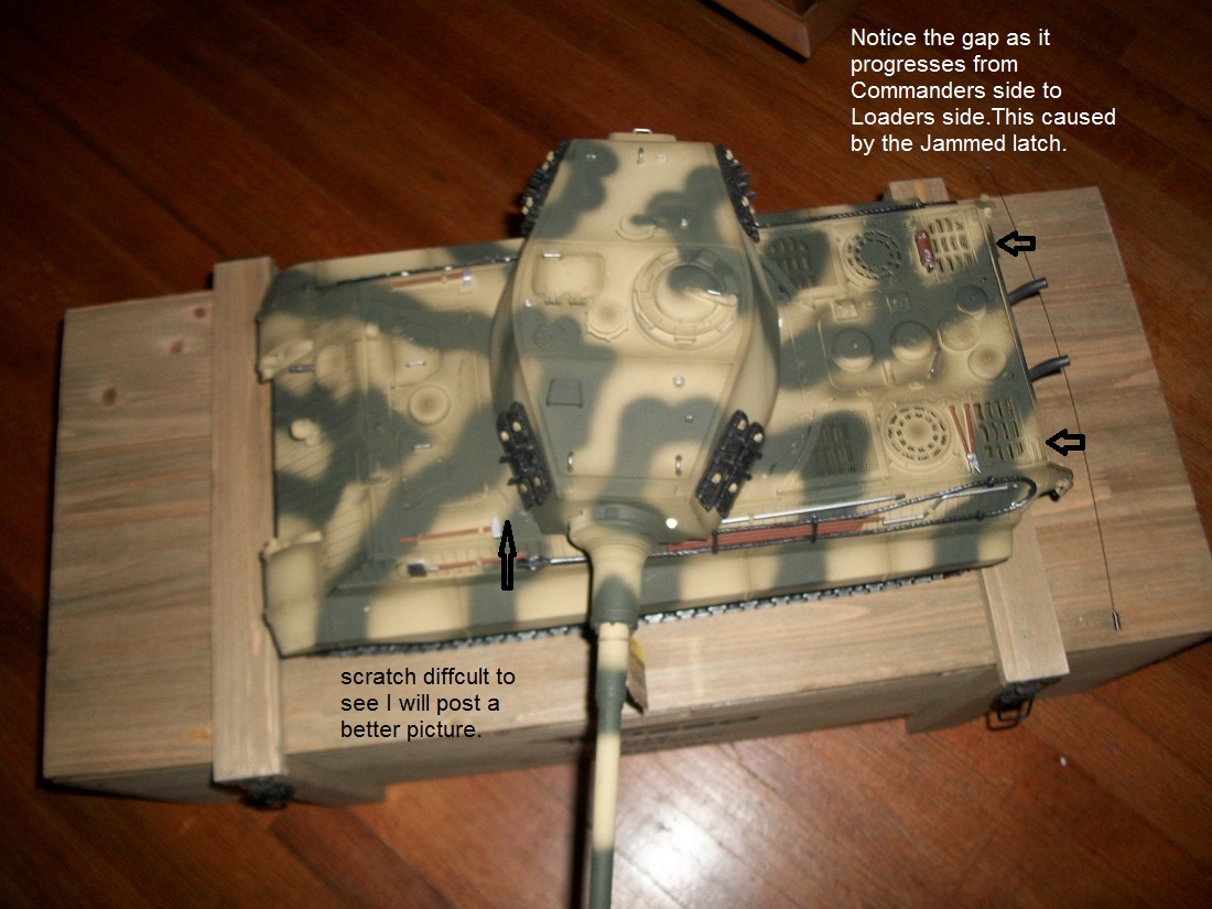

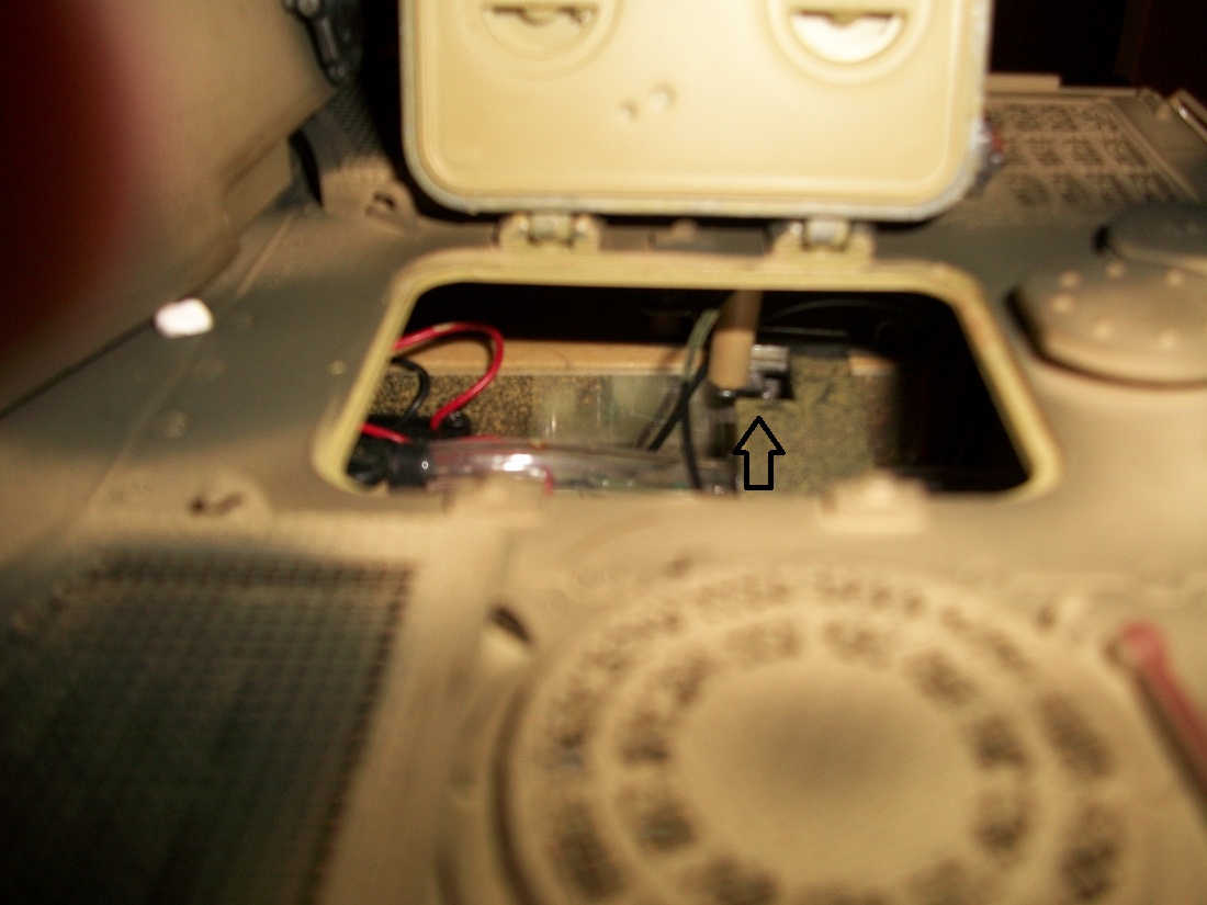

In this case they were forced down,missing the sliding bar opening and forced in front of the bar almost breaking them off the upper hull,but also warping the upper deck and the rear back hull plate section Creating a Gap and really without being familiar with this from my experience with my Asiatam Tiger Hull it would have been very difficult to get this tank to open.The opening latch under the hull that works the sliding bar was jammed half way between the open and closed position.
Reaching in through the Engine hatch I was able to free the latch and the stand off post opening the hull I repaired the standoff and the metal bracket,also bent but once I closed the hull properly the gap between the upper deck and rear plate was wider on the loaders side.nice tight fit.
Here are some photos of this really bad mistake.
Tomorrow I intend to address the major fault with this offering,and it is a disappointment. This also is the first I/R Tank I have ever obtained new,excluding the Tamiya tanks I have owned.I wanted to upgrade this tank for battle having the MAKO and ATRC units both.
Here are a few pictures,these were taken the very moment I unboxed the crate and opened it.
Paintwork defects
Paintwork defects
Over spray
Over spray
Over spray
Over spray
Notice the angle of the stand off and the latch receiver. This caused the jam
Note the remarks
Note the remarks
Rear deck/plate gap caused by the jammed latch post.
Warping caused by Jammed Latch
