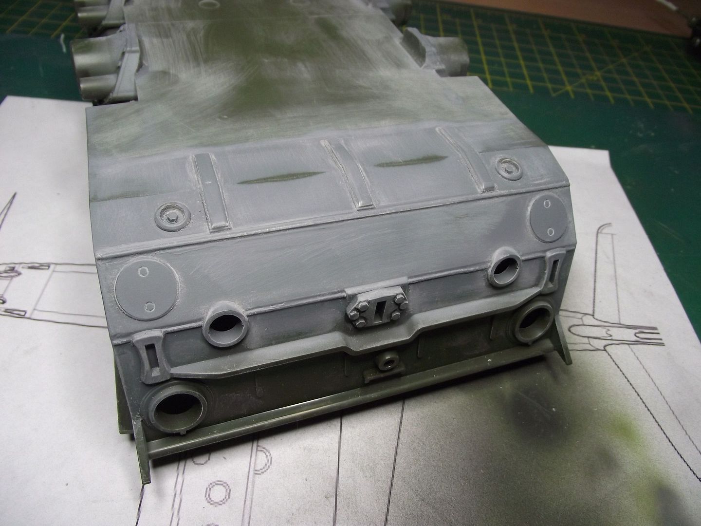

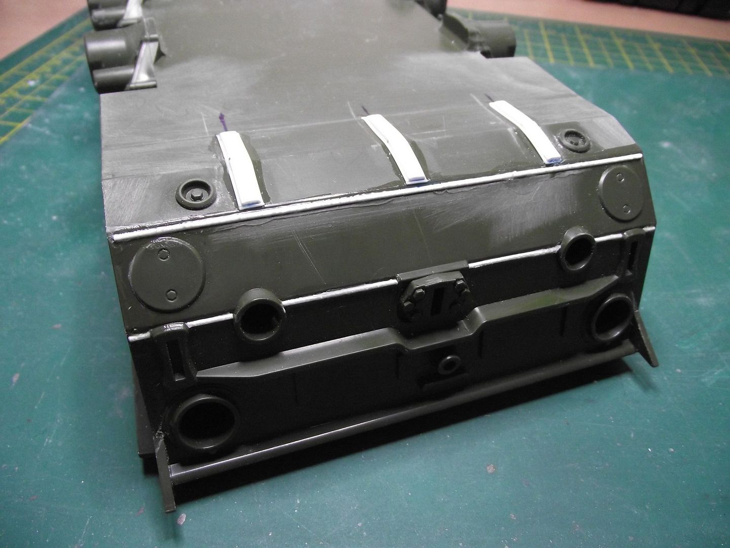

Not a lot of posts of late, I've been busy adding more weld seams, and priming the hull. It's a very big Hull you know!!!

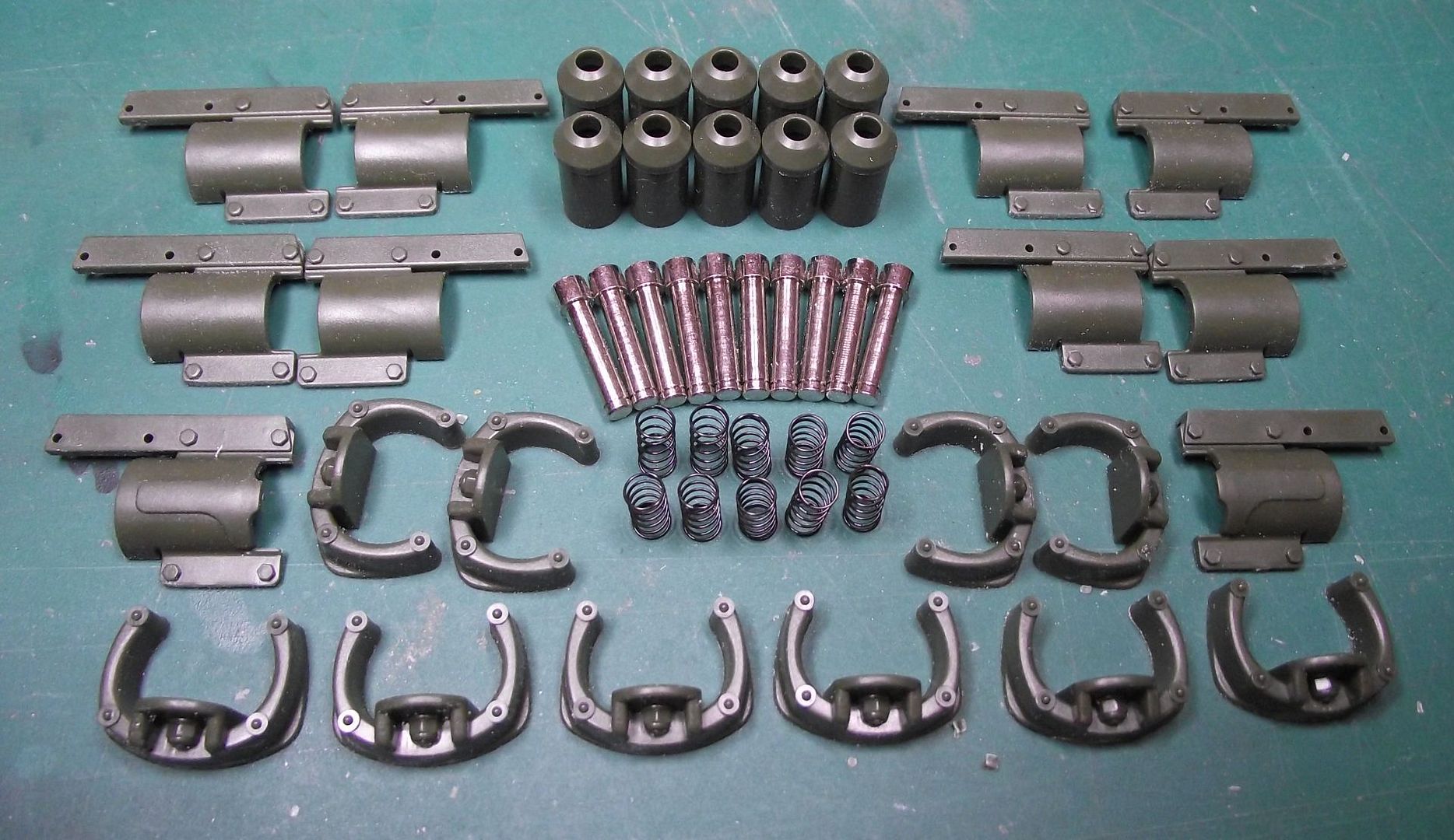

I ordered some suspension arms and idlers from Tankzone. The idlers arrived immediately, the arms are in the post...

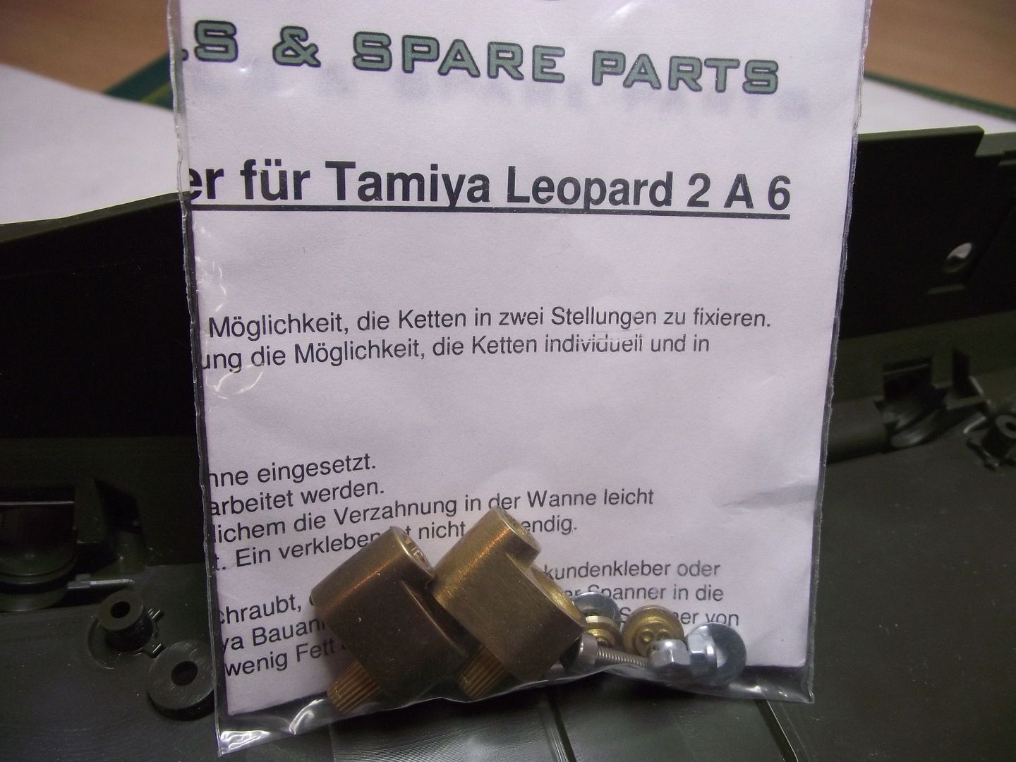

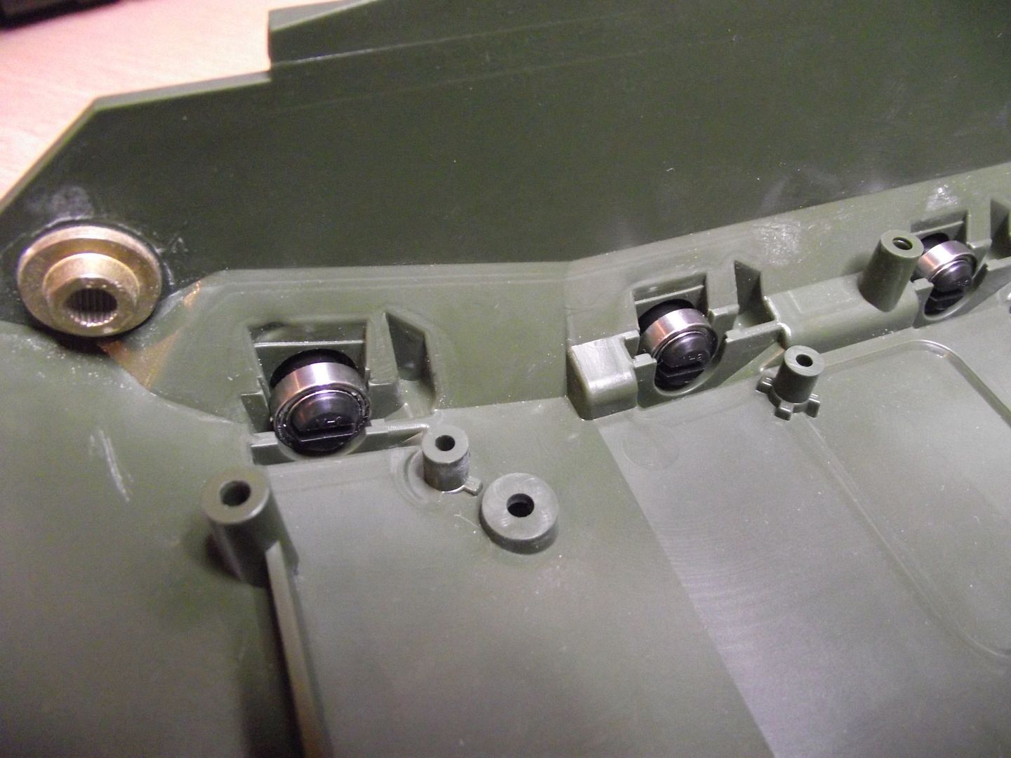

Here are the brass idler adjustment arms....
The mountings fitted.. I've used some superglue just to make sure they don't move in wards. The instructions tell you to file the holes out to allow the brass parts to fit, very little filing is necessary.

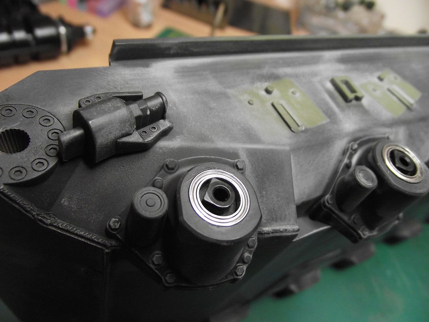

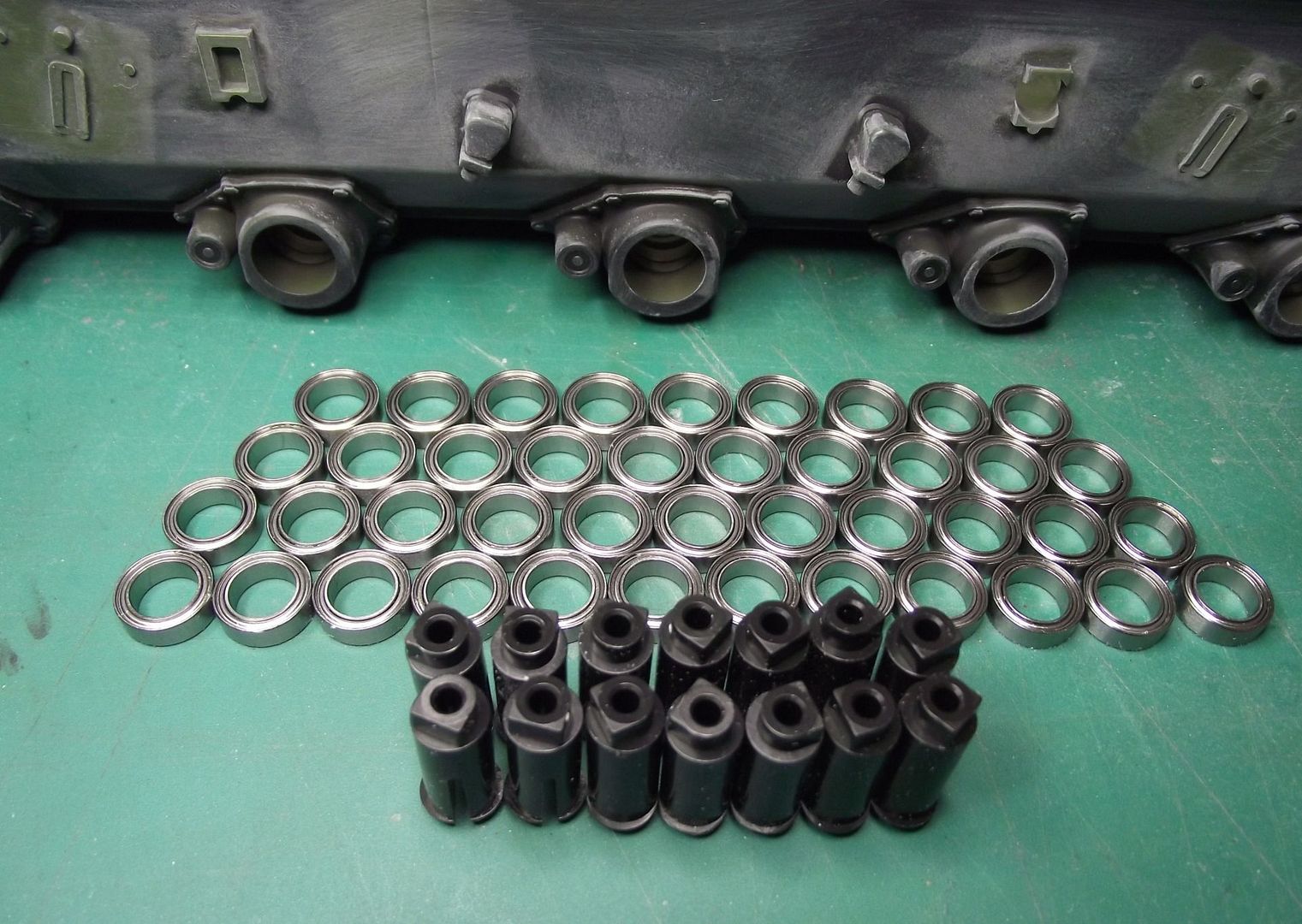

It was then time to fit the pivots for the main road wheels. I have used the aftermarket bearings here, there are 3 off per pivot.
Fitted.. I have used superglue again here on the outer bearings, just to hold them in during assembly and stop them moving in the housing.

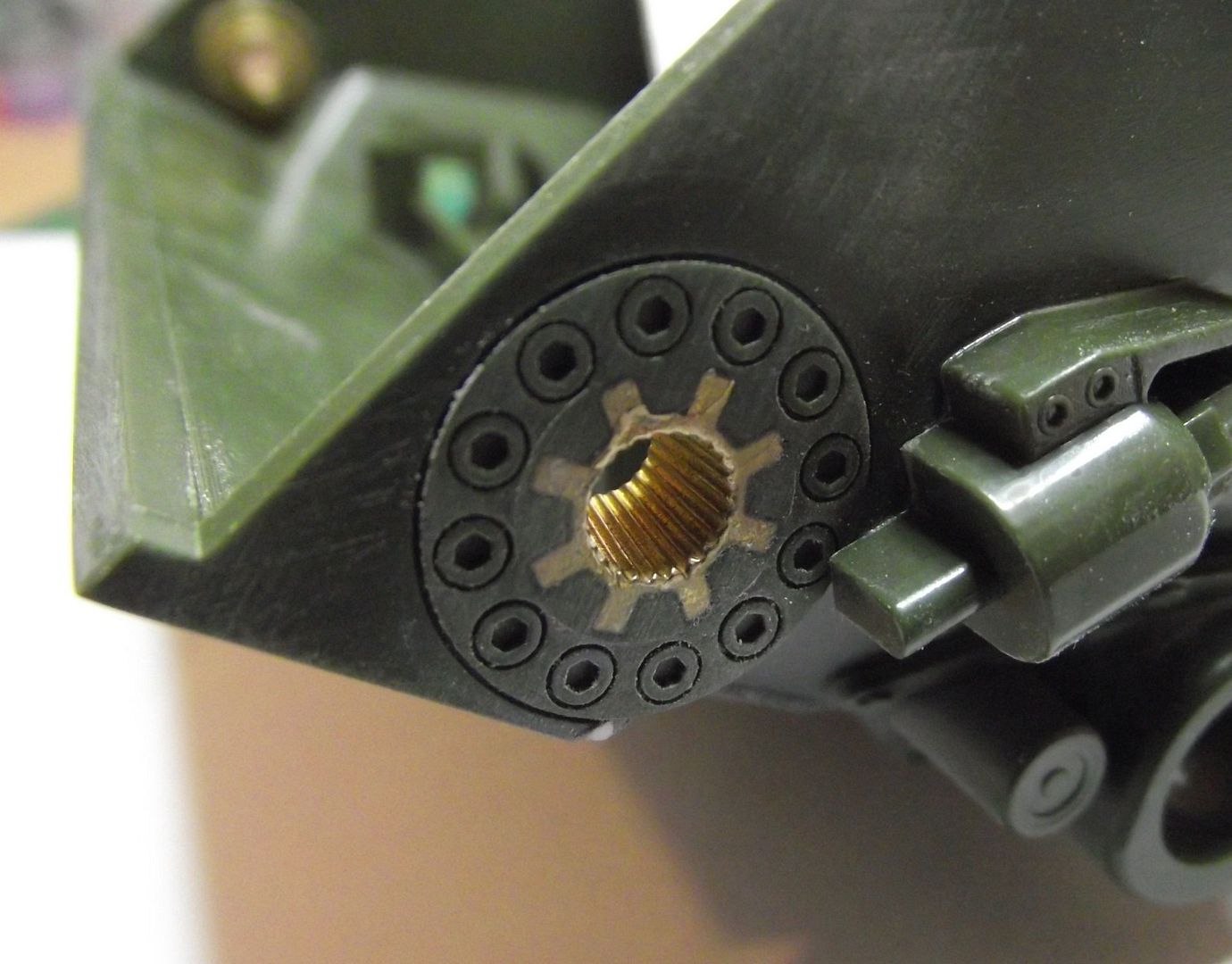

Inside, note the brass idler fitting... nice!!
