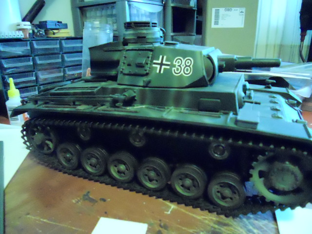

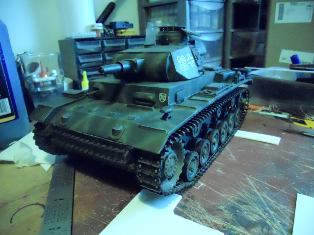

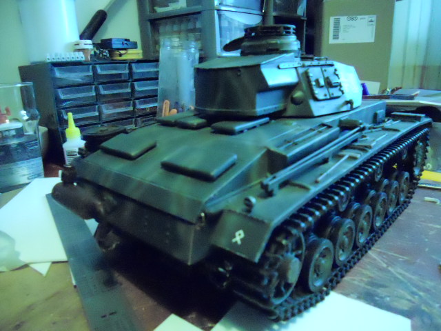

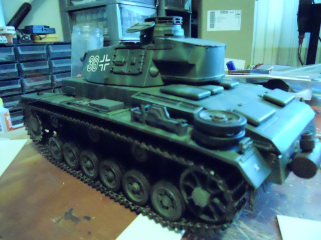

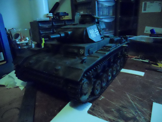

OK...l.it's all systems go on the project now. Short one camera at the moment, so pictures will have to be added later.
1) Opened up my new toy, and began surgery. First up were the Taigen 4:1 metal gearboxes. Really nice bits of ket these for the price. Have proper bearings on the output shafts, unlike the stock all bushed affair. Three screws to undo each stock box and the gearboxes were a straight drop in fit. Everything lined up perfectly. The black metal gears are all well machined and everything turns smoothly. Quick tidy up of the wires, and the top when back on.
2) Mato tracks. Seem very nice too. Come with a pack of extra links, and one extra was needed to get the length needed. It's too short as it comes, but with one extra link it looks better. Haven't adjusted the tensioners yet...which I will leave until it's running. Need to do a bit of tweaking to the supplied sprockets before fitting though. Front sprockets are supplied with a set of hex bolts too large for the hole. Quick drill out and all is well. The rear idlers are floppier than I will accept, so they will get a bit of shimming before I am happy.
One big question though...
How are the outside parts supposed to be attached to the inside parts of hte metal wheels. Should they be glued? The front sprockets have a hole so if you fix inner and outer halves, you can still get at the hex head...but the rears do not. Do I just press fit them?
Anyways...that aside...it's going swimmingly well. Drives nicely!
Have had a good chance to look at what needs changing and improving...and the list isn't too long.
Hull side:
Remove moulded on horrid tools and replace with nicer metal ones with brass brackets.
Remove moulded in escape hatches in hull sides. These were only fitted to early J models, and need to go for mine.
Remove stock extra track links and make new brackets into which lengths of the stock plastic tracks will go.
Make or buy some extra stowage boxes and some bags etc. for decoration!
Sort the exhaust....I want the smoke to come out the pipes...not from some random place in the back of the hull. Only seen a metal late model Ausf M pipe or solid metal J pipe, so I may need to make my own. Love a challenge.
Relocate the antenna
Turret:
Need to mod the cupola a fraction. Might get a metal one...but stick to the 2 door hatch. Stock cupola doesn;t line up when locked in place and leaves the hatches on the skew. Not leaving it like that.
Add extra track links on the turret top and hang some tin hats on.
Modify mantlet and gun barrel to suit
Then we spray her matt sand :)
My chosen vehicle was snapped in Tunisia...so no fancy cammo...just some suitable weathering and dirtying
