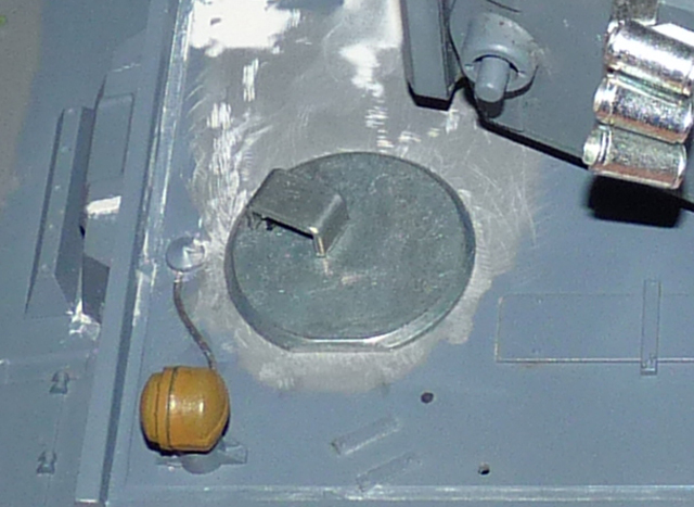

Great build ...plenty of ideas. Canyou advise how you managed to cut out front hatches ? Looks very accurate cut. Have recently purchased metal hatches but having difficulty/courage as best to remove. Cheers.

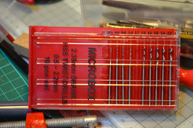

Hi. The way I did it was to use a small drill bit in a pin vice and manually drilling loads of small holes from under the hull using the recess as a guide the joining the holes up carefully with a modelling knife. You could use a dremel etc but I did it by hand as you have a "bit" more control it you pardon the pun. It does take more time but I found this way a lot easier. That done its just a case of using a small file to tidy up the holes for the hatches. The secret is to use the smallest drill bit you have and drill lots of small holes (the bit I used was 1.2mm). Once all is filed and sanded smooth using a bit of water and wet and dry paper, I just super glued the hatches in place using to the small pins to correctly seat the hinge. I hope this helps and thanks for the comment.amoruso44 wrote:Great build ...plenty of ideas. Canyou advise how you managed to cut out front hatches ? Looks very accurate cut. Have recently purchased metal hatches but having difficulty/courage as best to remove. Cheers.
Ian
