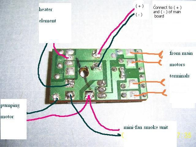

As for the mini fan , the electronic required to power them is more complicated than it seems ...The following picture is an example ....
To make your smoke unit fully proportional ; you would need the board mounted on the proportional smokers ...If you want one , just send me a P.M. with your mailing address and I'll give you one ...( I have quite a few spare ones ) 8) 8) 8)

Zanthaklaus wrote: My question is how to connect this super-smoke unit HL to tamiya electronics... :crazy:
I'm not a 100% sure about this ; since I never had a Tamiya ; but here's a picture that could help you ... 8| 8| 8|

HL proportional smoker - wiring from main gearbox motors
to the bouncy room ! Yay !
