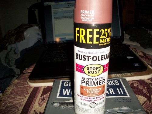

Hi Stevie, The primer is a must. My Tiger sat in the shed for a year and when I did start to rebuild it RUST had creped in, If you can get RUST O LEUM Primer it will prevent all rust.
Steel Dragons site was down last night so I have no new information, But Armortek is most likely your best source once you consider the shipping cost and VAT for parts from the USA they would be a bargain.
My VIPER Tiger needed alot of work,GIL at Armortek sent me a free copy of their Tiger manual which includes a parts list with the individual parts draft of each part. This has been a very helpful asset to my build, and their forum although restricted to owner has an excellent FOR SALE section, My Armortek Trakc and Sprockets were purchased through that source.
I'm sure you will create a fine Jagdpanther, cheers Blake
RUST O LEUM rusty metal primer

The primer you need is etch primer. You can get it in UK from Halfords. Brand is Upol. This is a light grey primer but you can paint over with rust red primer if you want. This gives much better protection. Metal needs to be thoroughly cleaned first. Oxidizing starts realy quickly. Have never seen Saxondog's version. Could be good but might be U.S. product
