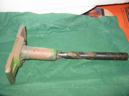

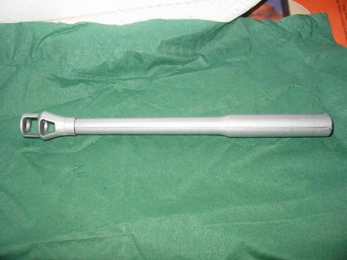

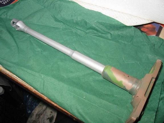

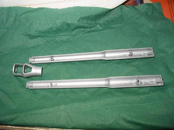

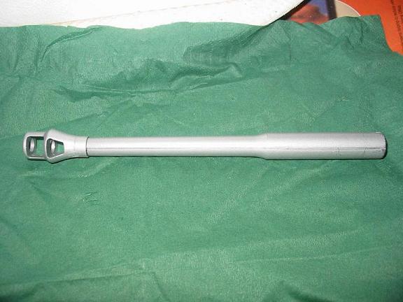

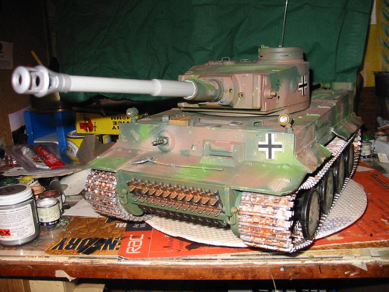

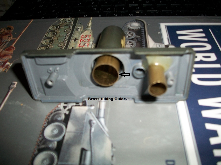

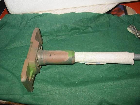

Stage 3: “ After taken the barrel away from the turret “, To take the old damaged barrel off, I cut it around the second highest point “ mantle “ on the barrel ( see pic 3 ) then splitting the plastic barrel down the centre, this left the bb gun barrel showing which easily taken away leaving a 10mm hole which had to be reamed out to 12mm to fit the new metal barrel, to do this I was going to use a electric drill, but the thought of holding the plastic barrel in one hand then drilling the hole put me off

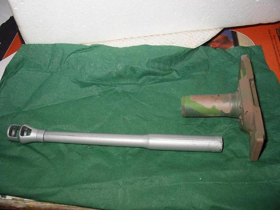

Then using the metal mantel barrel that came with the kit, I used this to get the depth of how far the barrel went in which was 12mm, I then glued together.
I done a bit of shell damage to the tank as you can see in the last photo. Will post photos of my first finished tank.
