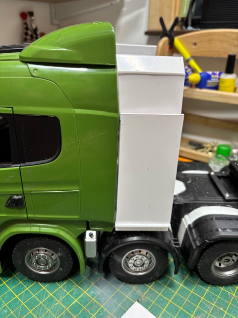

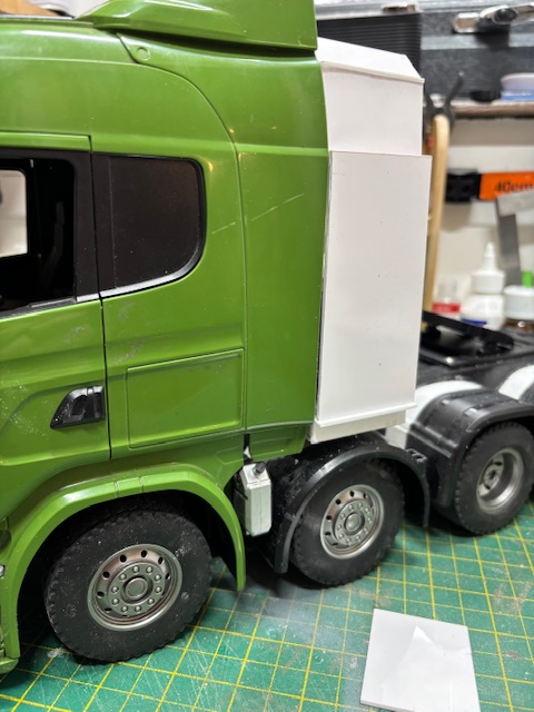

Final mudguards over the rear pair of steering wheels have been widened and installed. A start on the fairing over the fuel tanks, tool lockers, and air conditioning units. Plenty of shaping to do.
