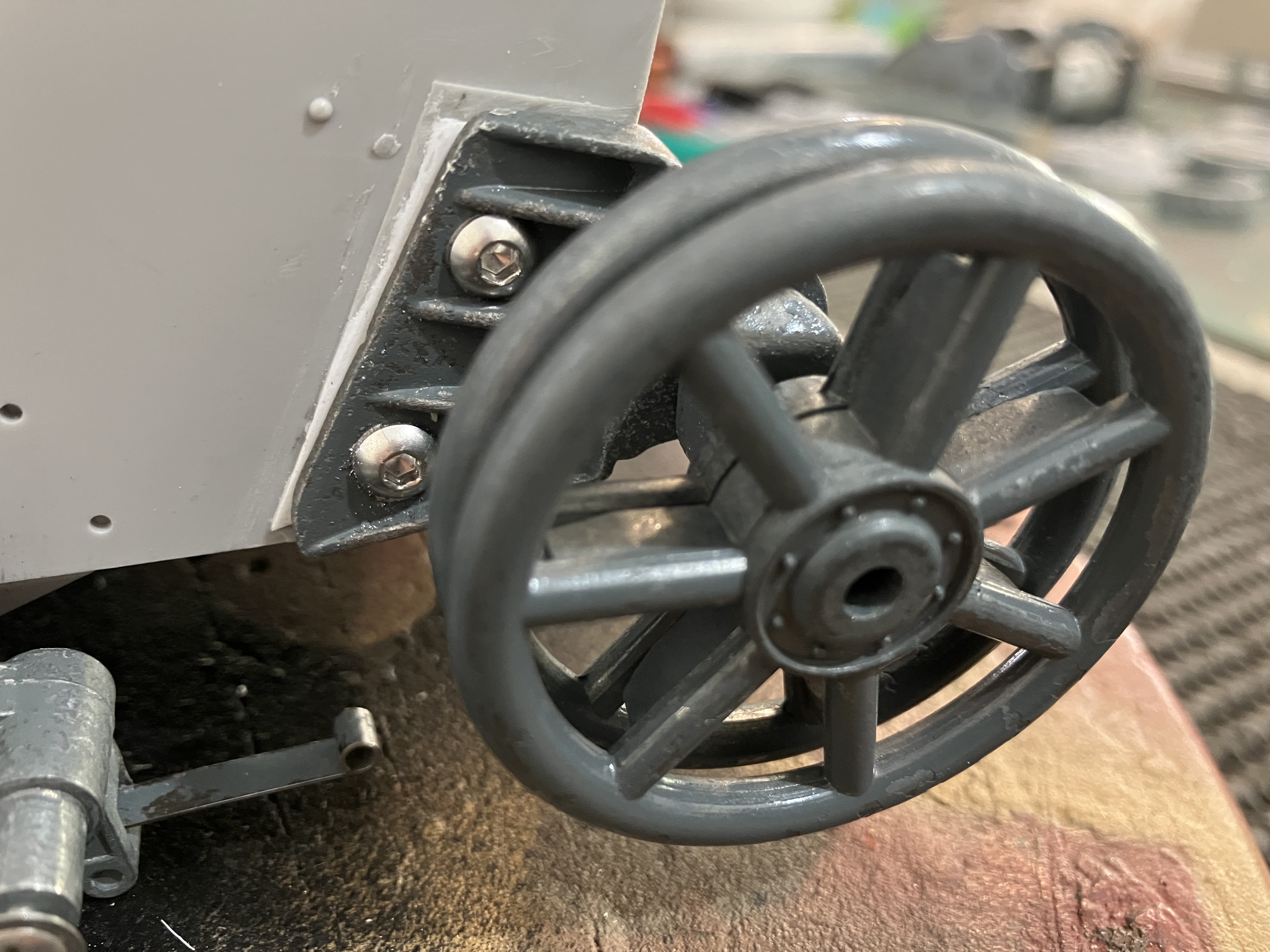

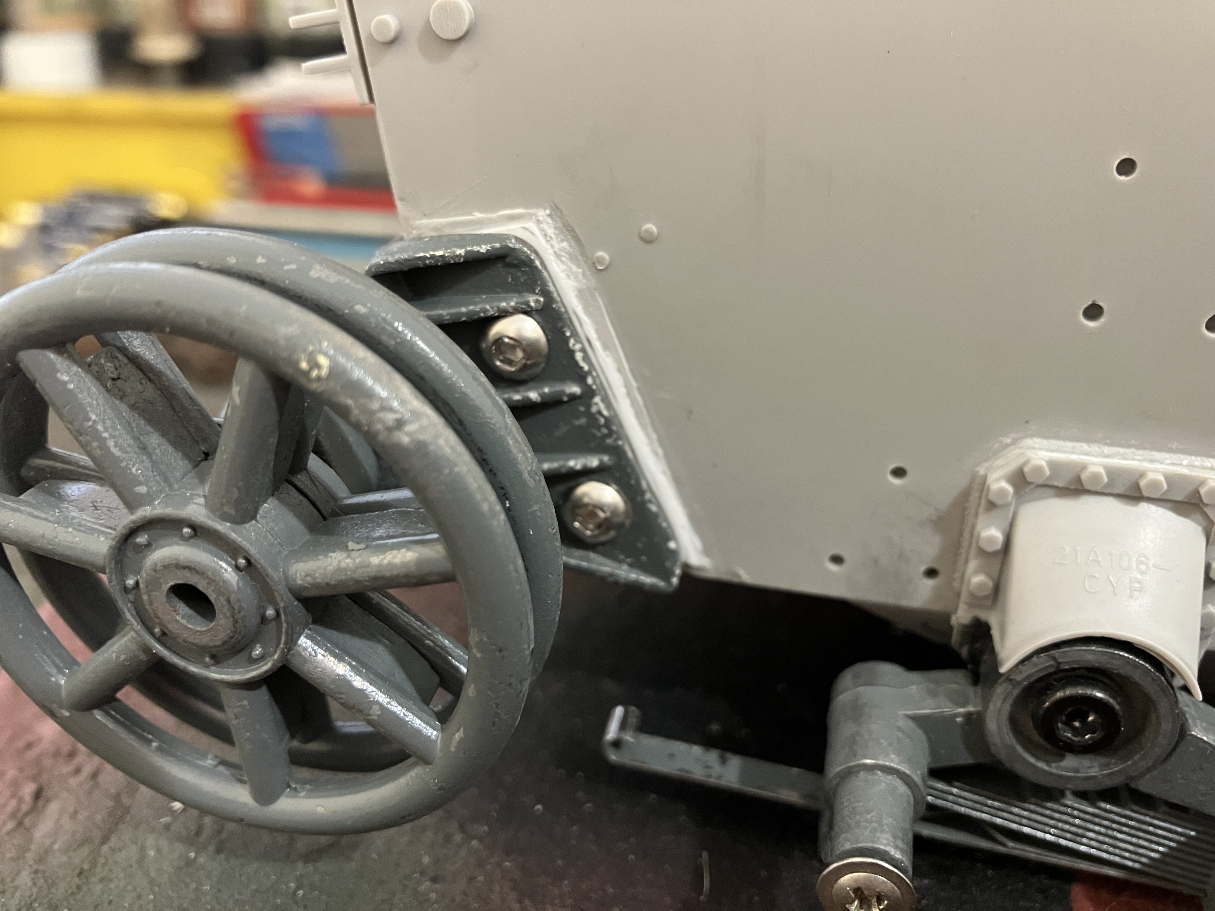

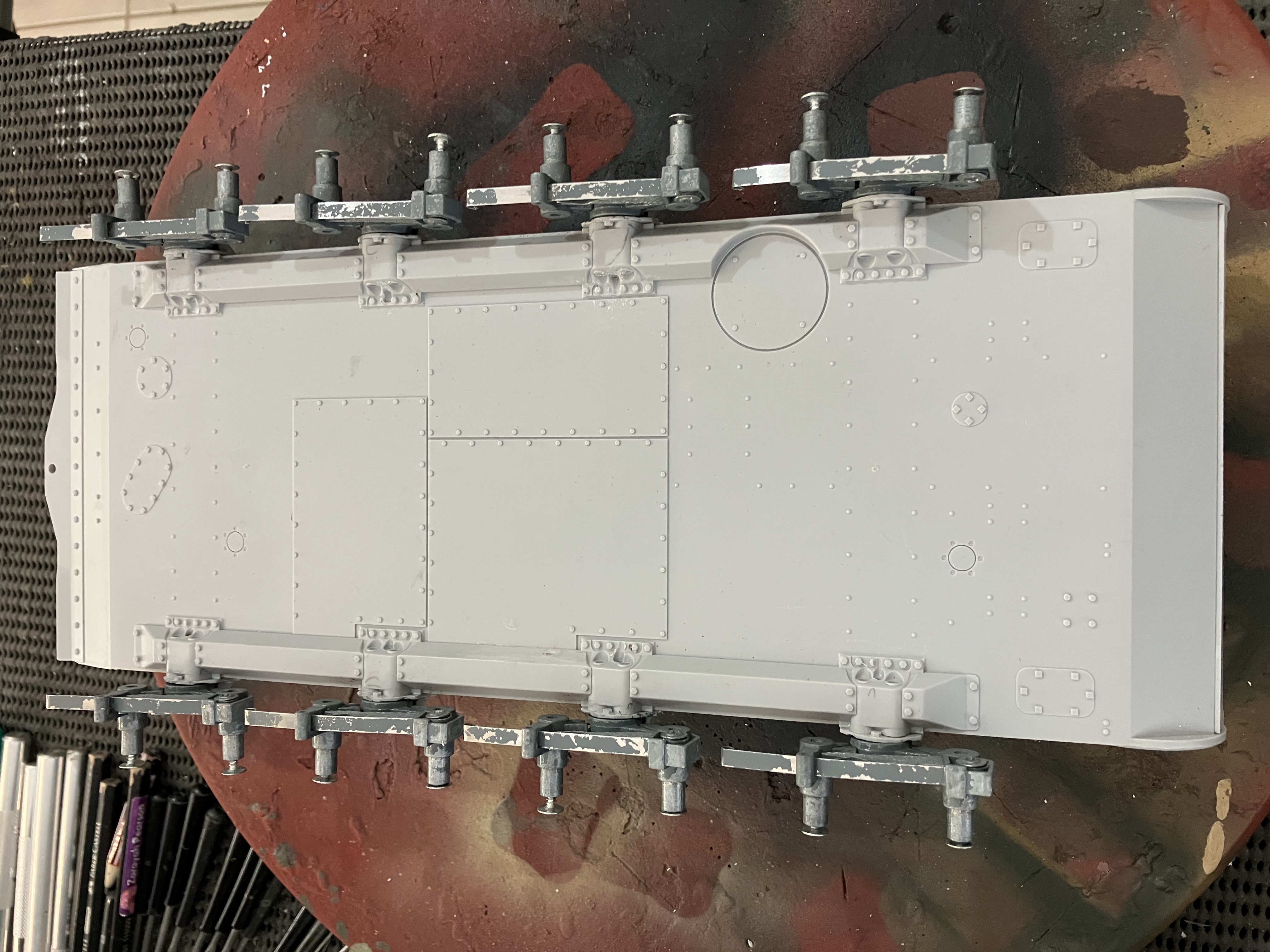

More progress.
The suspension arms are in line ( tick)
The idler mounts are on & in line (tick)
The spring retainer strips are on & seem to be ok (tick)
Mounting the idler brackets I used cap head stainless bolts which can be replaced with more aesthetic versions as the owner desires, but in this case robustness and maintenance-friendly hardware should prevail I feel.
I did a mock up of the upper & guards on the hull to see how it looks.............like a Pz IV should, which is good, considering it is one ;)
Now I can loose fit the roadwheels & begin the gearbox mounting saga :eh:

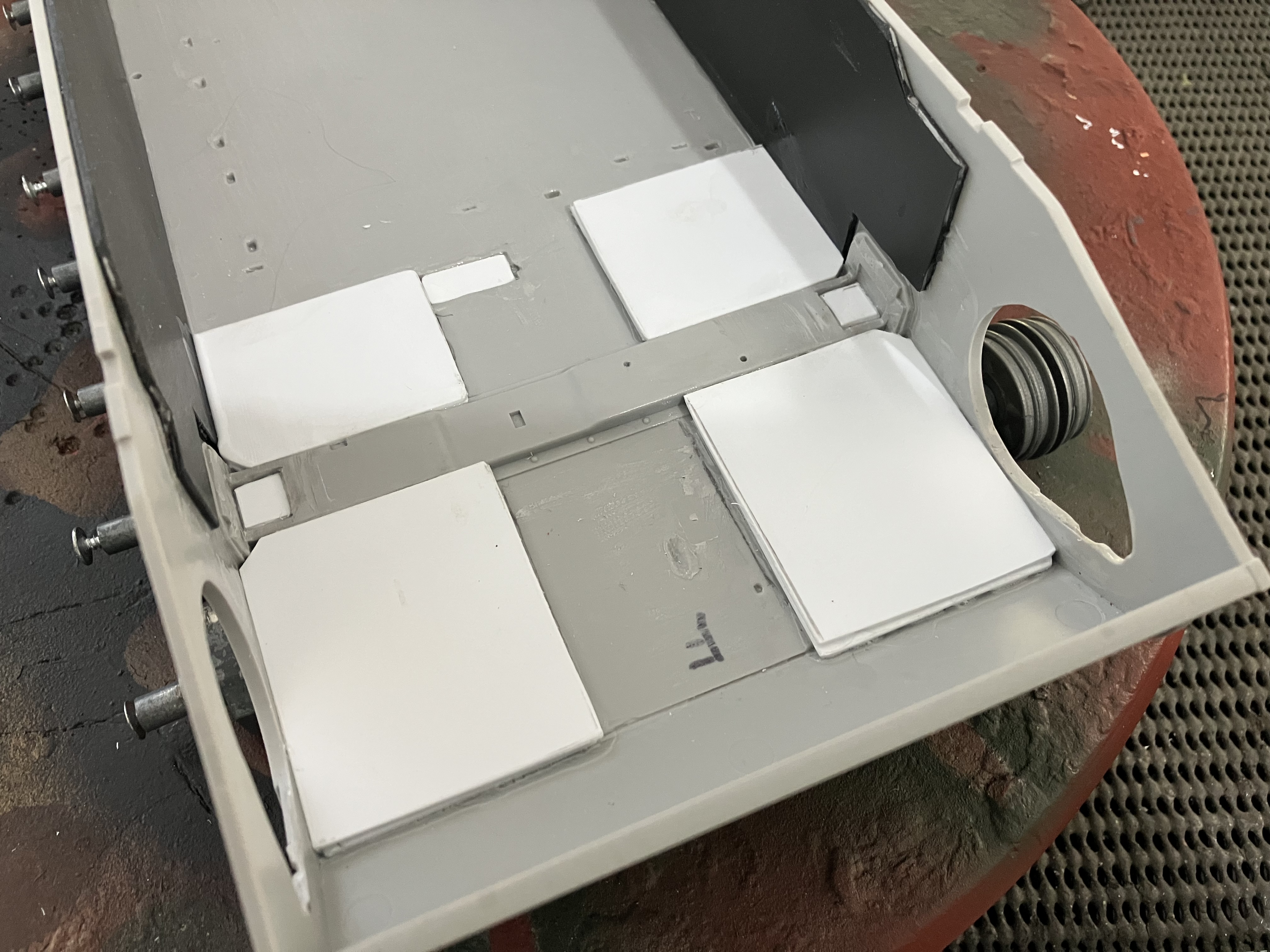

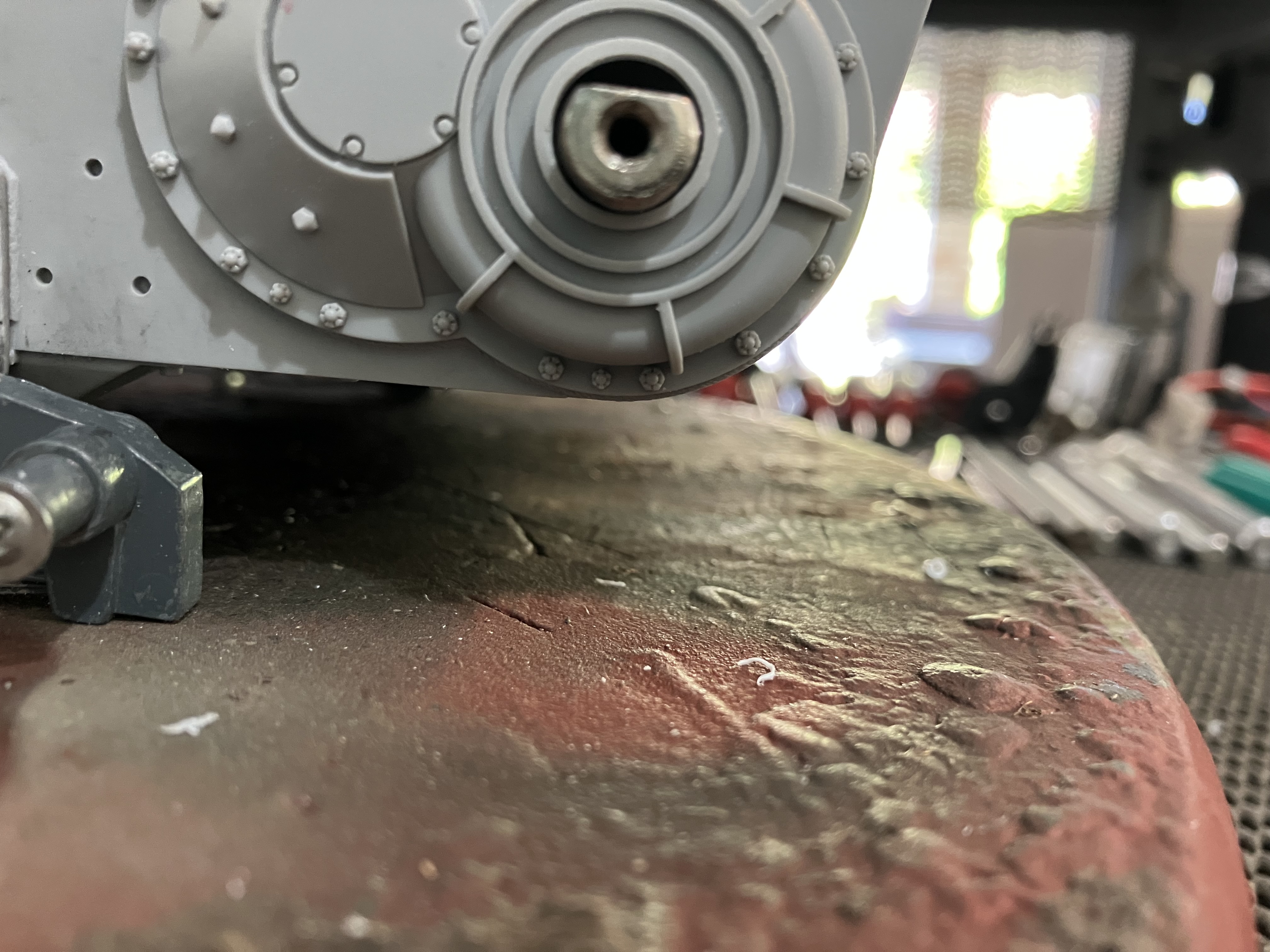

Gearbox time.
Using styrene sheet to shim the gearbox output shafts to suit the correct final drive position in this is not straightforward.
The material on the gearbox frame has been removed as far as possible but the clearance to transmission plate & electric motor is to decimal-poofteenths & that’s small !!
Of course using genuine low profile gearbox’s would be much better but we ain’t got those !
Once I have the shimming right then it’s alignment & I can secure them on the floor .

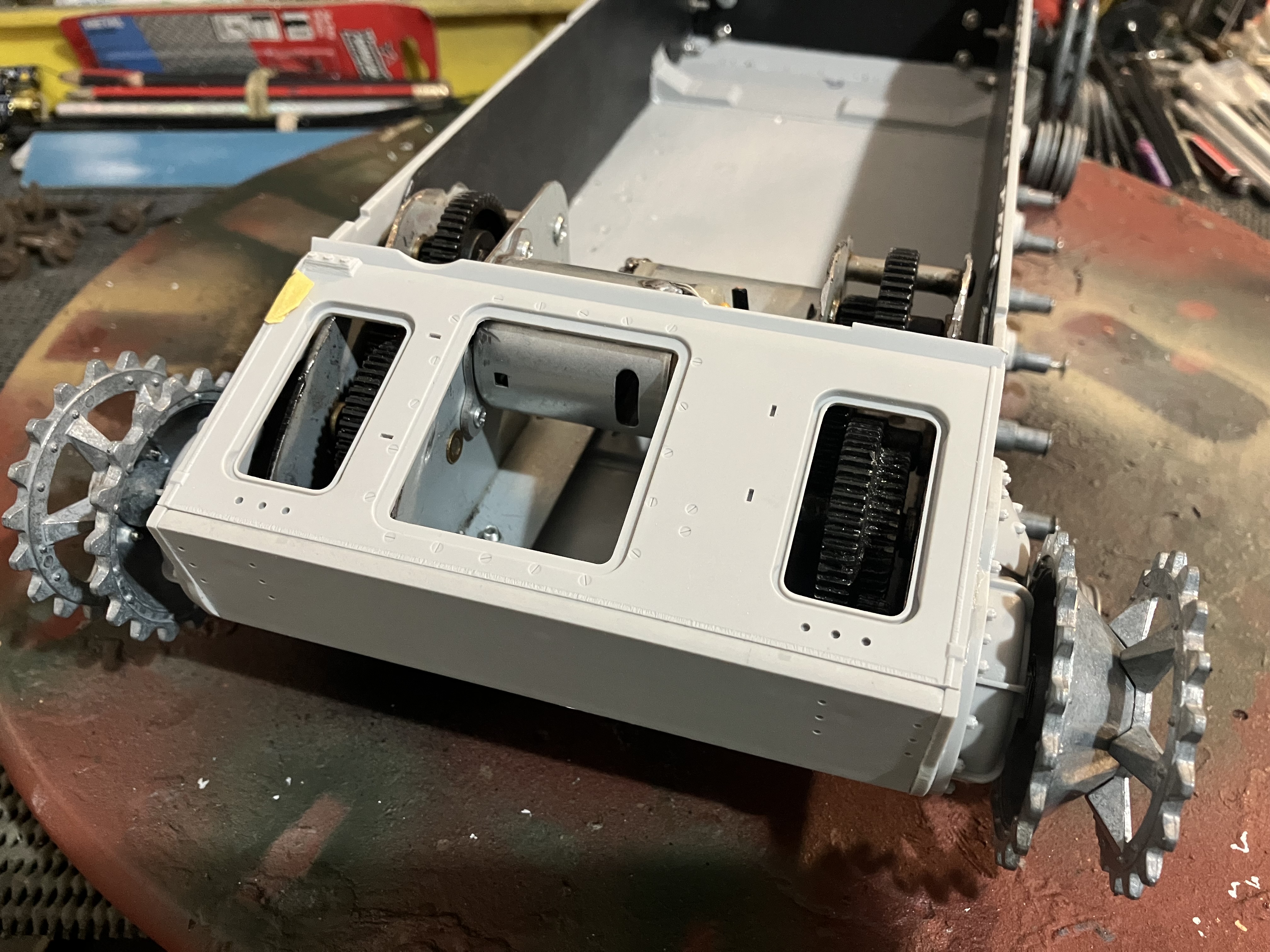

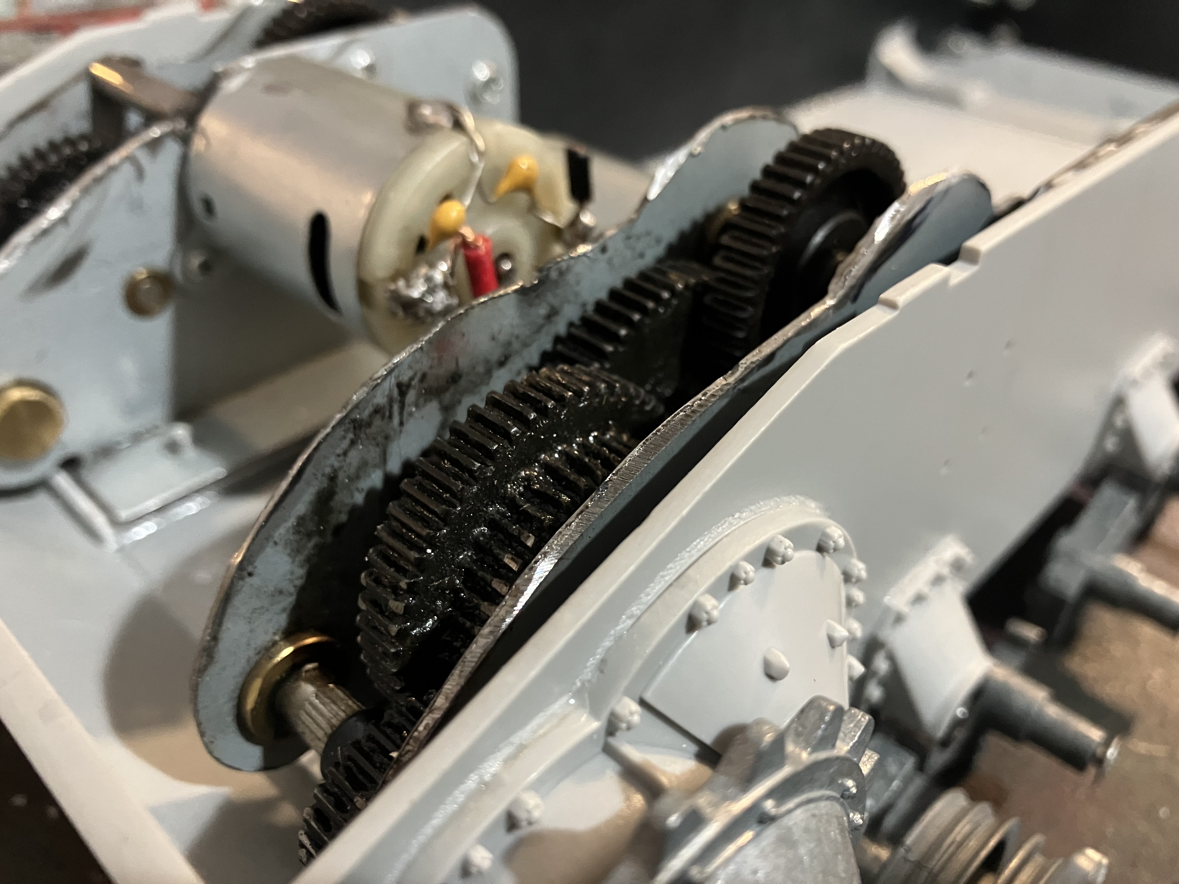

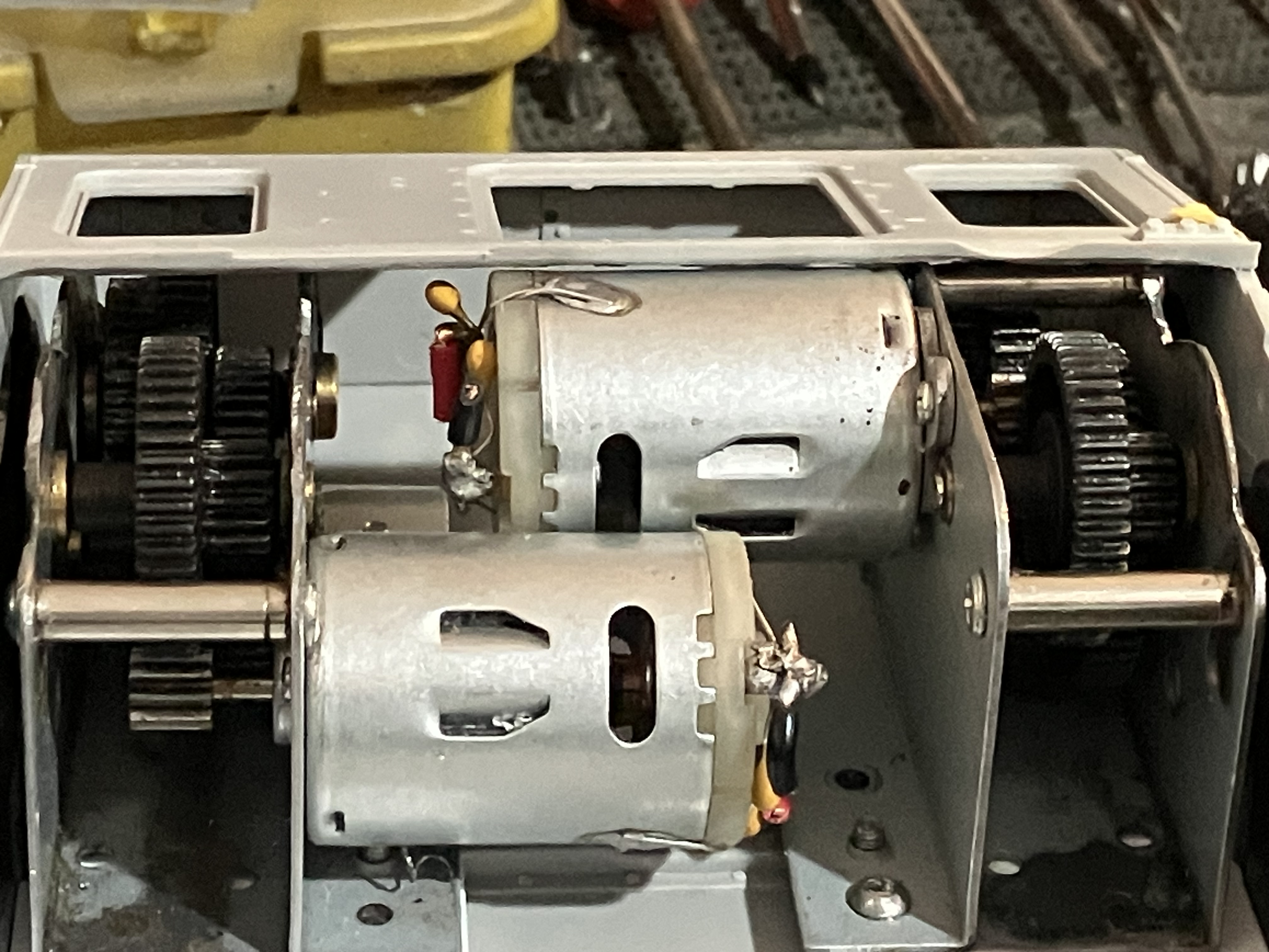

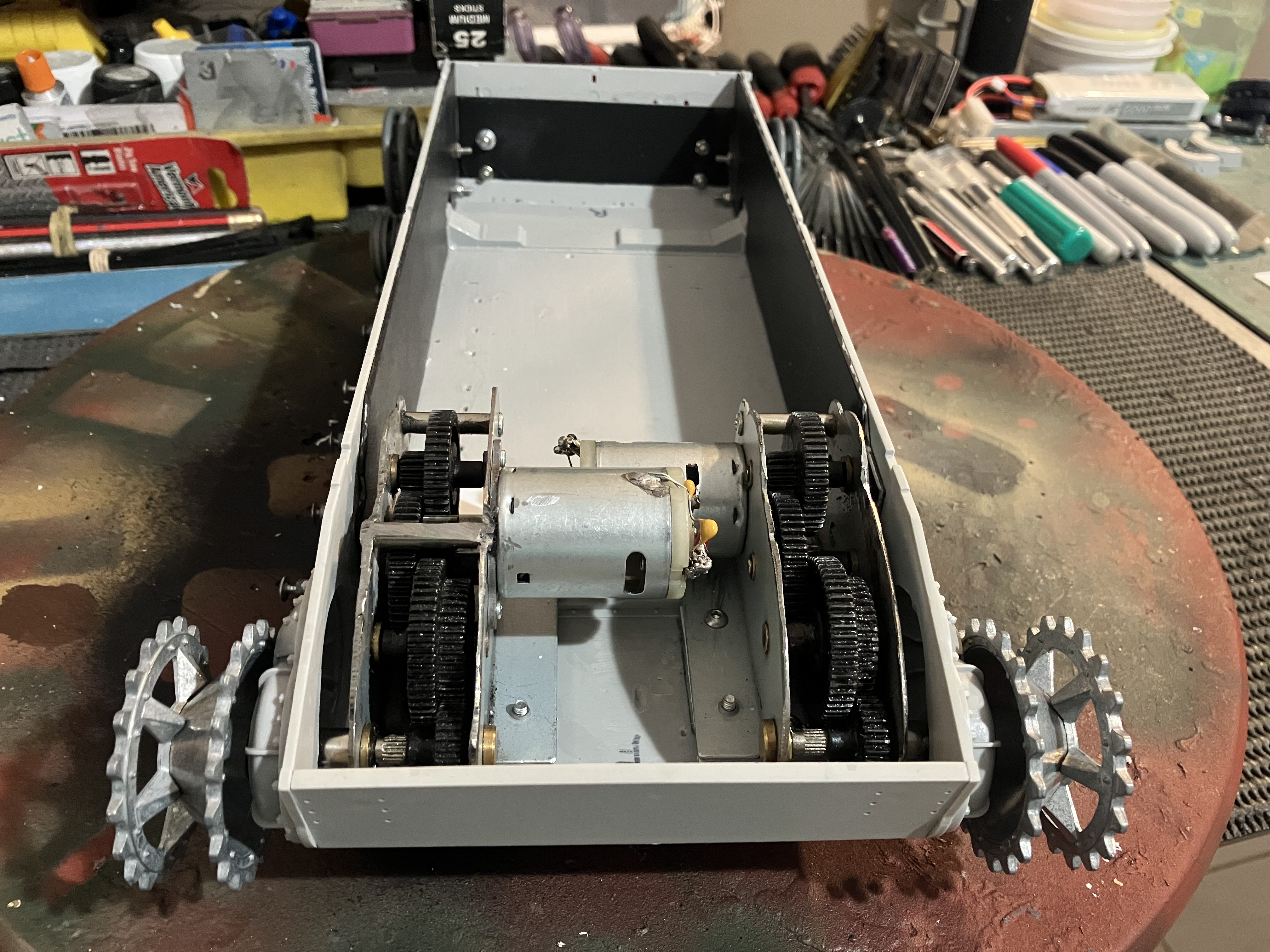

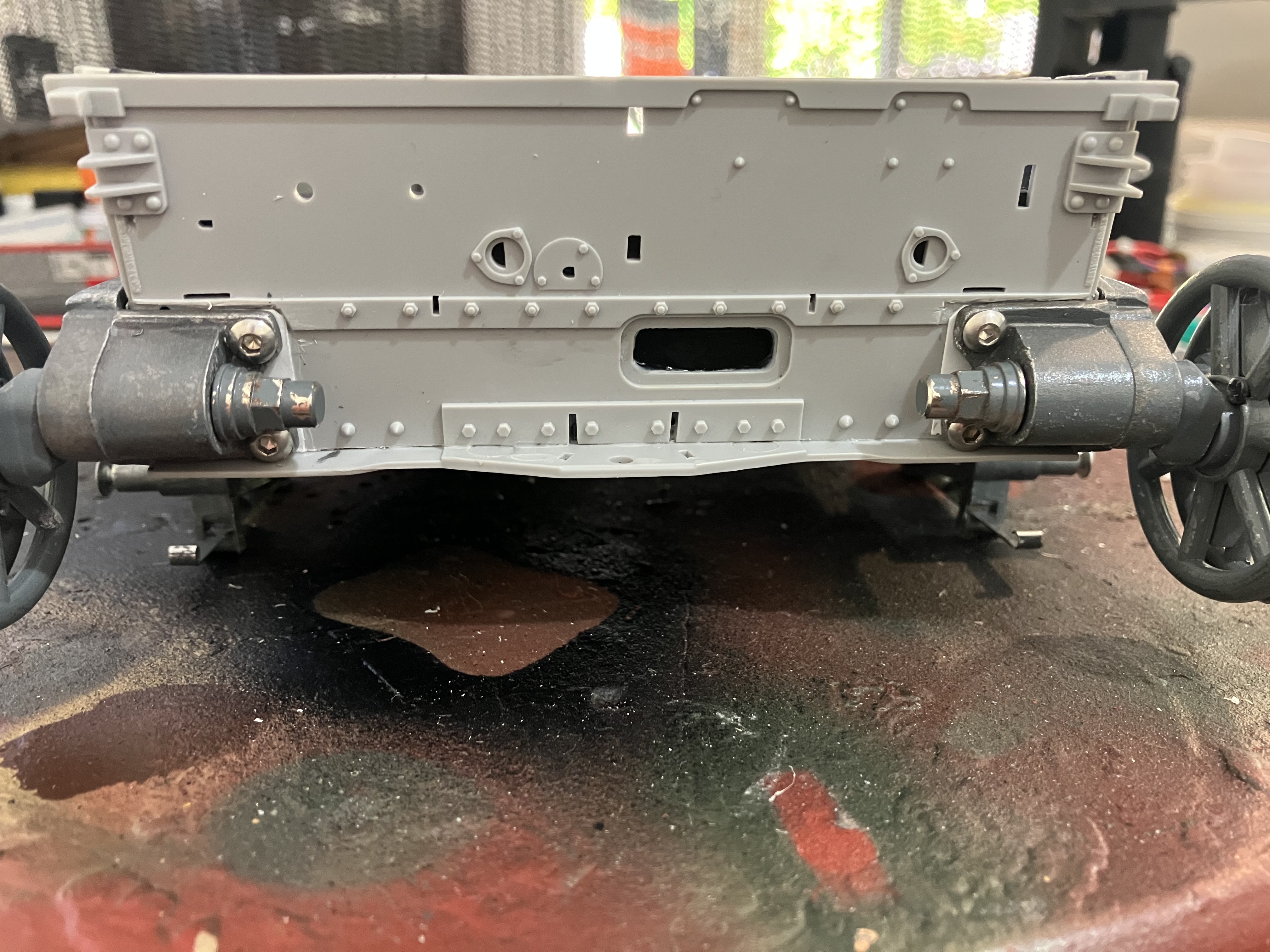

Lieutenant-General
Posts: 12010
Re: A LEAP OF FAITH
The boxes are in & dry-anchored.
Right side needs a bit more tweaking but its ok for a first go.
At least the drives are the right height not like the poor H/L or Taigen versions !! :/
Get a set of the low-profile gearboxes & its a fairly easy task to convert a static Trumpeter PzIV to Rc.

Mr Bix. That is a very neat install.

Well done on getting the gearboxes in place :thumbup:

Not surprisingly, the detail is superb compared to the RC tank company offerings. This is interesting seeing the process to make the conversion with lots of reinforcing. Does the styrene show signs of fatigue over time and use, or once it's reinforced it's good to go?

Now granted I know there's a lot of behind the scenes fitting and adjustment in between pics but You're making this look a bit too easy. Same question as Mike, with the reinforcements how robust does the chassis feel? Let's do a chart for comparison=
