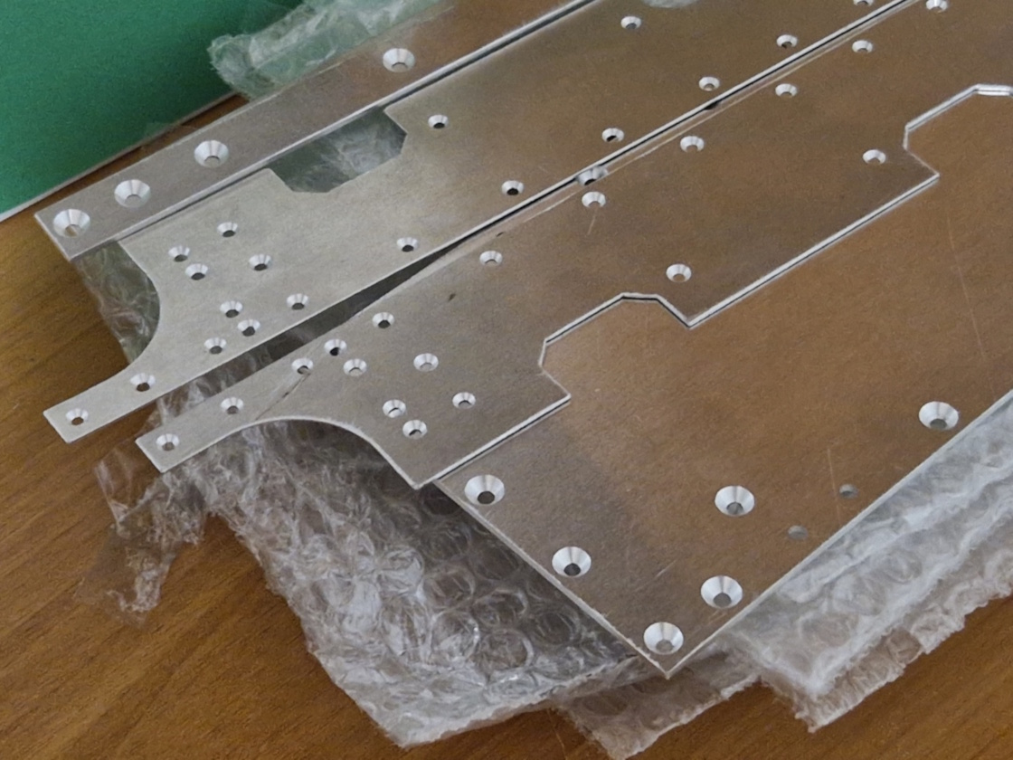

Since the space inside the printer is not unlimited, i had to split the hull in four parts. The hull roof is instead split in two removable upper panels, that will allow access to the electronics and gearboxes inside.
These seven aluminum sheets will reinforce everything for maximum stiffness.
So far everything looks fine:
I'll need to work a little bit on the metal sheets, but the real assembly process will begin soon.

The plates have been ground on the edges, holes have been tapered:
During the next weekend i'll focus on assembling the hull.

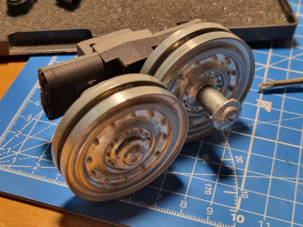

In the meantime, I decided to prepare some of the suspension bogies.
No torsion bars. Everything has been designed to look and work like the original entwicklungserie suspension:
Three bogies will be bolted on each side of the hull, true to the original design.
Here's the very first prototype of the bogie, but with double roadwheels to better spread the weight on the tracks:
In the coming days I'll prepare the remaining bogies for a future test-fit of the running gear.
