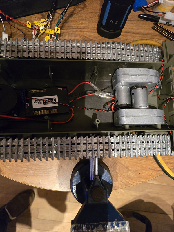

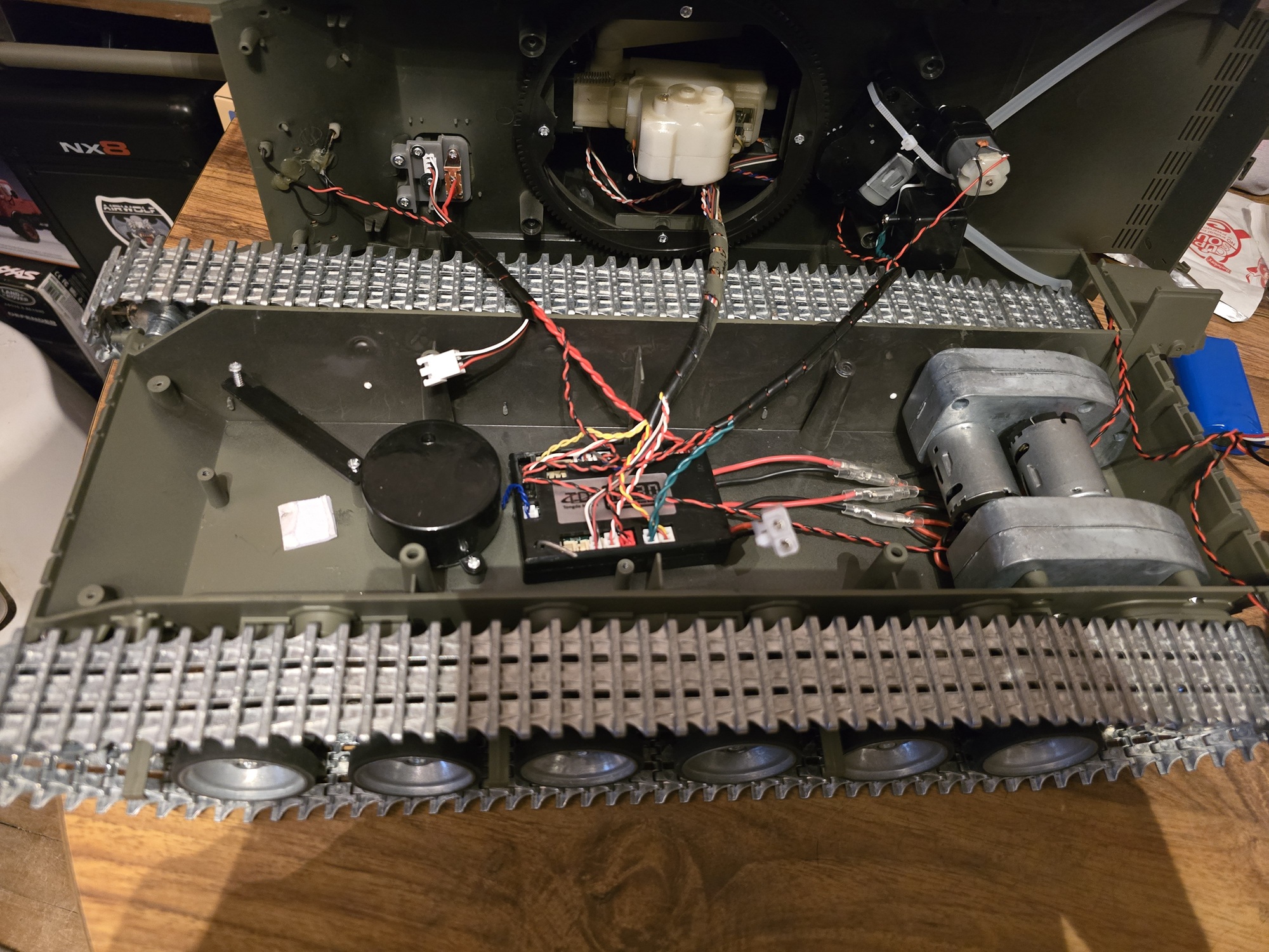

Tonight I opened her up and this is whats inside
After disconnecting and labeling the upper hull leads i changed out the 1800mah lion battery for a 6800mah battery
It was pretty easy as main leads had a Tamiya connector and the ballance lead plugged into a lead extender
I removed the Tamiya connector and put an xt60 on in its place
I was also surprised at the gearboxes installed on this model all metal enclosed
Tongde Centurion MK5

There seems to be a bit of acreage up front, perhaps for a bigger speaker or a secret stash of cash, hidden away for more RC AFVs.
- Stormbringer
- Posts: 1001
Re: Tongde Centurion MK5
The battery fits up front where the square of double sided tape is and the black plastic bar holds the battery in place
Theres another black bar further back that holds the mfu in place as well
but yep a bigger speaker could be fitted in
