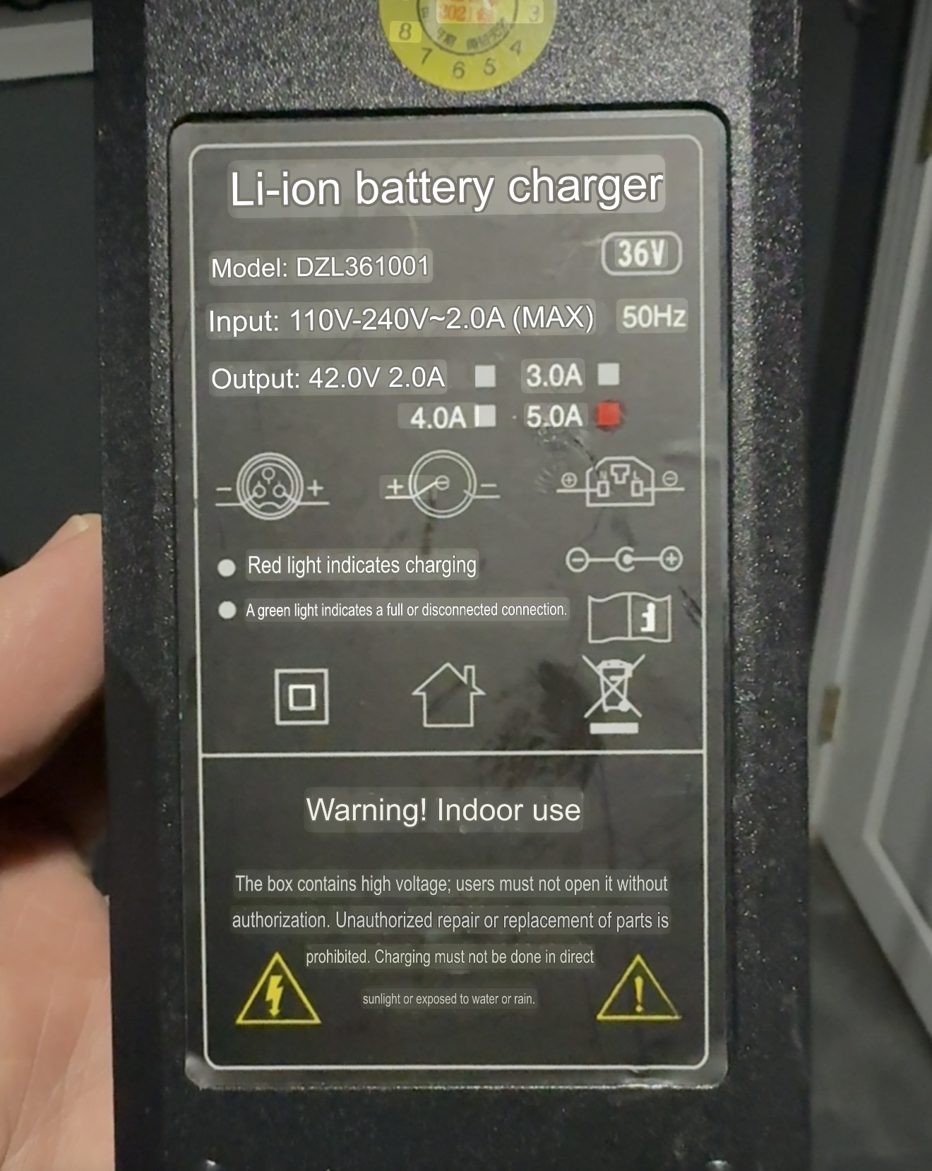

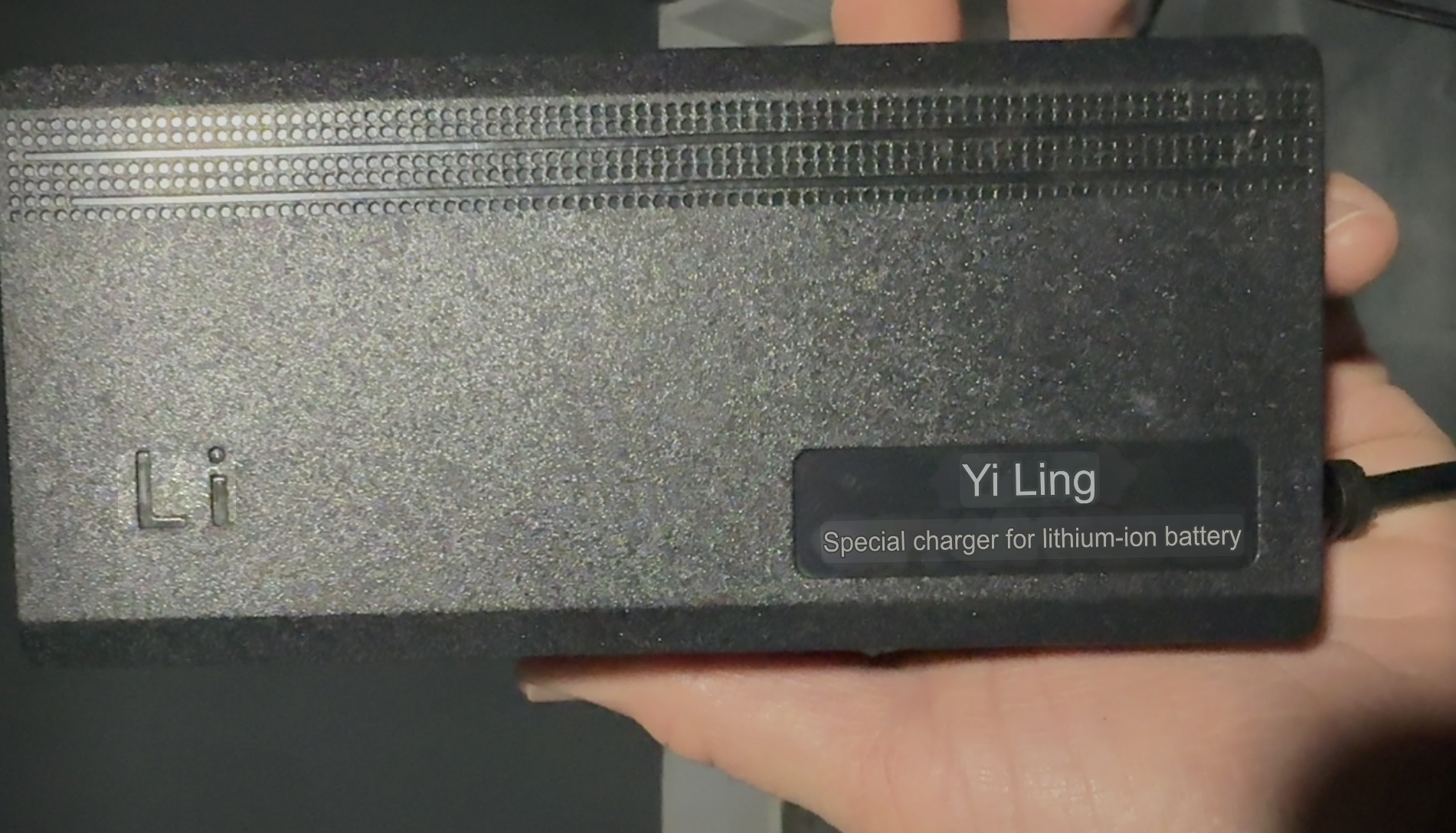

If I wasn’t an absolute dumb dumb I would've looked at the special charger they sent with it a year ago. I use this to charge the battery every time, but never thought to actually look at it. :headbang:
In my defense, it was all in Chinese, but that took Google Translate all of 1 second to solve…
So, the charger indicates it is for a 36v Li-ion battery, charging at 42V @ 5A
My bad. Mystery solved. At least I didn’t go through the work of digging it out of the model and stress of cutting into it before looking at the charger…
