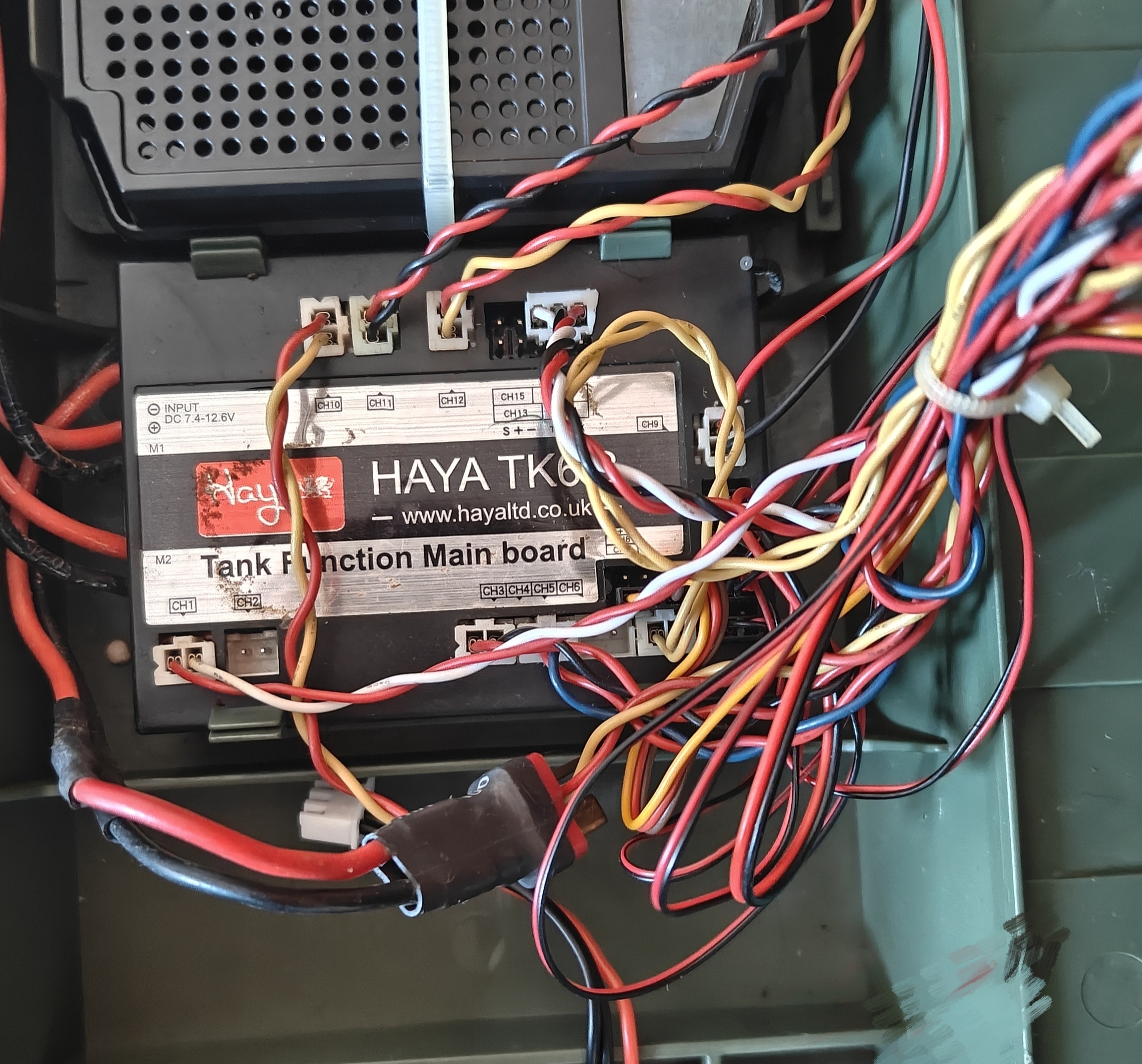

Hello everyone, I am currently renovating a second-hand Haya Chieftain tank, but it does not have a corresponding remote control.Can Haya's TK6.3 board use HengLong's 6.0 or 7.0remote control?

Haya's tk6.3 comes in 2 versions so which version do you have if it's the one pictured below it will work with a heng long 6.0 controller as it's just a 6.1 rebadged

Some of the remotes are the are the Canshuo brand. I just bought a couple of them for some of my CS-TK6.1 boards which are also basically slightly modified 6.1 boards. This one came with my Chieftain: https://www.henglongtanks.com/products/cs-rc61-tx-spf5
It will NOT work with a 7.x transmitter.

john1970 wrote: Sun Jan 11, 2026 7:44 pm Haya's tk6.3 comes in 2 versions so which version do you have if it's the one pictured below it will work with a heng long 6.0 controller as it's just a 6.1 rebadged
I use this version TK6.3

A 6.0/1 controller will work on that board
