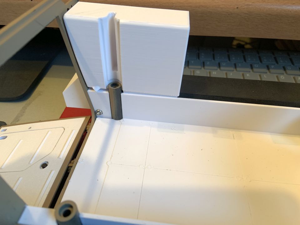

Derek, Hr. Dr. Prof., Alan and Mike,
thank you for your encouraging words.
The tailgate is now secured to the hinges with M1.6 screws.
The handle for opening the door is now in the correct position and functional.
Now let´s show some pictures:

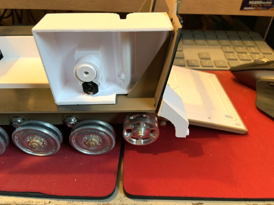

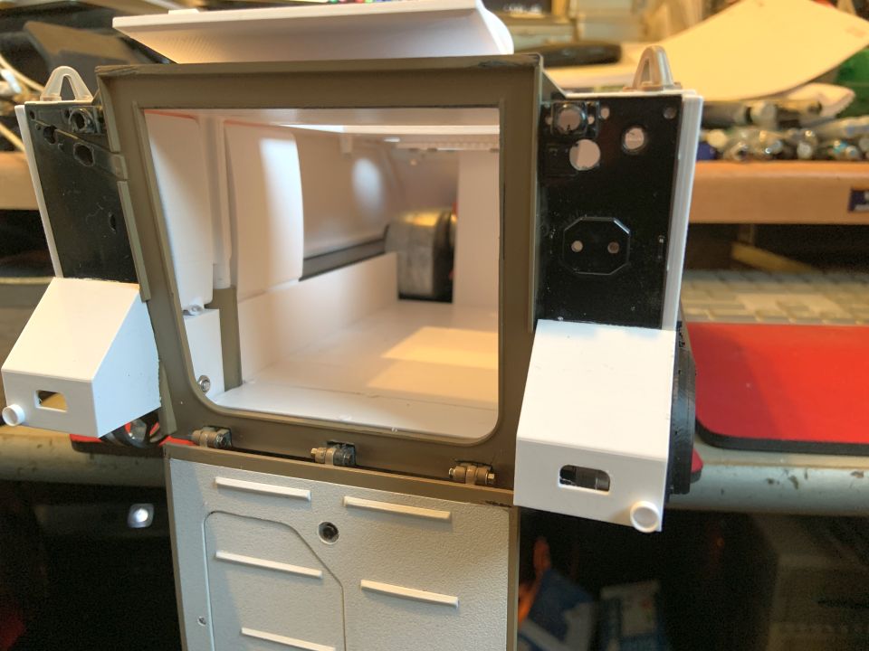

Tailgate - next Part...
How open/close the tailgate?
A little winch, hide in the fuel tank will solve this "Problem":

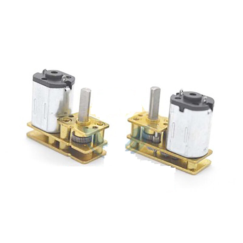

Ecam wrote: Mon Dec 01, 2025 1:04 pm My kind of build! Terrific work. Might have to find that winch....
I build the winch of a N20 Type Motor with 70 revs at 6V:
