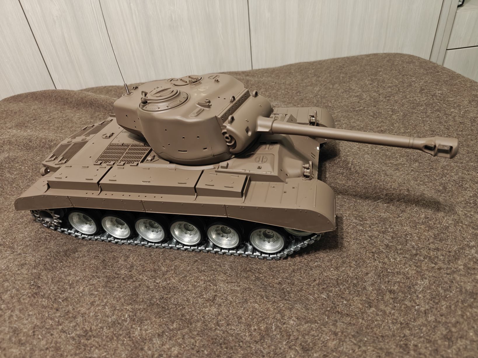

She's landed! Arrived from Toucan US warehouse. Has metal everything except shock absorbers. 360 turret. Function tested perfectly. (Unfortunately the extra battery has Tamayia connector.)
