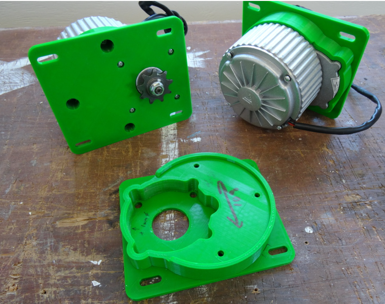

Now on to the motor mounts. I knew they were going to be an issue which is why the project stalled for so long. Then one day I found a set of motor mounts I had for set of motors I was going to use on my Dragon Sherman project. Since that wasn't started yet I figured what the hell. There they were on Thingiverse the whole time: https://www.thingiverse.com/thing:2855151

Taking those files into the Bambu slicer once again, I created a backing plate and a base plate to mount the motor to the floor of the tank. I left the oblong holes so that I could tension the motors once the chain drive was installed. I also drew up the spacers and printed them what are clamping on the motor.
Base plate under the motor
Motor and baseplate
