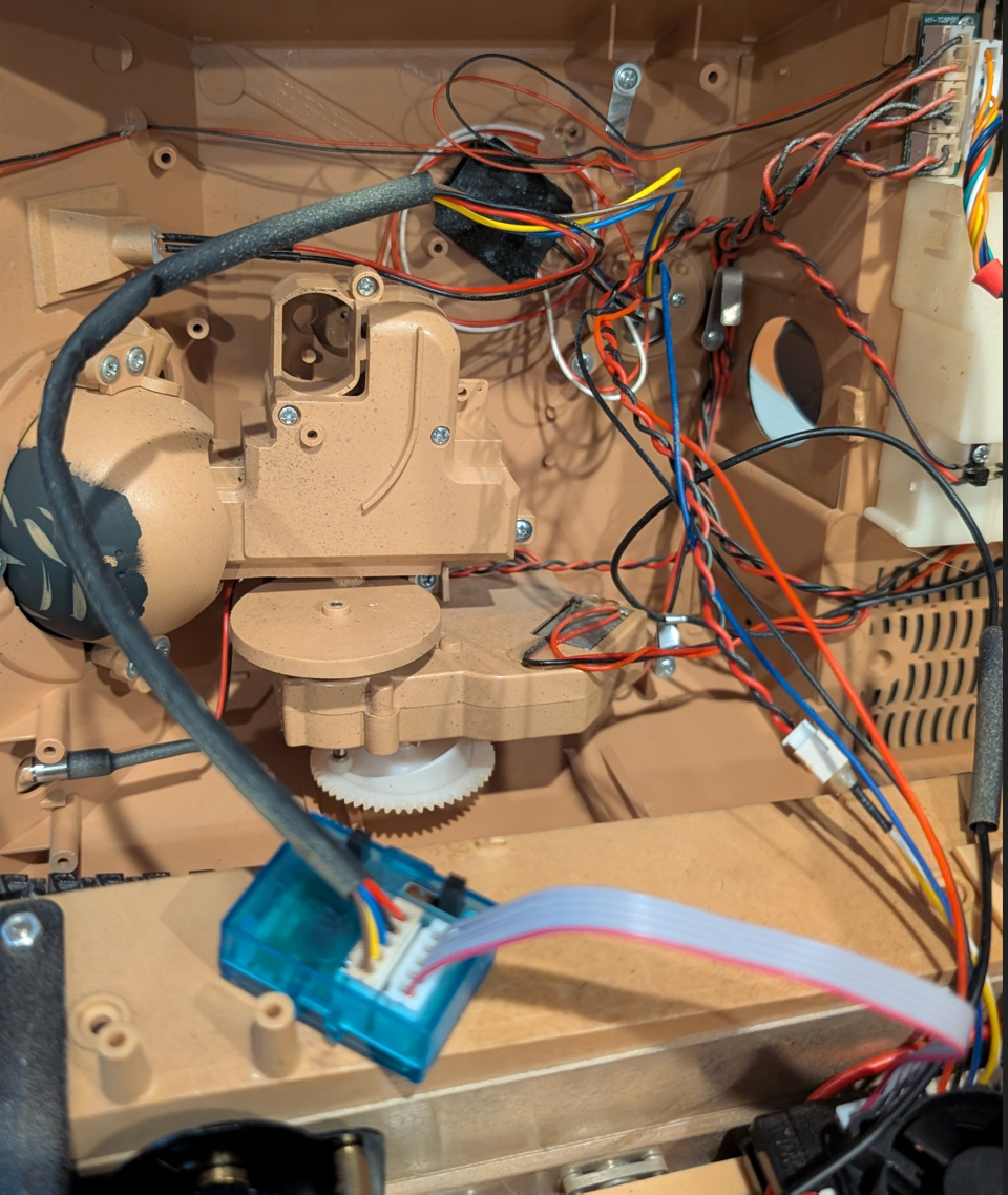

They actually make a converter board for the Torro/Taigen tanks so that they can battle with the Heng Long/Tamiya tanks. I have one installed in my Sturmtiger. Ignore the comment in the middle of the two pics. I pulled the pic from an old post of mine. You would have to wire a port for the "apple" on top of the tank and add an IR LED.

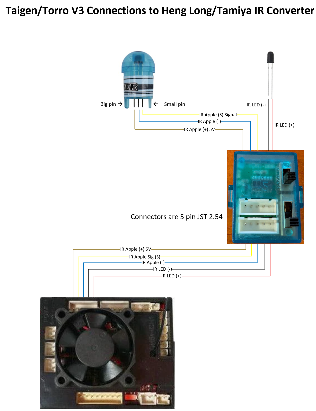

Nope not difficult to install the Torro IR converter as it does come with the "apple". It's a simple matter of plugging the IR converter into MFU shown in the pic I provided in the previous post. What would need to be wired is the IR LED and the connector the apple plugs into on the top of the tank as it wouldn't be wired for BB tank. I would assume the hole is there to mount the apple, but just no connector in it. You would need to provide your own connector or solder wires directly to the apple. The apple uses 3 of the 5 pins. The other two pins are for the IR LED emitter. No emitter is included with the kit. If your tank is already an IR version, it's a matter of unplugging the existing 5 pin connector on the MFU, plugging the 5 pin connector from the MFU into the top port, plugging the gray 5 pin provided with the kit into the MFU, and plugging the gray 5-pin connector into the bottom port of the converter. I also provided a pic of mine installed. See wiring diagram I put together below to equip a tank not wired for IR.
Converter wiring.png (700.95 KiB) Viewed 1361 times
