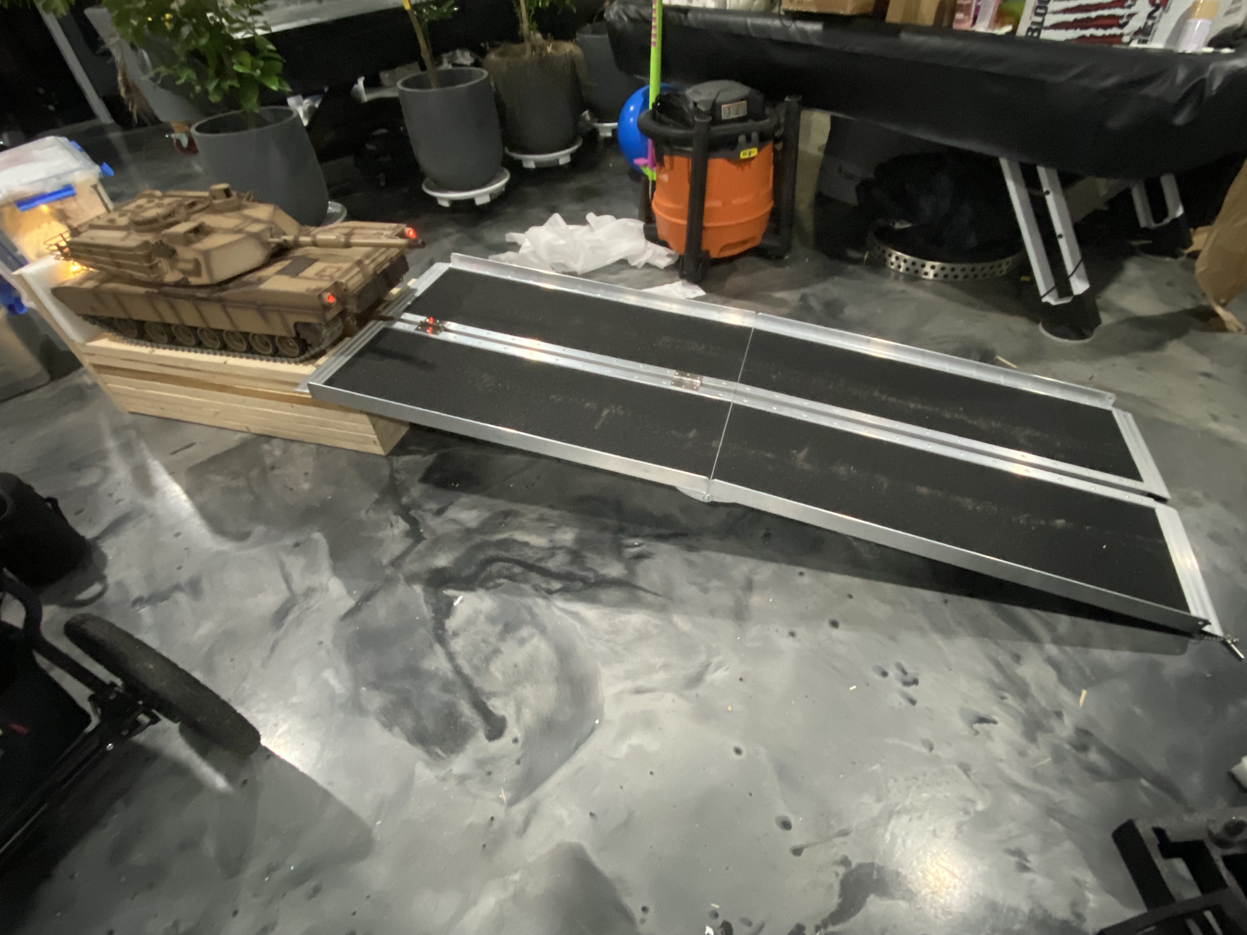

I bought a 5ft. wheelchair ramp for my bigger tanks to get them in the bed of the pickup truck. I made sure to get the one with the embedded sand texture to ensure the tracks had grip to climb the ramp. It's also one piece and it folds in half. I don't like the separate ramps as they can spread apart if you aren't careful.

Yeah I originally got a wheelchair 5ft ramp, but with my truck it ended up being a 45° incline, so I’ve got a 7ft one coming tomorrow.

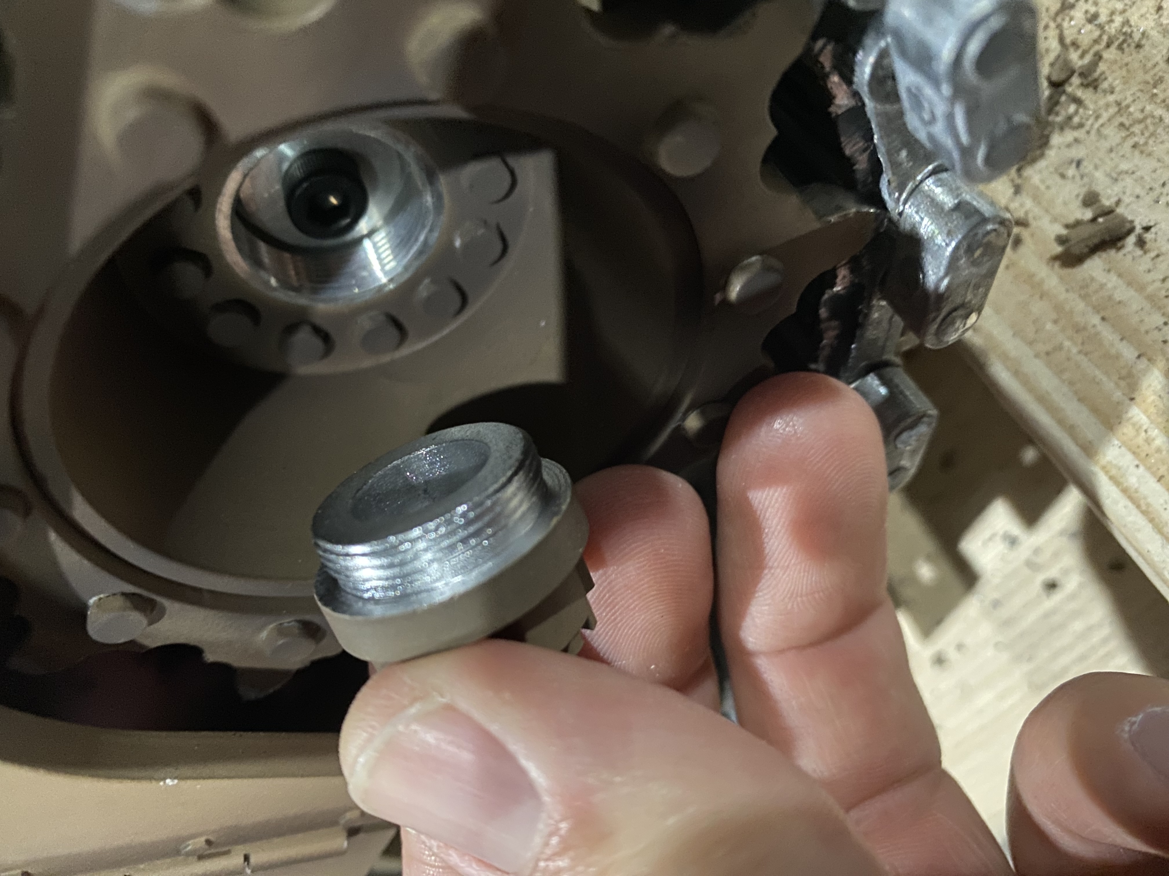

The hub caps are actually threaded, which makes getting to the wheel screws nice and easy. That’s about the only thing easily access.

- 7 foot ramp leading up to my blocks I built
- IMG_5469.jpeg (1.26 MiB) Viewed 2086 times

- Threaded hub caps

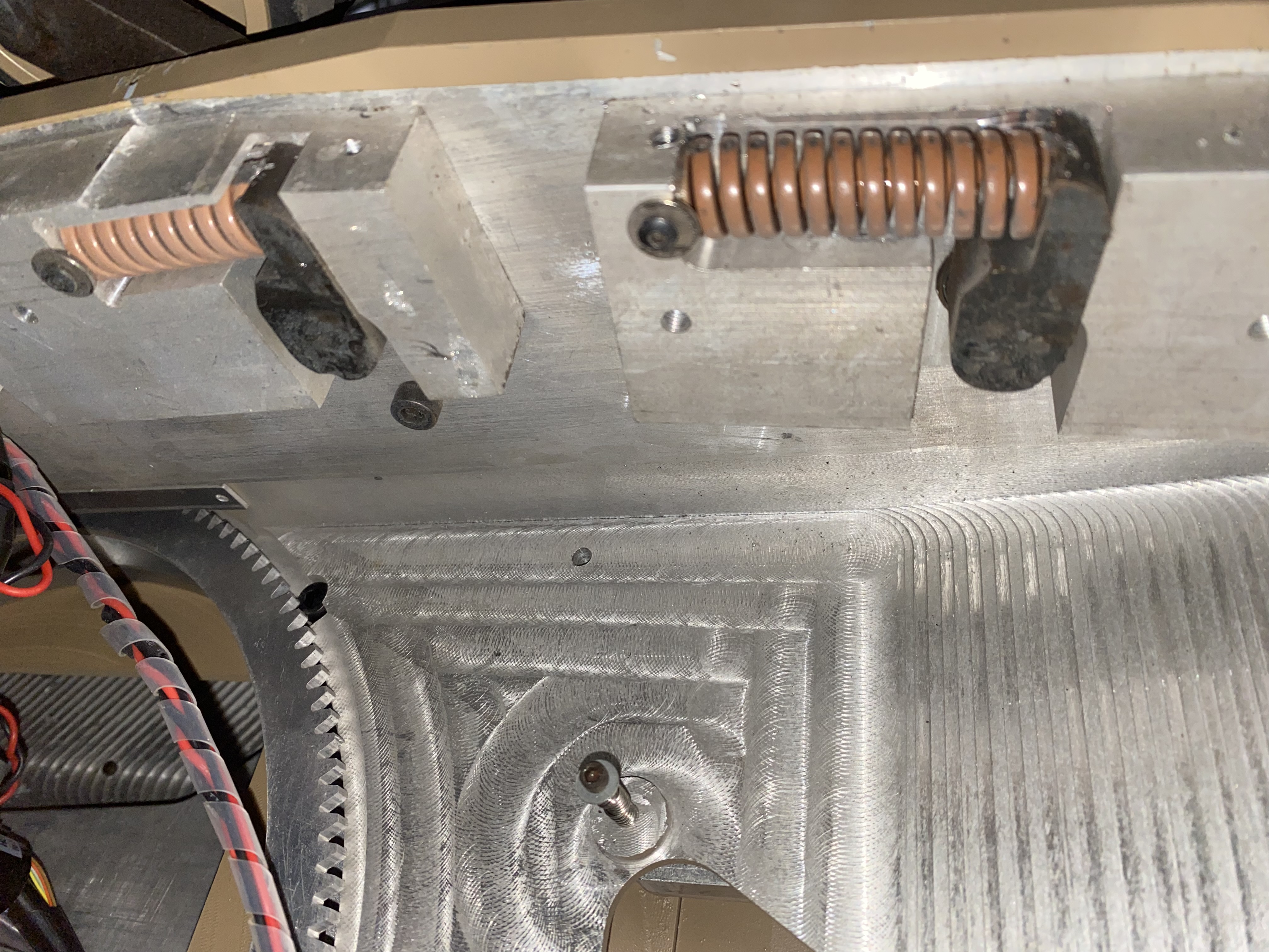

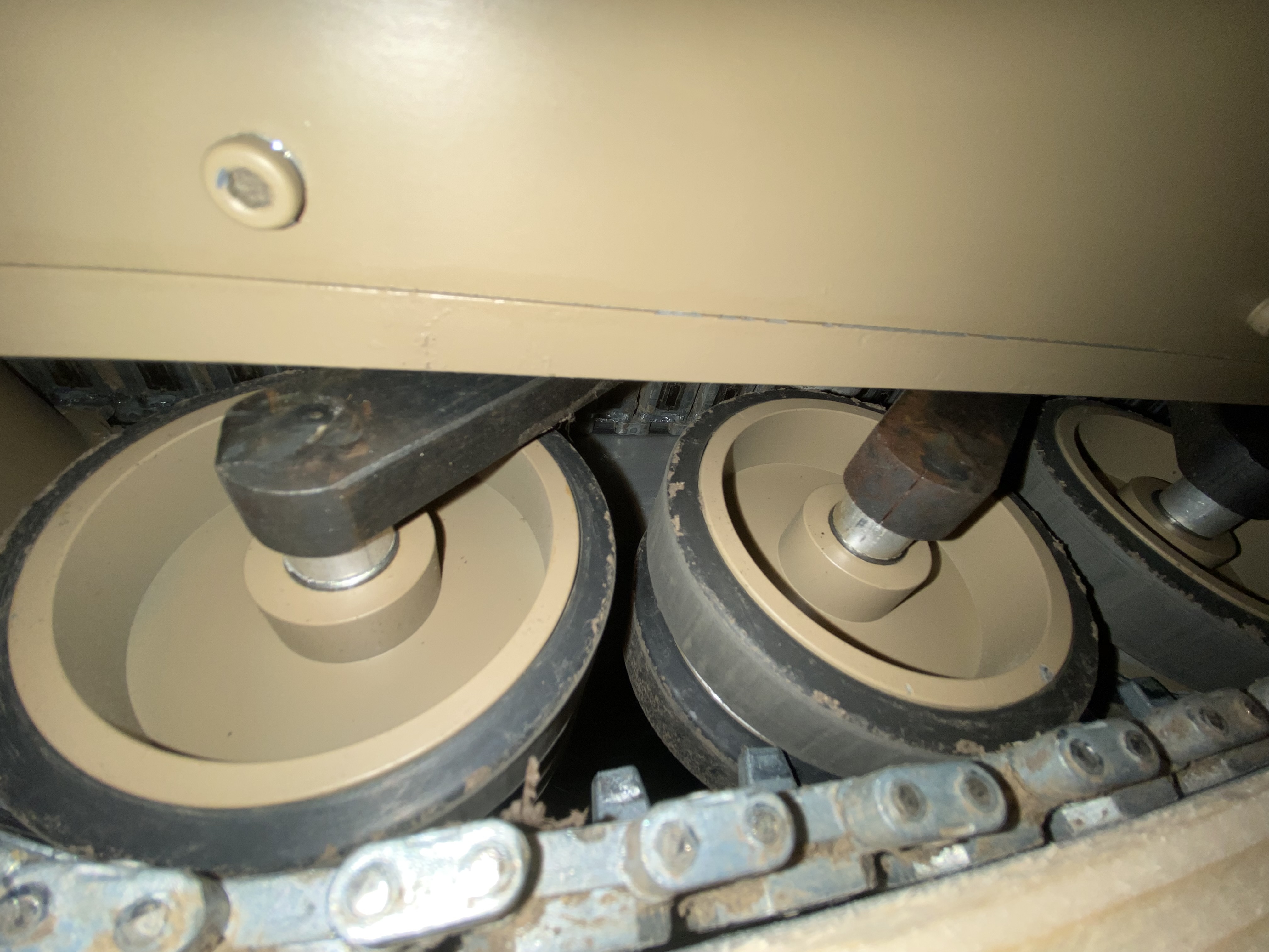

- Swing arms look kind of janky
- IMG_5478.jpeg (1.65 MiB) Viewed 2086 times

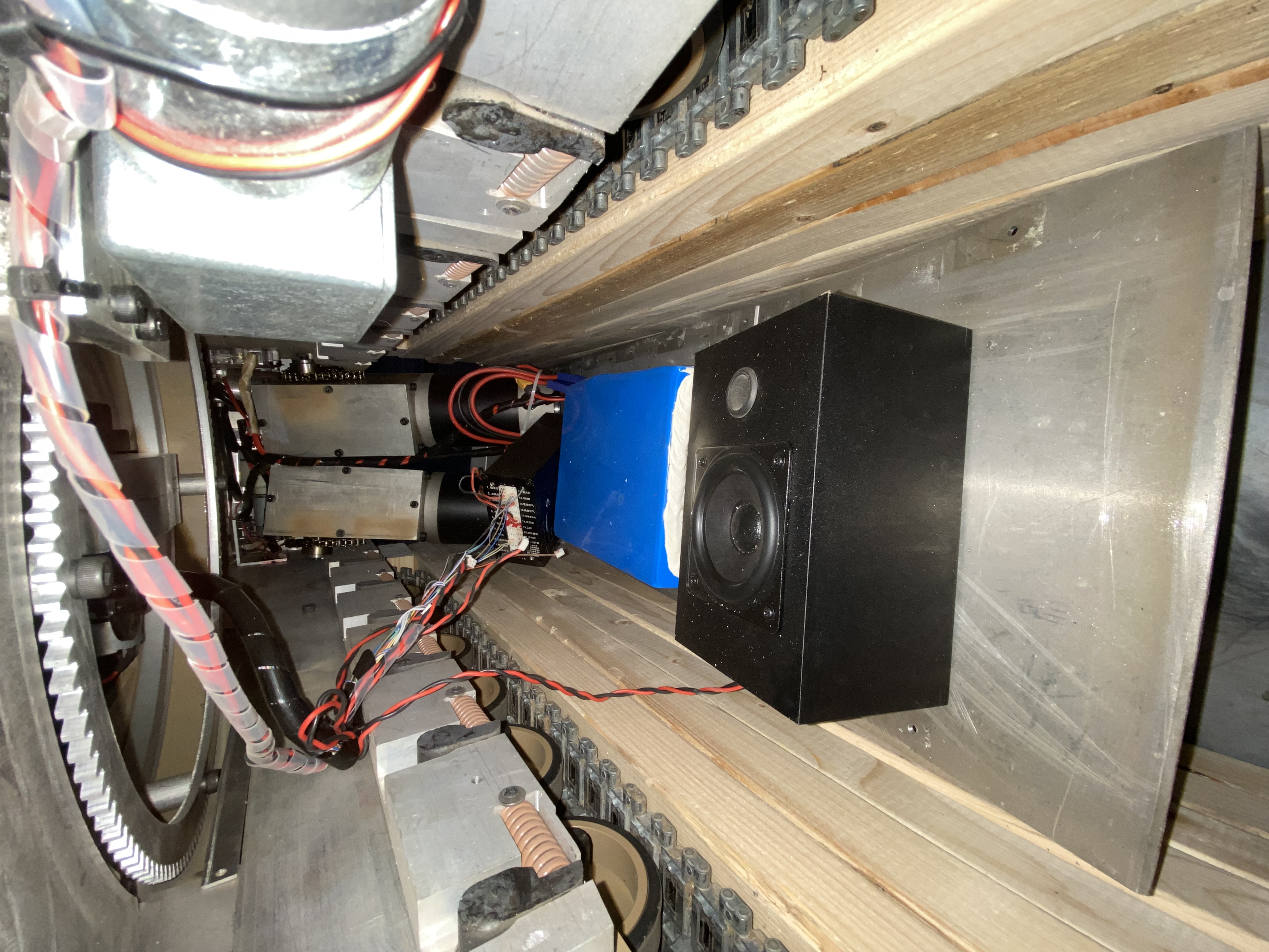

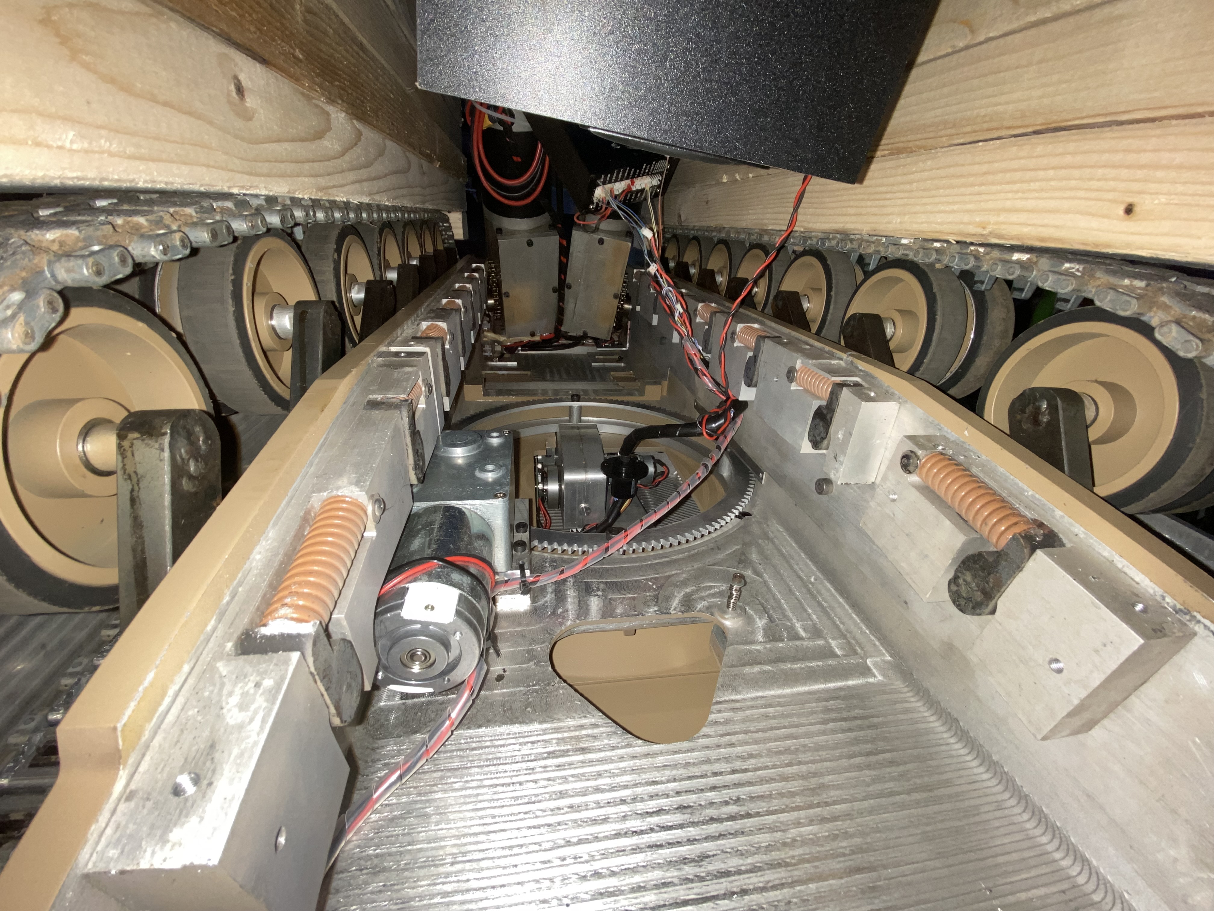

- The inside, from underneath. You can see the sides look fused to the upper hull. Because of how the bottom drops out, no torsion bars. In the foreground is the travers motor, in the back the drive motors.
- IMG_5479.jpeg (2.35 MiB) Viewed 2086 times
- On the floor plate is the speaker, battery, and MFU
- IMG_5480.jpeg (2.13 MiB) Viewed 2086 times
- Looks fused. There’s the spring for the drivers hatch.
- IMG_5482.jpeg (2.46 MiB) Viewed 2086 times

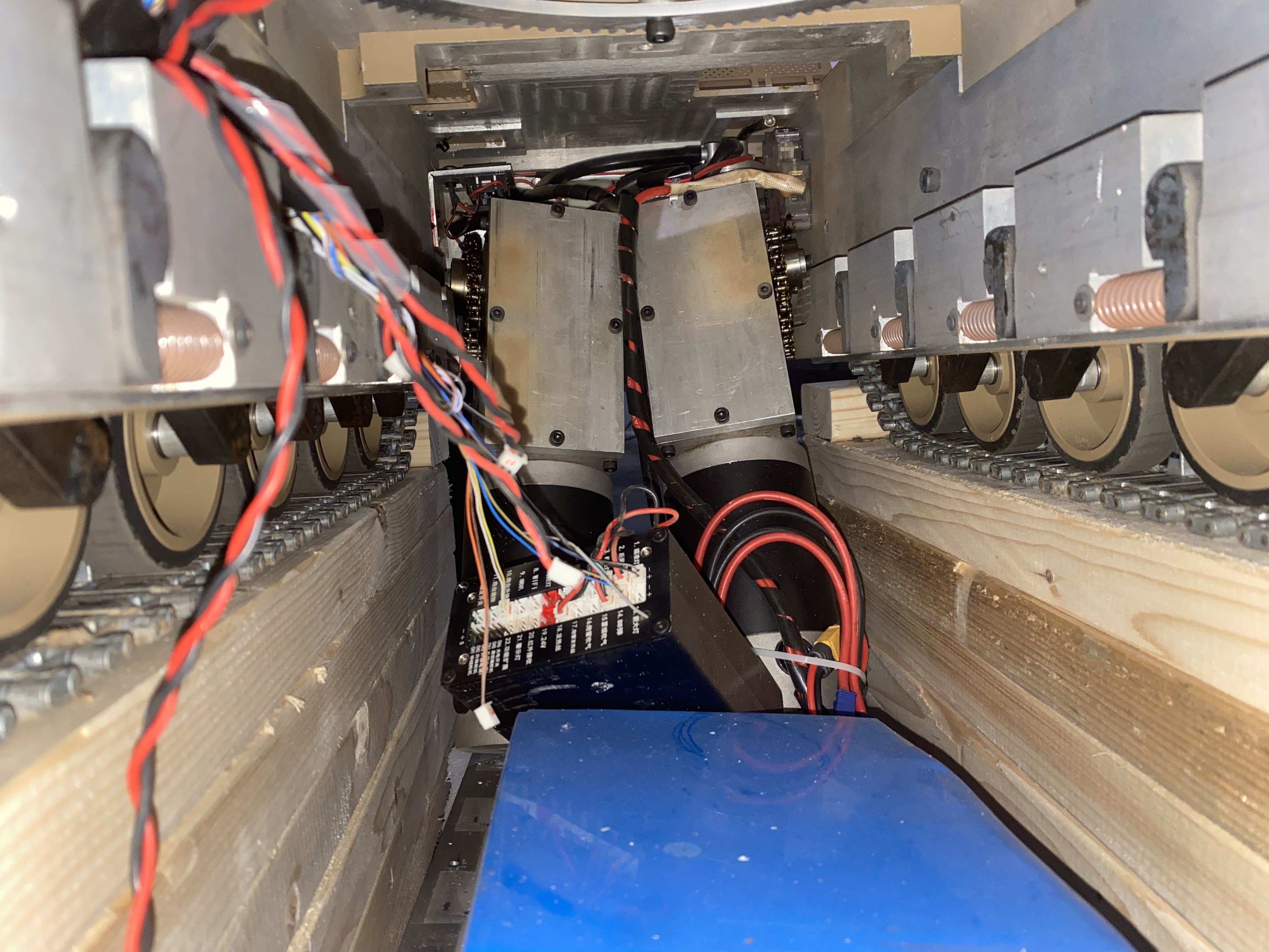

- Closer view of the MFU and drive motors. TK8.0?
- IMG_5485.jpeg (2.19 MiB) Viewed 2086 times

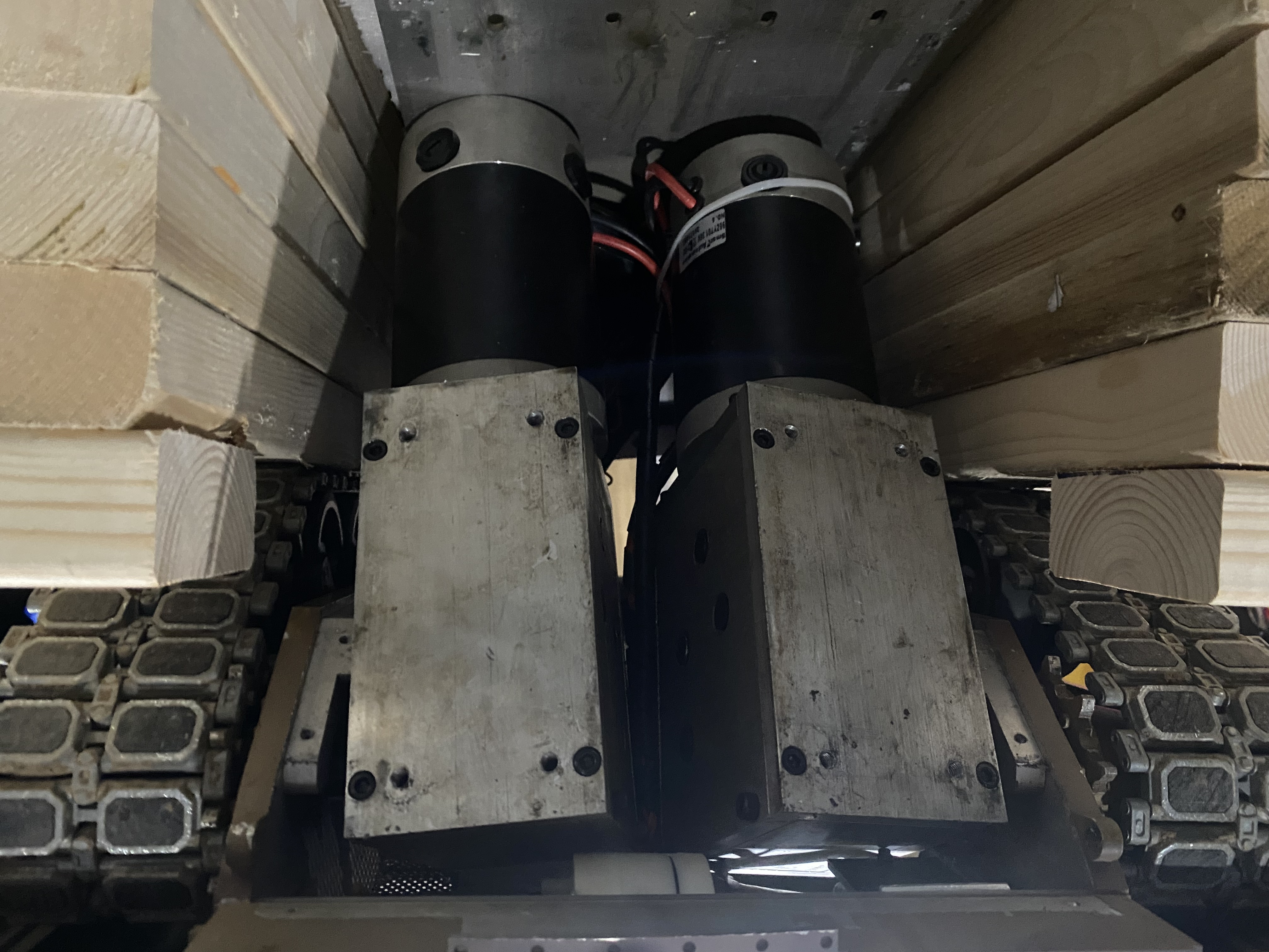

- Motors viewed from the rear
- IMG_5486.jpeg (2.04 MiB) Viewed 2086 times
