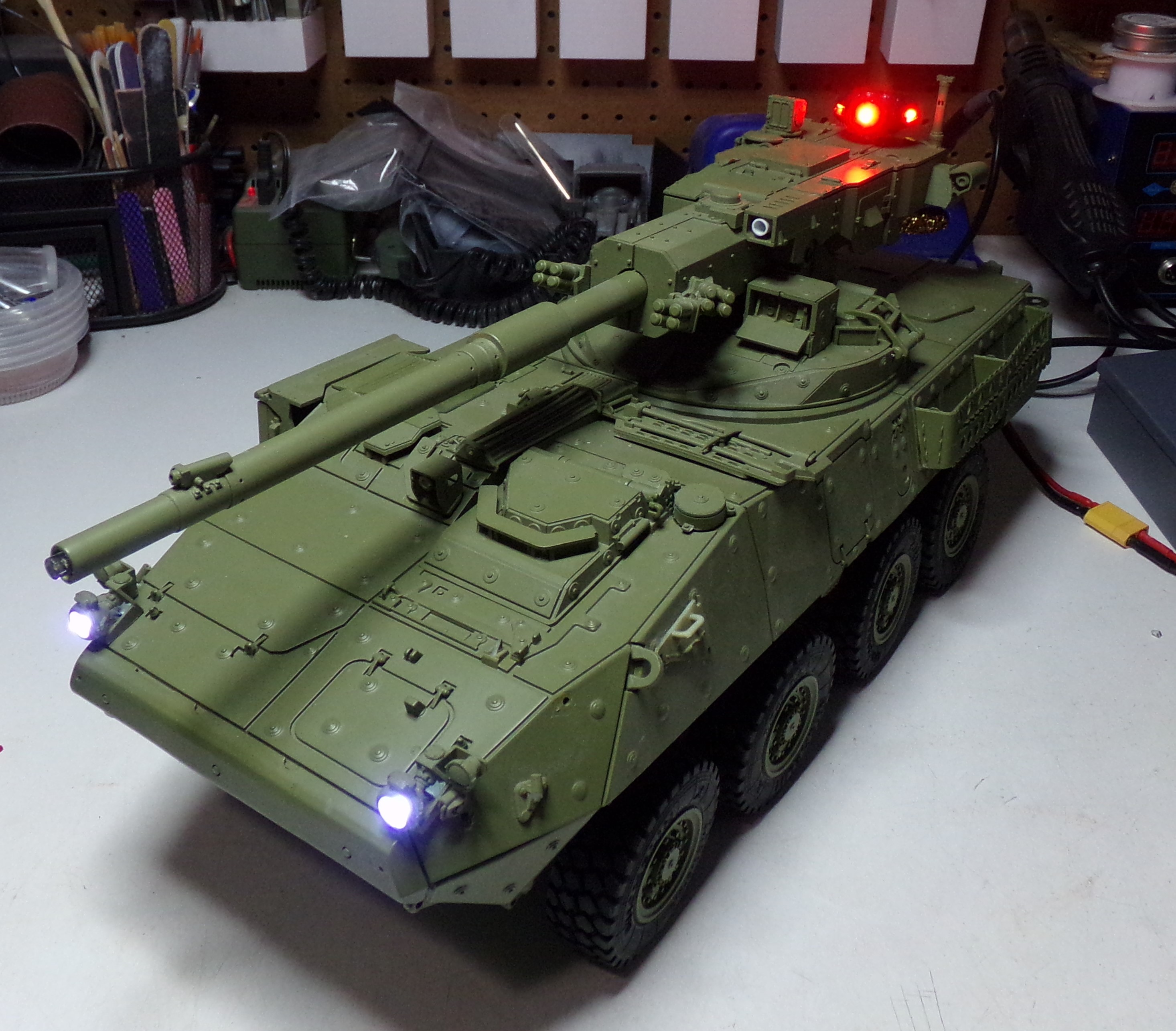

It's going to need some work to make it more durable as it seems to be 3D printed. The front four wheels steer. It is an 8x8 with suspension although the front suspension doesn't work quite as well as the rear. Was it worth the money...probably not, but it is the only Stryker on the market currently. All the hatches open. The top turret cover and rear cover for the battery are held on with magnets. I haven't put all the accessories on as I am going to be breaking it down to make some mods to it. It came with a HL version 7 control board and transmitter. I haven't fired it up yet as I need to get to bed...
More info later.

:clap: tankme: I will be interested to see what you do to beef up the Stryker. The suspension mechanicals, the electronics and motor (one?) certainly seem neatly packed in there. There also appears to be adjustable steering caster, definitely good. There are lots of interesting details hanging about the hull. Is that "NATO" green? In the photos it seems almost to be WWII OD, not even the somewhat darker post-war OD--but of course, photos put on the internet go through umpty many color changes, so one cannot make much of the color.

At this point I won't recommend getting yourself one as I think it's going to be a long project to make it strong enough to stand the Texas heat. Think...Rich's M60 or his Hooben Merkava when you think of buying one of these. It came with zero instructions, no markings, and painted in the wrong color green (more like a spruce green - too much yellow). It does have space for a battle system in the turret which I will be adding. I will be adding a barrel flash and I haven't seen an IR emitter yet so that might need to be added also.
I believe this was only 1 of 20 that was in the pre-order (it's marked #7). Stanlley went out of his way to make sure each one was good to go before sending them out. Apparently each one had QA problems as he received them. He worked with the factory to get what parts he could and tested each one. I appreciate that and that didn't go unnoticed. Mine arrived with only a small break in the rear tail light which is easily glued back on. I'm sure with the issues he had with them, he won't be selling any more of them.
I should be able to plug it in to a battery and do an initial functions check tonight when I get home from work. The Heng Long controller is just a standard v7 handset. Being that everything is servo driven, I'm sure the control board has to be a HL 7.1, but they removed the cover from it so it has no label right now. It does only have one motor, but it looks to be a geared 550 from my calibrated eye. The steering angles can be adjusted.

Finally got around to adding the flash to the barrel using a standard 5mm flat front white LED, added a Vishay TSAL6200 IR LED in a space next to the barrel, and a HL version LegoDEI apple. Besides coming with a 7.1 board, it has a 7.1 controller as the trim switch on the right stick is functional. It must be a really early 7.1 transmitter and it says 7.0 on the back unlike my new 7.1 that says 7.1 on it. Being a wheeled vehicle it actually acts as a trim for the front wheels. I also fixed a cracked suspension mount with some UV resin that it had since I got it which is why I've never bothered to install the battle system. A battle system doesn't do any good in a vehicle with a broken suspension mount. I finally took it out to our local battle day this past Saturday. I've been bad mouthing this thing for so long sitting on my shelf at home and surprisingly it worked great. Nothing broke and it zipped all over the battlefield. Still can't recommend anyone buying it from Hooben as they are now the ones reselling it from Kootai RC. I still think it's way over priced for what you get because the material it's printed from is brittle and heat sensitive. There is a section of lower hull under the rear side skirt that is warped, but luckily you have to know it's there to see it.

Derek, I most sincerely congratulate you and admire your skill at getting an eight-wheeled coordinated steering vehicle to run so well. I sometime open my Puma kit and cringe at the thought of even starting. Bravo!
