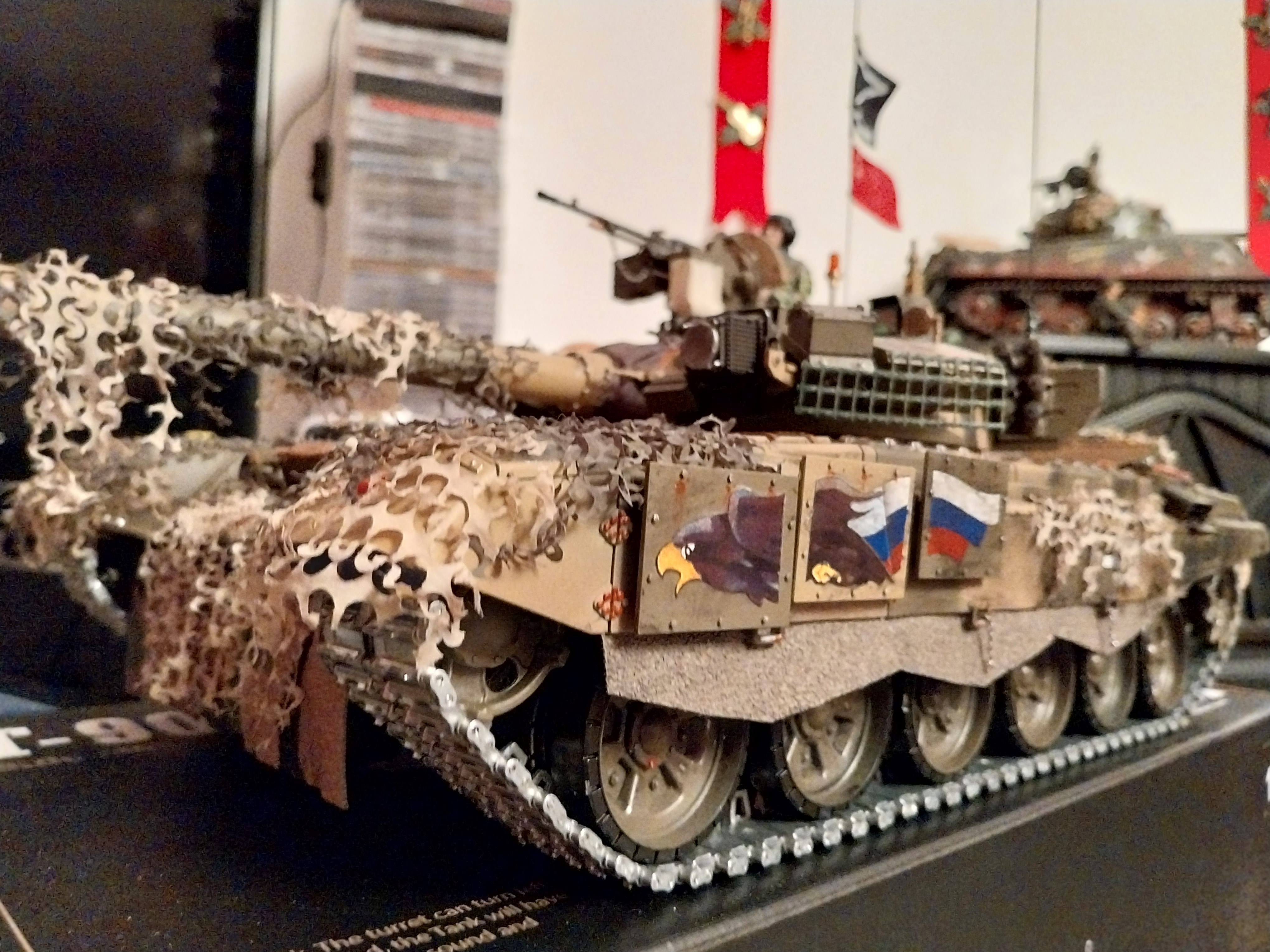

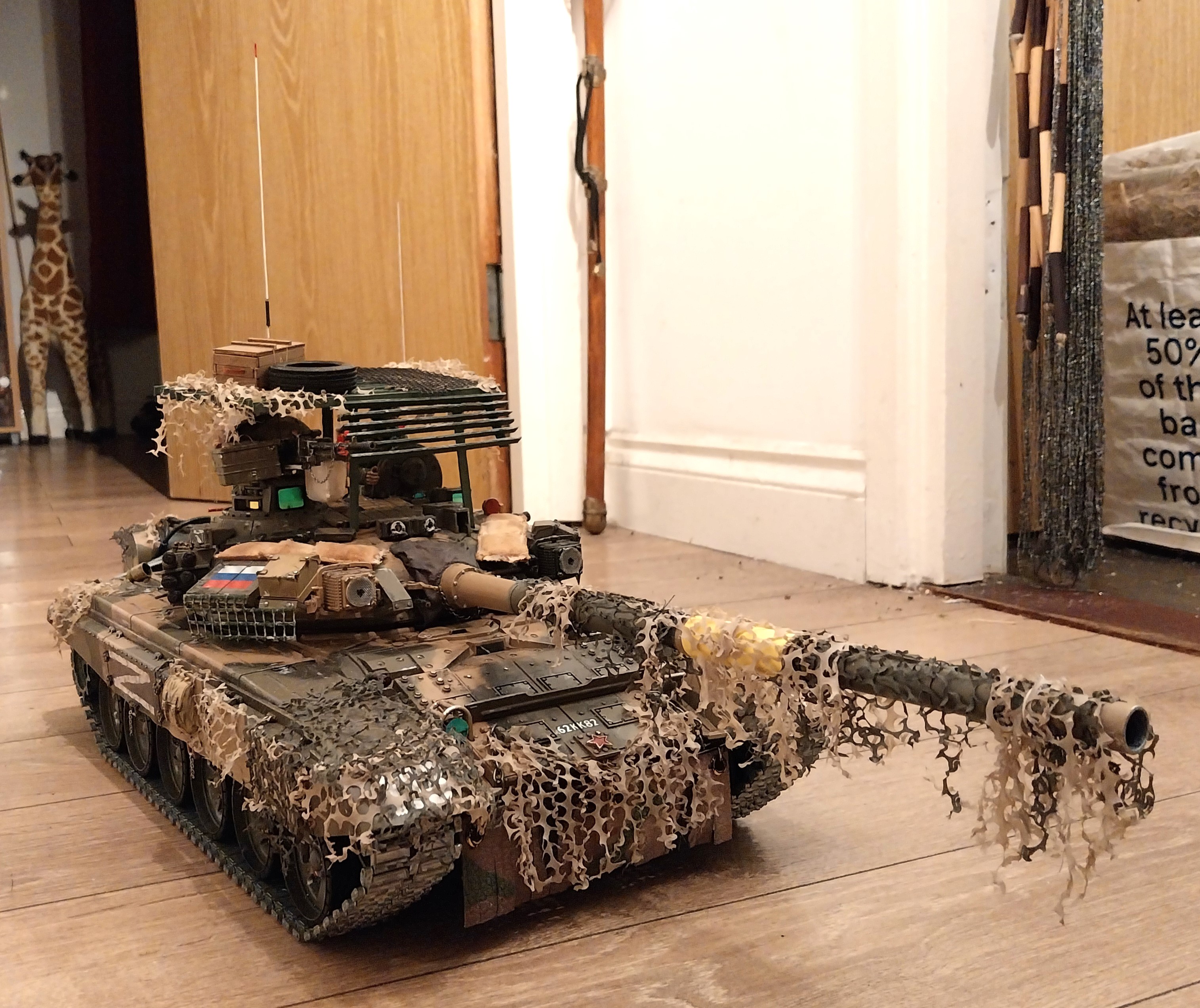

:think: Hi Zooma from newbie Redballrunner73.. I ordered my Heng Long/Torro T-90 (6.0s) just as the Ukraine conflict was getting more media coverage, have grown to really like this tank after fixing (i think) the issues with the right track not staying on by using the Haya T-72/T-90 metal 2 pin tracks with Heng Long metal sprockets/idler with bearings, and made the tank look truer to original. I jumped the gun and started to add detailing/t-90 stickers/eagle stickers etc before proper research and have since removed these, added the cope cage and front skirt but am now thining do I keep the camo' paint scheme which I do like, or strip back and go green? as this looks good also.. ah decisions decisions :think:
before..
before..
..After (for now??)
..After (for now??)
Posts: 6228
Re: Heng Long T90
"[D]o I keep the camo' paint scheme which I do like, or strip back and go green?" Good grief! This is false dilemma. Egad! You keep this one and start on another one in the green scheme. Jeepers, I almost had a heart attack when I read above. Phew!

Post by zooma »
I think your T90 looks really good, and I too like the colour, although I have since learnt that the large side decals only relate to one tank that was used in some sort of tank competition. I will keep the colour scheme on my T90 and try to find out if it was actually used in combat - or if it was only a "promotional" paint job used on a "one-off" competition tank, but (sadly) I will not be fitting the (very attractive) "eagle and flag" side decal.
The "dessert" type colour scheme really does look good and I am hoping that it was not just an imaginary one that Heng Long dreamt-up. If it is a non-authentic colour scheme I would still be tempted to keep it as every other tank that I have to date is GREEN - and this one makes a nice change!
My T90 was a basic budget version and I have not even upgraded the plastic drive sprockets yet, but I did buy a pair of alloy sprockets at the time from forgebear that I intend to fit along with an extra outer bearing to the drive axle for reliability.
The alloy sprockets that I bought do not have the additional "guide rings" to help keep the metal tracks on. I am not sure how important these guide rings are. I have some large steel washers that I can modify to fit the metal sprockets to act as 'guides" if I feel the need - but I will be running my tank without them to start with using the basic plastic tracks. If/when I fit metal tracks I will see how they perform and make some guide rings to add to the metal sprockets if they are needed.
I really like your extra detailing. I have not seen any pictures of a turret "cage" fitted to a T90 (I would like to copy one and add it to my T90), but yours looks good and when I have finished building my HAYA Centurion kit I will return to my T90 as I need an "opposing forces" tank - and I really do like the look of the T90.
My own future research will include trying to find some pictures of T90 tanks with a turret cage. These turret cages (like you have fitted to your T90) are now in common use in the current conflict in Ukraine and I would like to make something similar to fit my model
Your tank looks far too good to strip it back for a repaint. If your tank were mine I would NOT strip it back - if you really fancy a GREEN T90 I would buy another one and paint that one green instead.........
