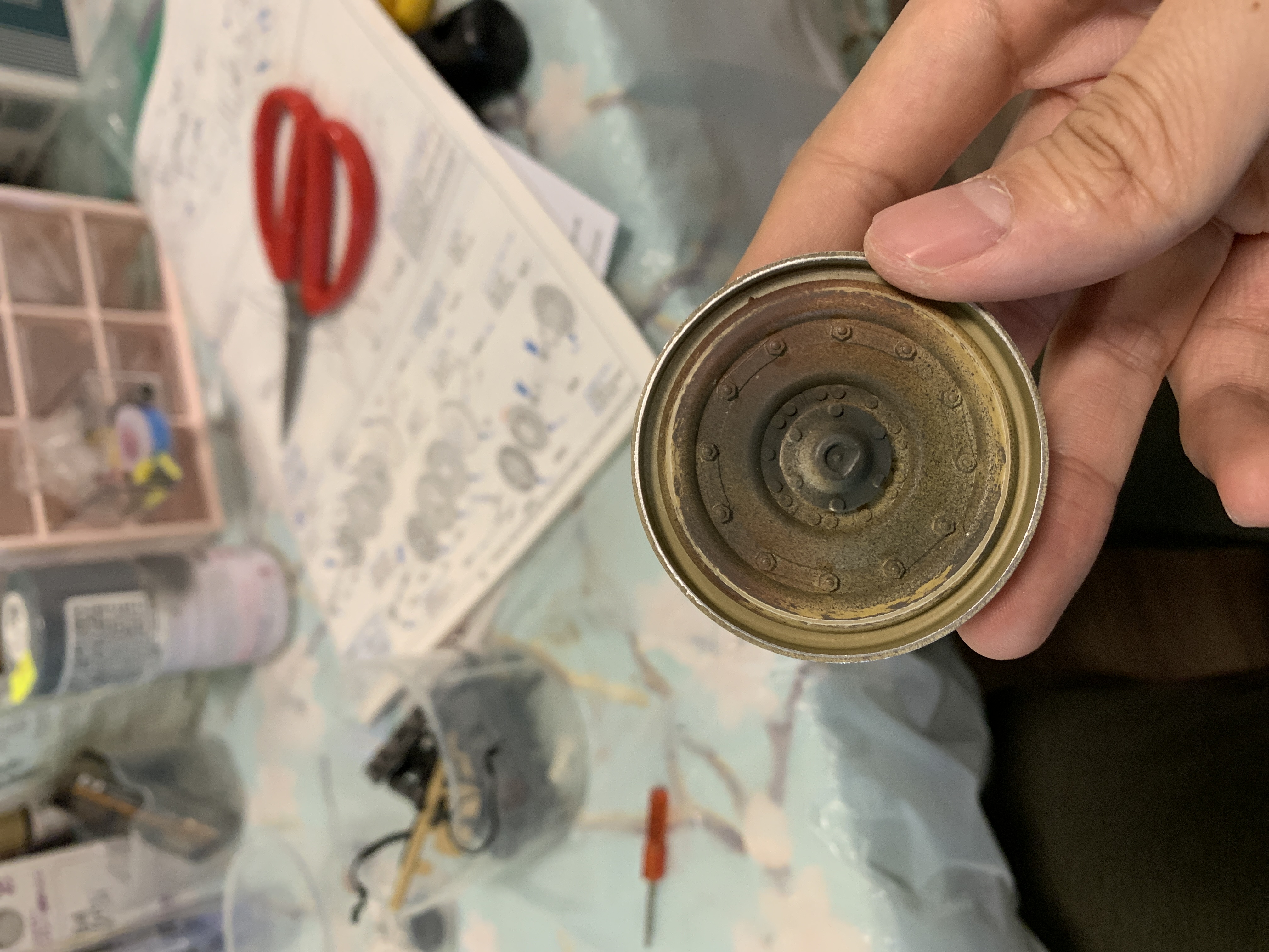

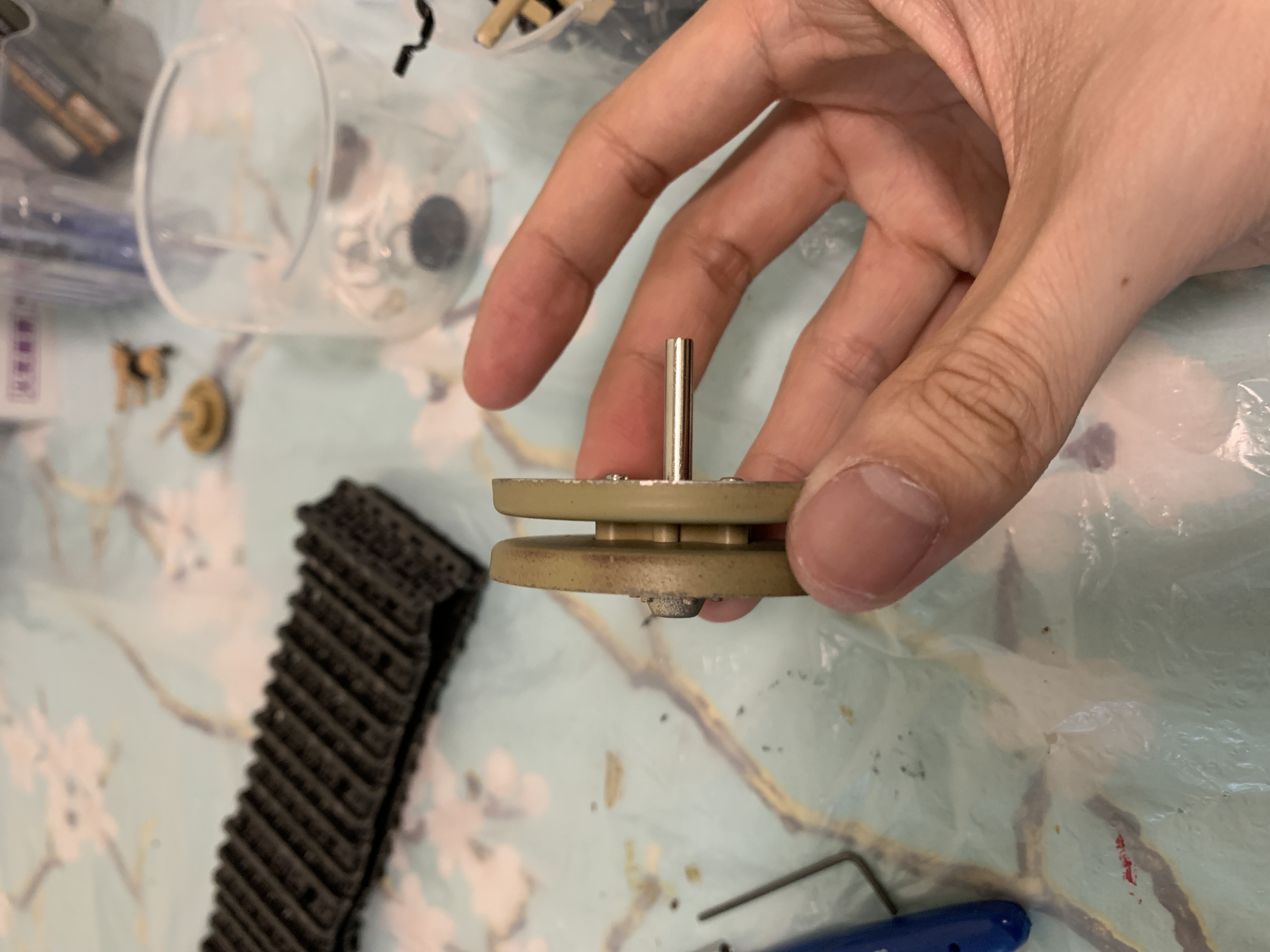

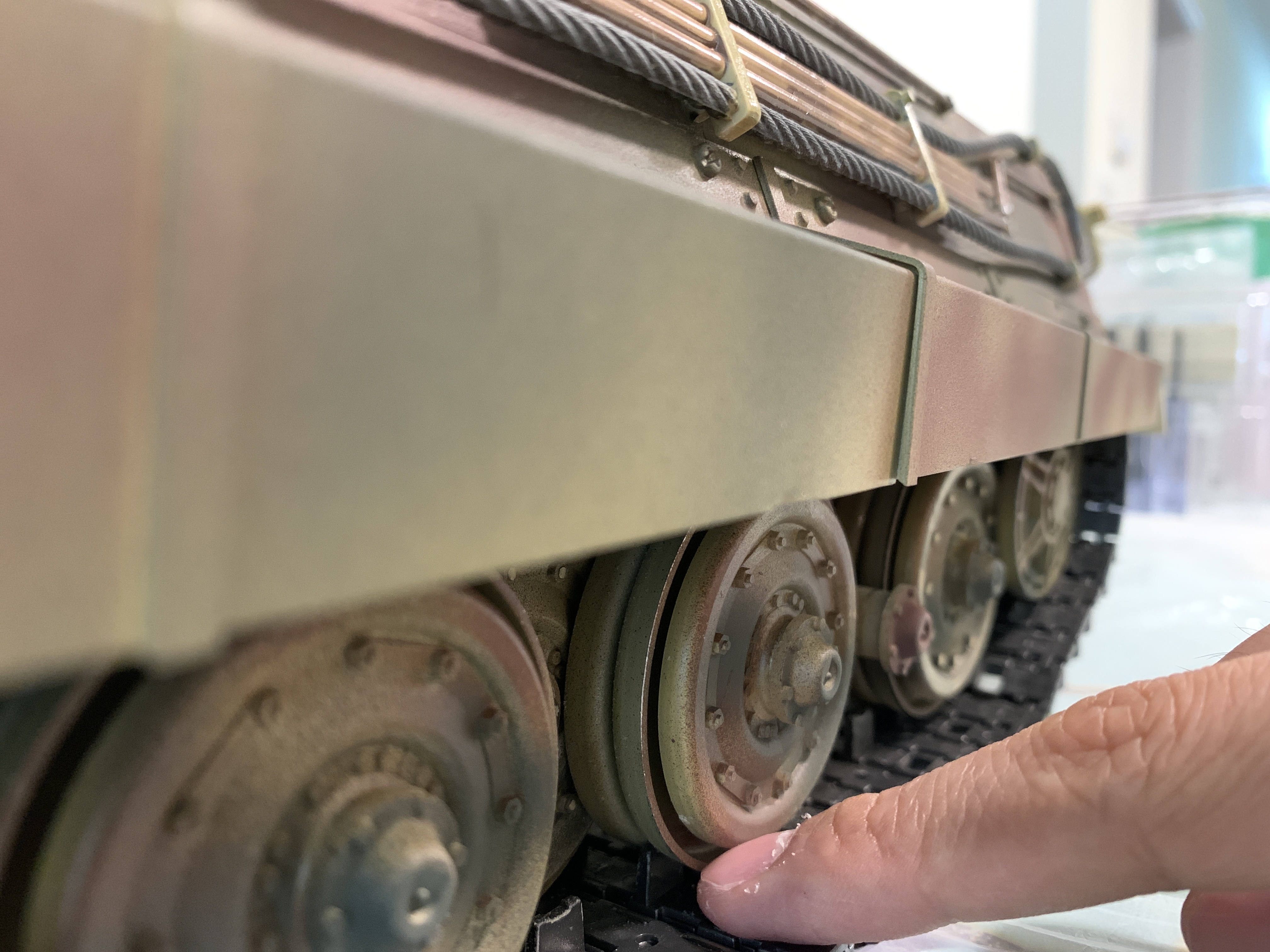

Hello, Thank you for your reply and my track teeth do go into the wheels but the grey thing that separates the two metal disc, what item # is that? None of the MF pieces are big enough to create that level of separation, and could you also tell me what I did wrong
There is no extra grey part. It seems the issue is you have assembled the wheels wrong. Check the gap between the wheels in my red king tiger. The tracks teeth go between each side of the wheel.
Edit: please try taking a pic of the wheels where we can clearly side the sides.
Another picture of the side it shows track teeth between the two sides of the wheels

Michael151722 wrote: Fri Jun 28, 2024 7:05 pm
Sir, with all due respect, those wheels are wrongly assembled and your tank will not work good until you fix them. Remove the wheels, unscrew them and fit the metal parts correctly. Otherwise you will have the issue
It must look like here, Image And not like you assembled it. if the metal parts touch each other, is wrong.
But worry not, is an easy fix. In 15 minutes it should be done

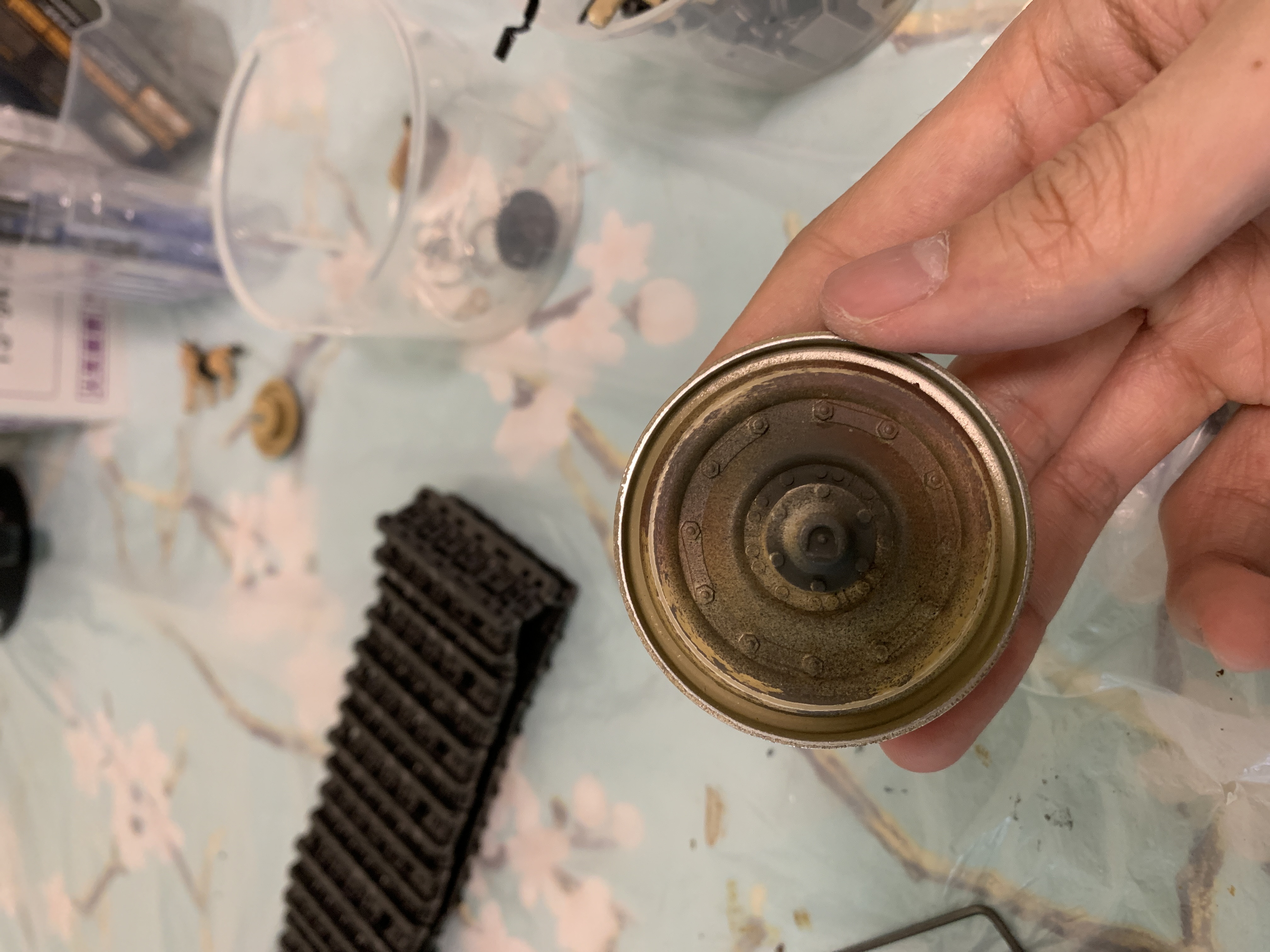

Hello Mate, appreciate for pointing that out for me, I think I got the hang of it, is this correct?
Michael151722
Posts: 122
Joined: Sat Jun 22, 2024 3:30 am
Re: 1/16 Tamiya King Tiger Road Wheels won’t spin
Post by Michael151722 »
Here is another one here
Rad_Schuhart
Posts: 2089
Post by Rad_Schuhart »
Yes, that is it.
