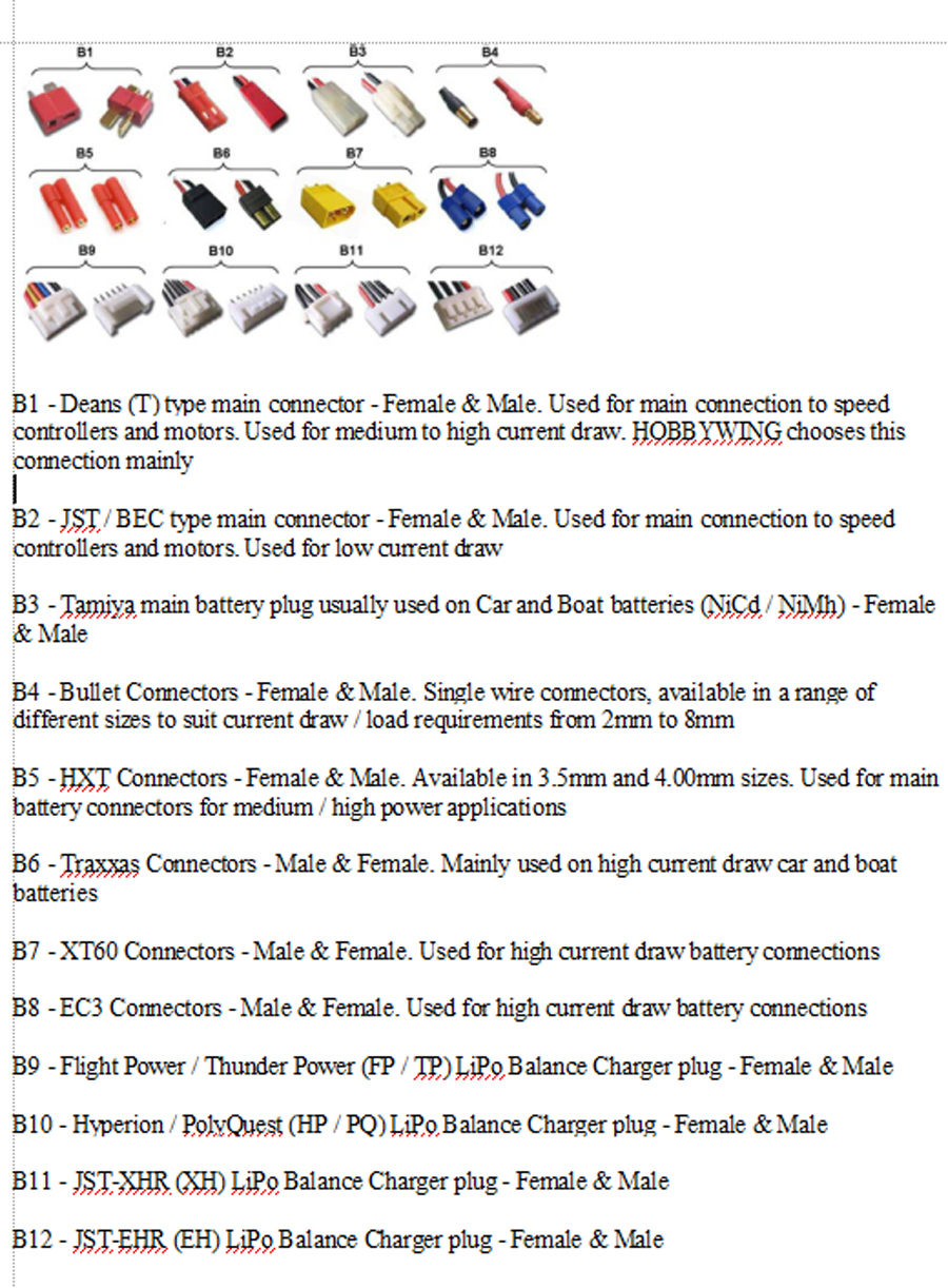

As a matter of interest.......does anyone know what these brown plugs are known as and where I can buy a couple of new ones ?

Hi, Zooma! I get these kinds of connectors (and others) either from a local RC car or drone shop or ("local" being in my case not so nearby) right off of Amazon. Go to Amazon UK (I use US for the colonies) and search "jst connector kit" or just "jst connector."
Here is an image with names of some of the types of connectors. As you can see JST actually indicates connectors of a few types. Nothing about electronics is clear entirely clear :crazy: .

They are Molex "Micro-Latch" connectors as far as I know.
Crimper...available in the US from Digii-Key https://www.digikey.com/en/products/det ... 00/1880141
