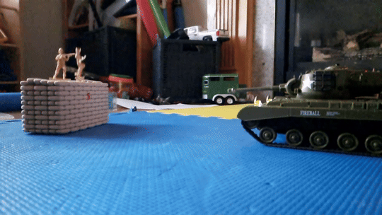

Hi LukeZ,
Just wanted to let you know that I was able to complete the project and let you know I appreciated the assistance. Added a little GIF to show the bunker in action.
- ezgif-6-45ed5b45ba.gif (2.49 MiB) Viewed 2463 times

Ooh! I would have gone bananas over that action 60 years ago. Fast forward 60 years
