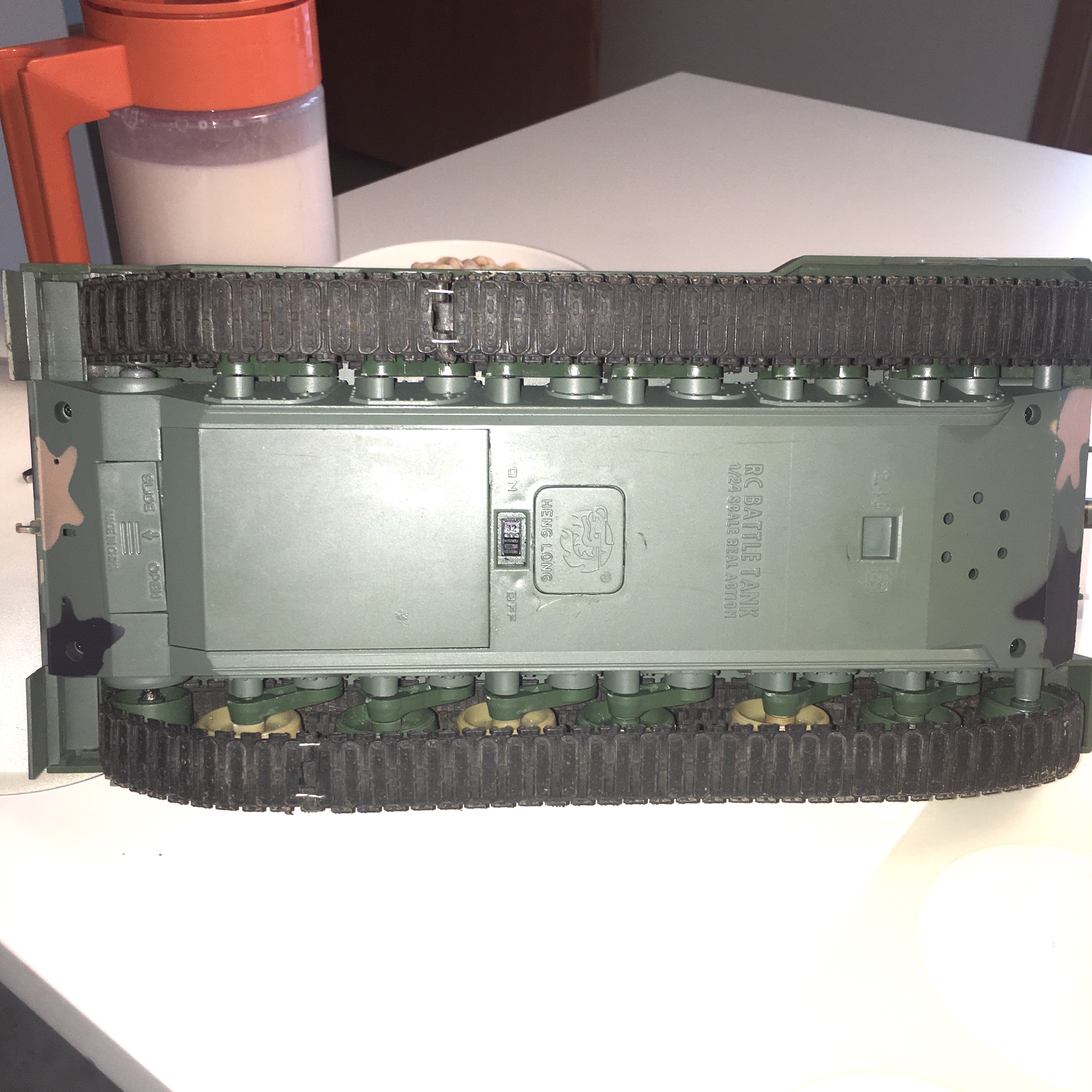

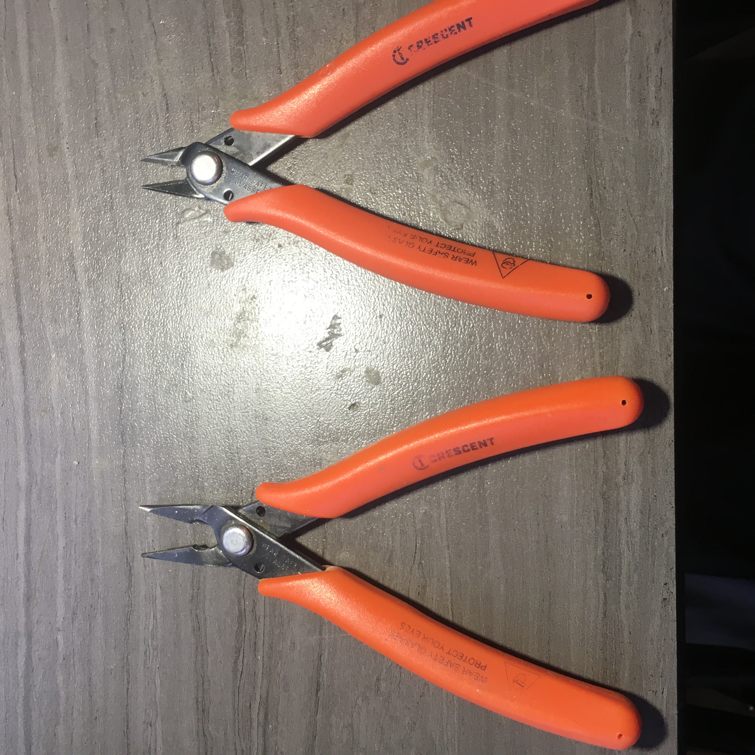

These are my "track repair" tools
Here are my stash of 1/24 Tanks. There is a 1/16 at the far right.

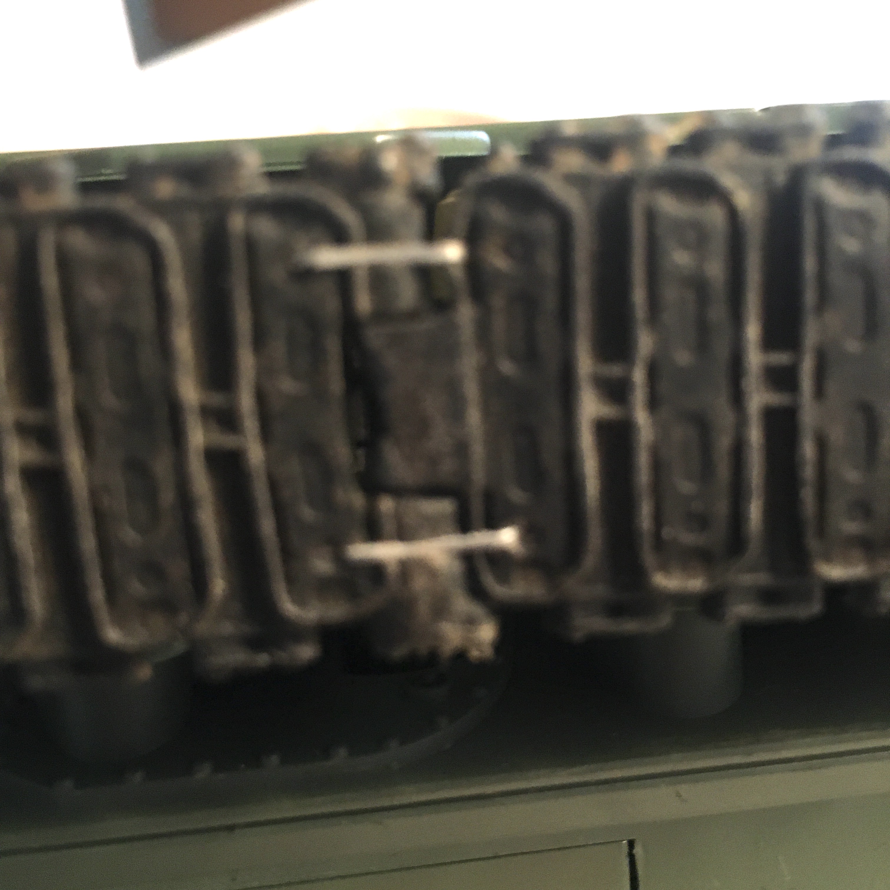

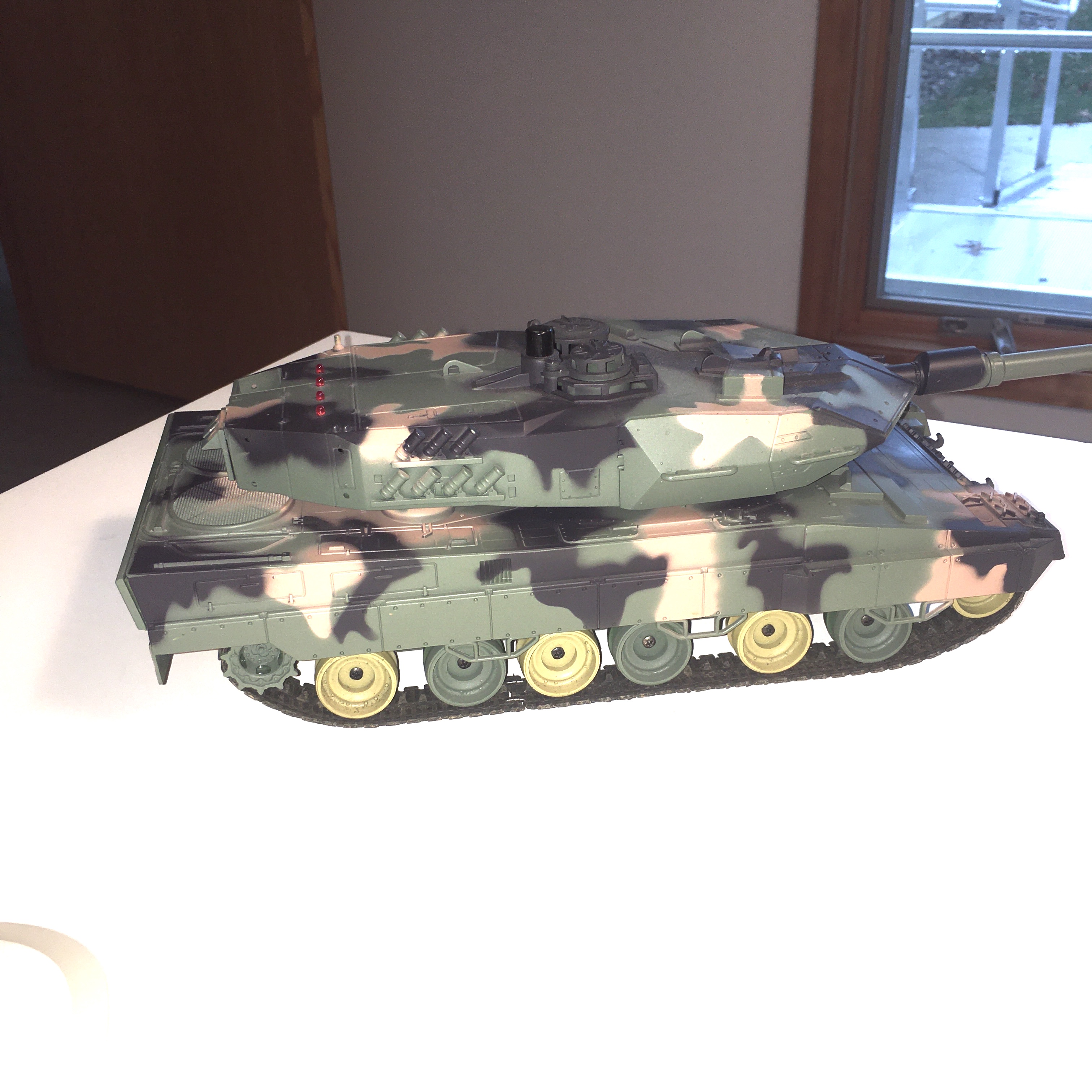

Track repair visible on this Leopard II.

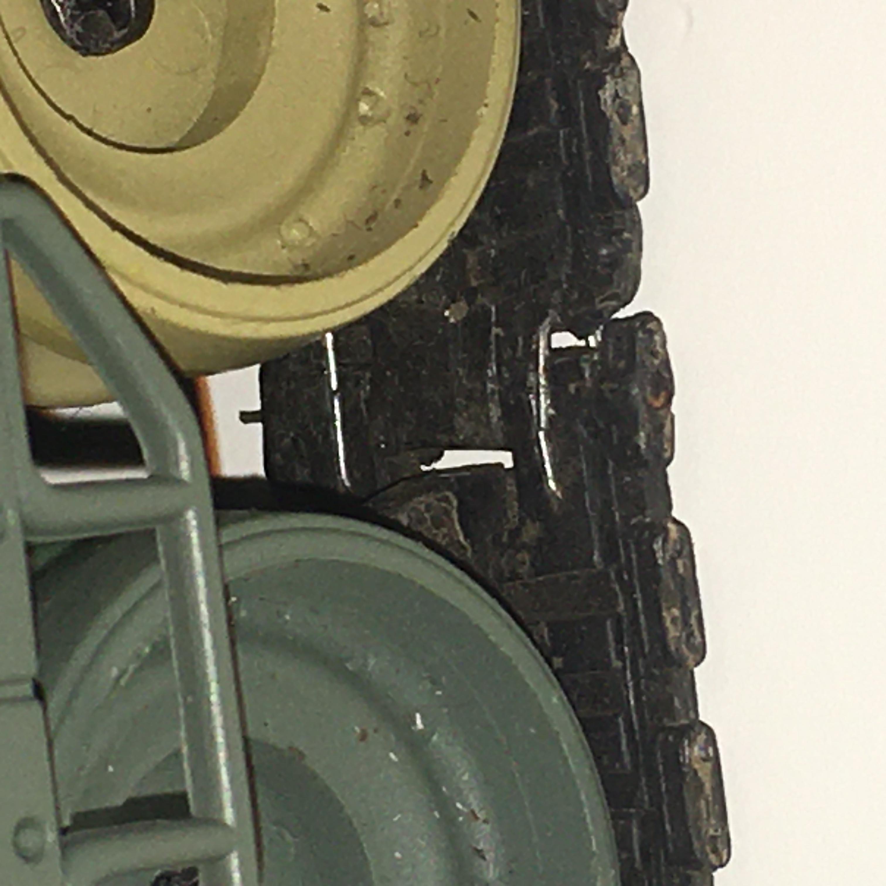

This track broke and you can see space between the connection point. If this mod is done before the track breaks, It probably will last longer. This tightens up the track as well as the connection point (metal pin) is where they stretch.  The repair staple inboard in this pic is preferable as it is a little wider. Make both look like that for best results. Requires patience and proper tools to do this. It may take a few tries to get it done. If you are good at this, then do double staples with the optimum width.
the staple pins should go through those little round moldings in the track. Mine are a little short of the optimum width. After reviewing this picture I see the best spot now for the staple width. takes patience to bend the staple to the exact width. Perhaps a form could be made for this like at a factory. A press mold to configure the staple. Oh, just thinking out loud.

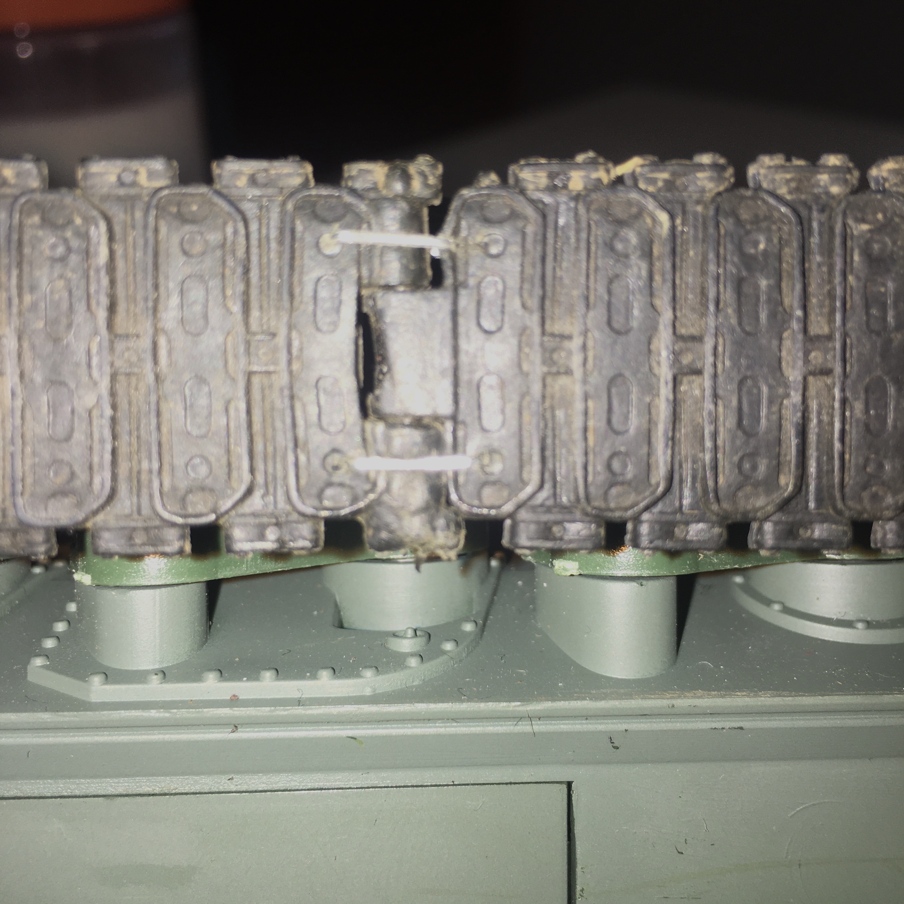

The lower track has has had the mod done before it breaks. This also helps keeps the track tension where it needs to be as the track pin connection area stretches and is the weak spot on these tracks.

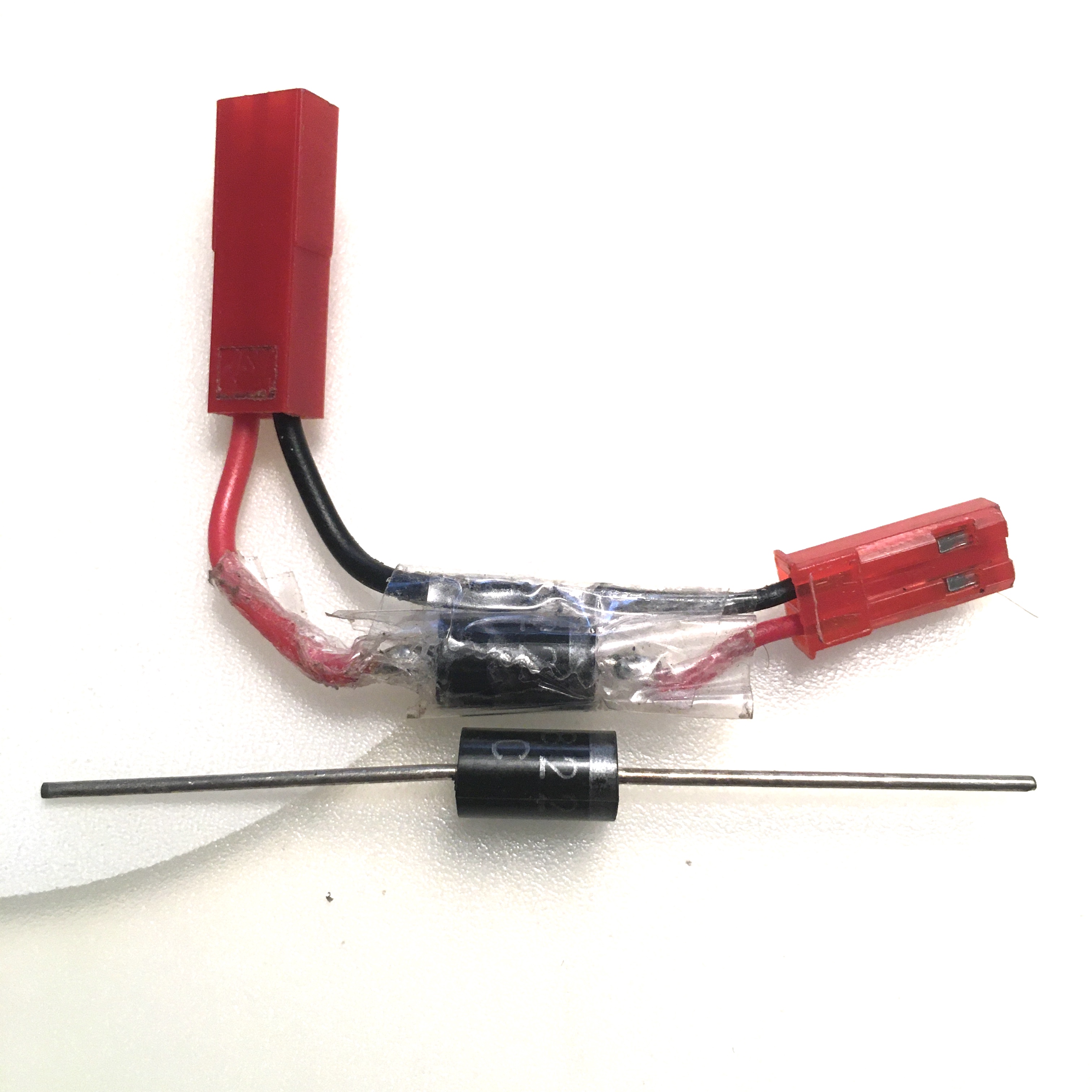

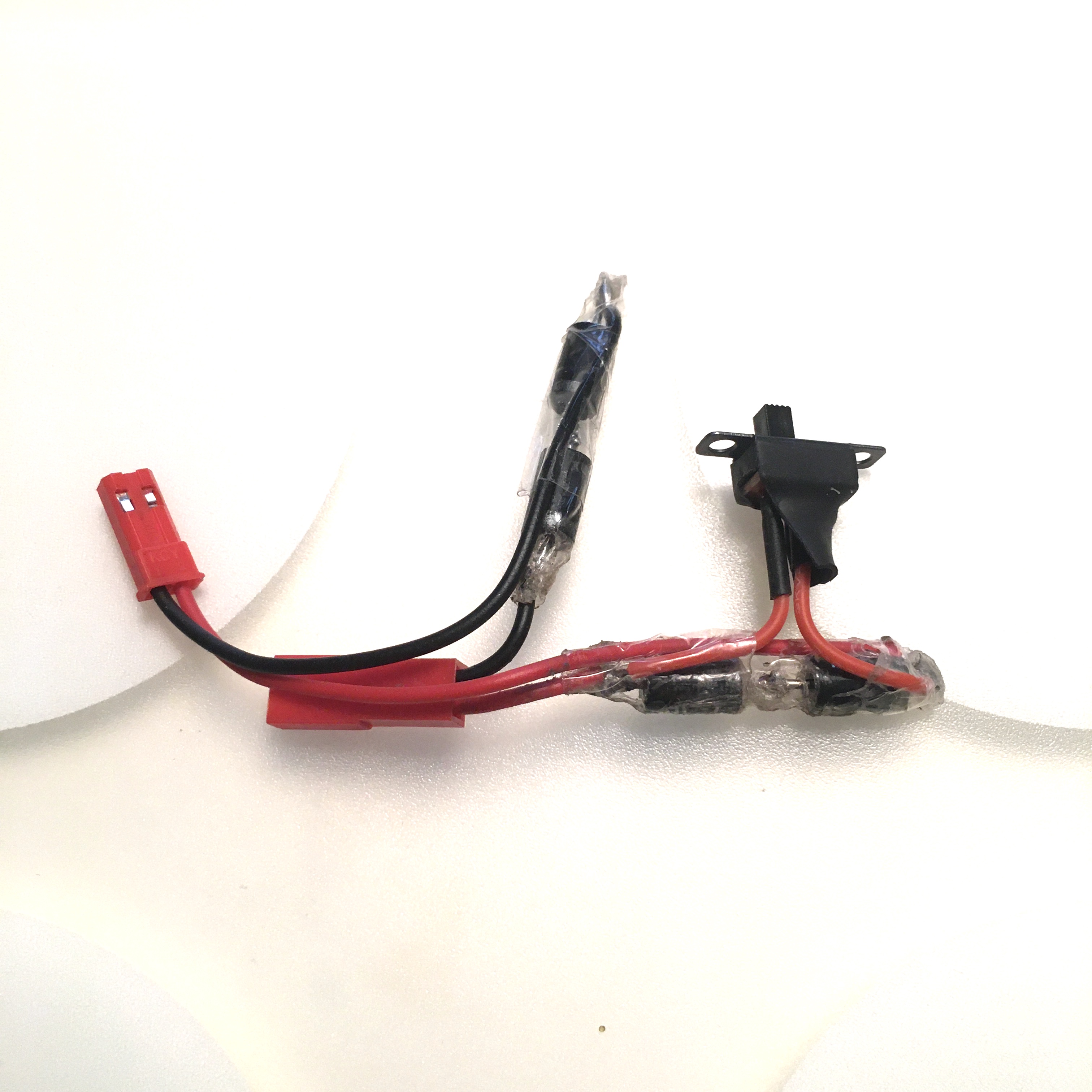

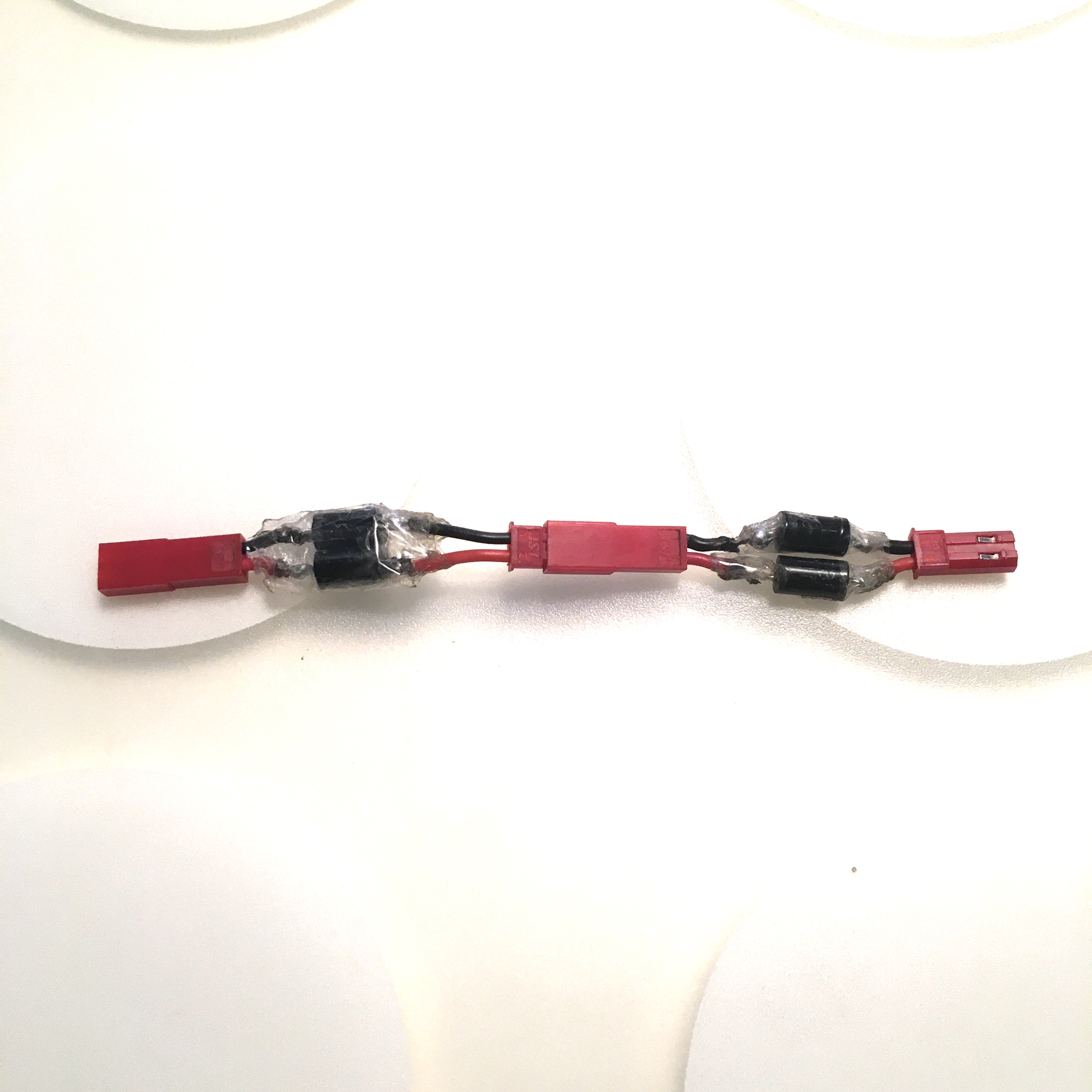

That would work if you can find a way to attach "it" to the Tracks. I have the same problem with my 1/24 HL Tanks but used a different solution. I made up a current limit diode adapter that limits the power to the tracks through a voltage drop through the "Schottky diodes". This plug in mod makes the Tank more scale like with respect to Track speed and power.
HL motor power tuning kit
These are the diodes I used for this mod. All connectors changed to JST ~18 AWD. Lipo battery connector also changed to JST.
1 diode voltage drop. Anode goes to source + (Lipo RED), Cathode goes to load side -Black.
2 diode voltage drop from supply source showing diode polarity with respect to Black - Red + wires.
connecting 1 diode with 2 diodes make 3 diode voltage drop.
Connecting two diode pairs = 4 diodes in series voltage drop.
4 diodes with a 2 diode bypass switch. What is that switch for right?  It is for finding the optimal number of diodes (voltage drop) in a particular application.
