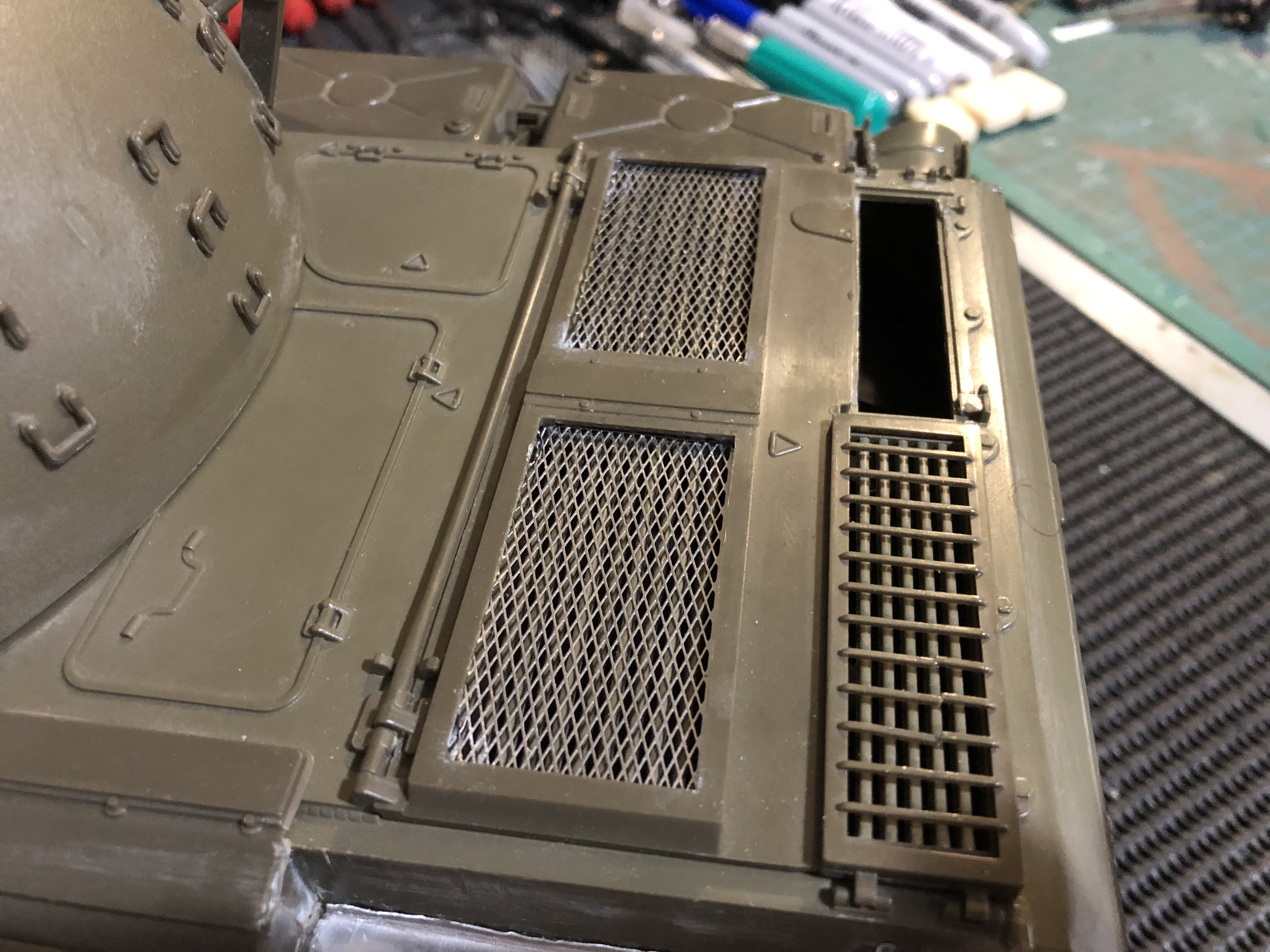

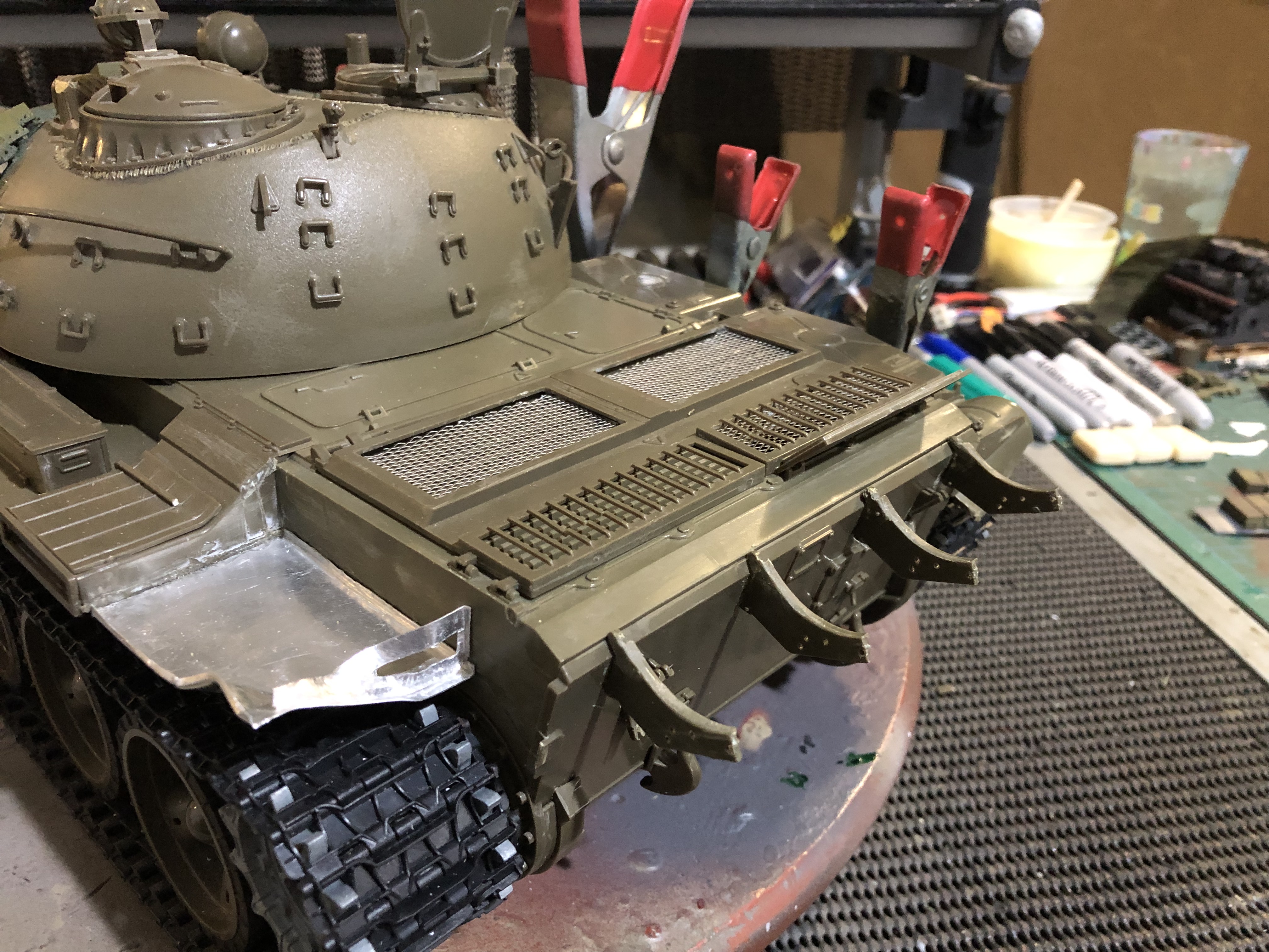

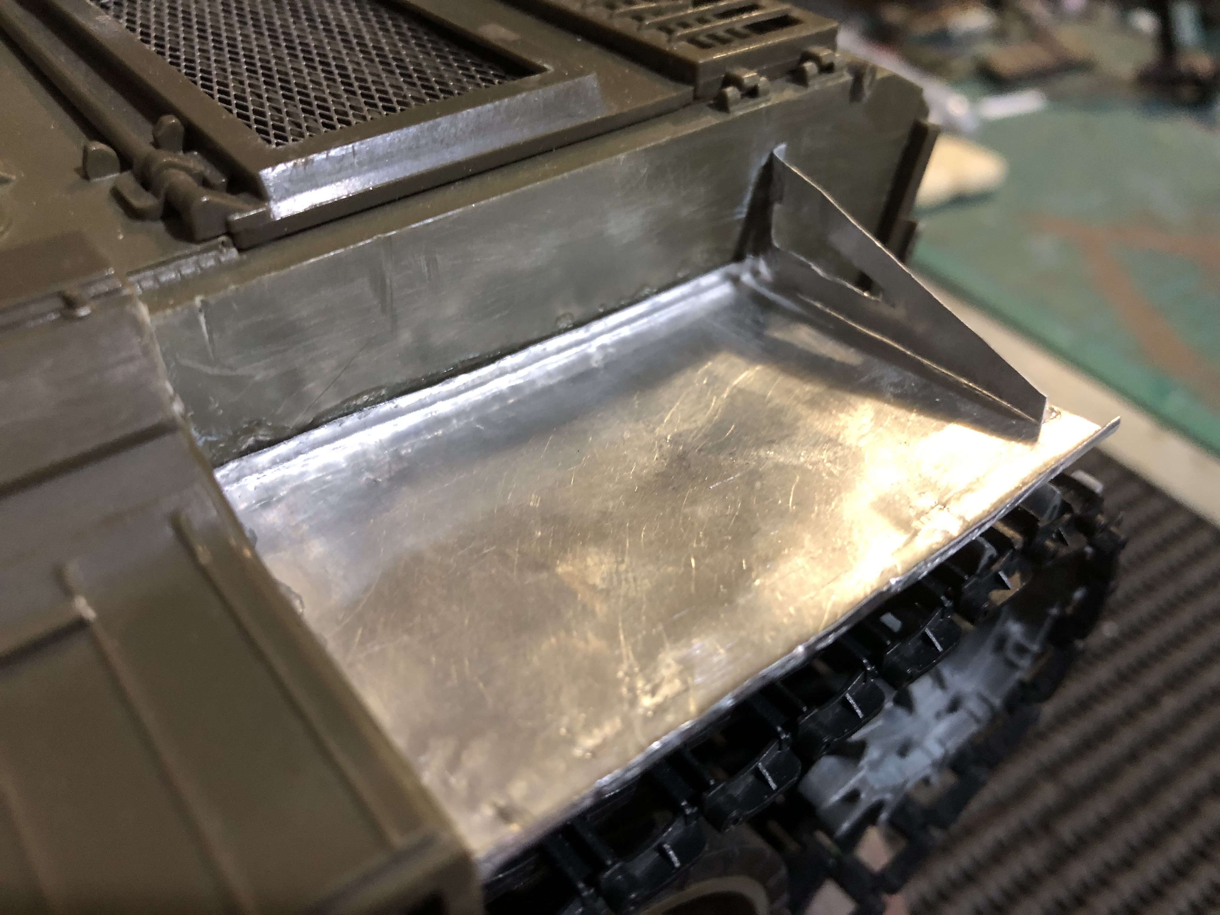

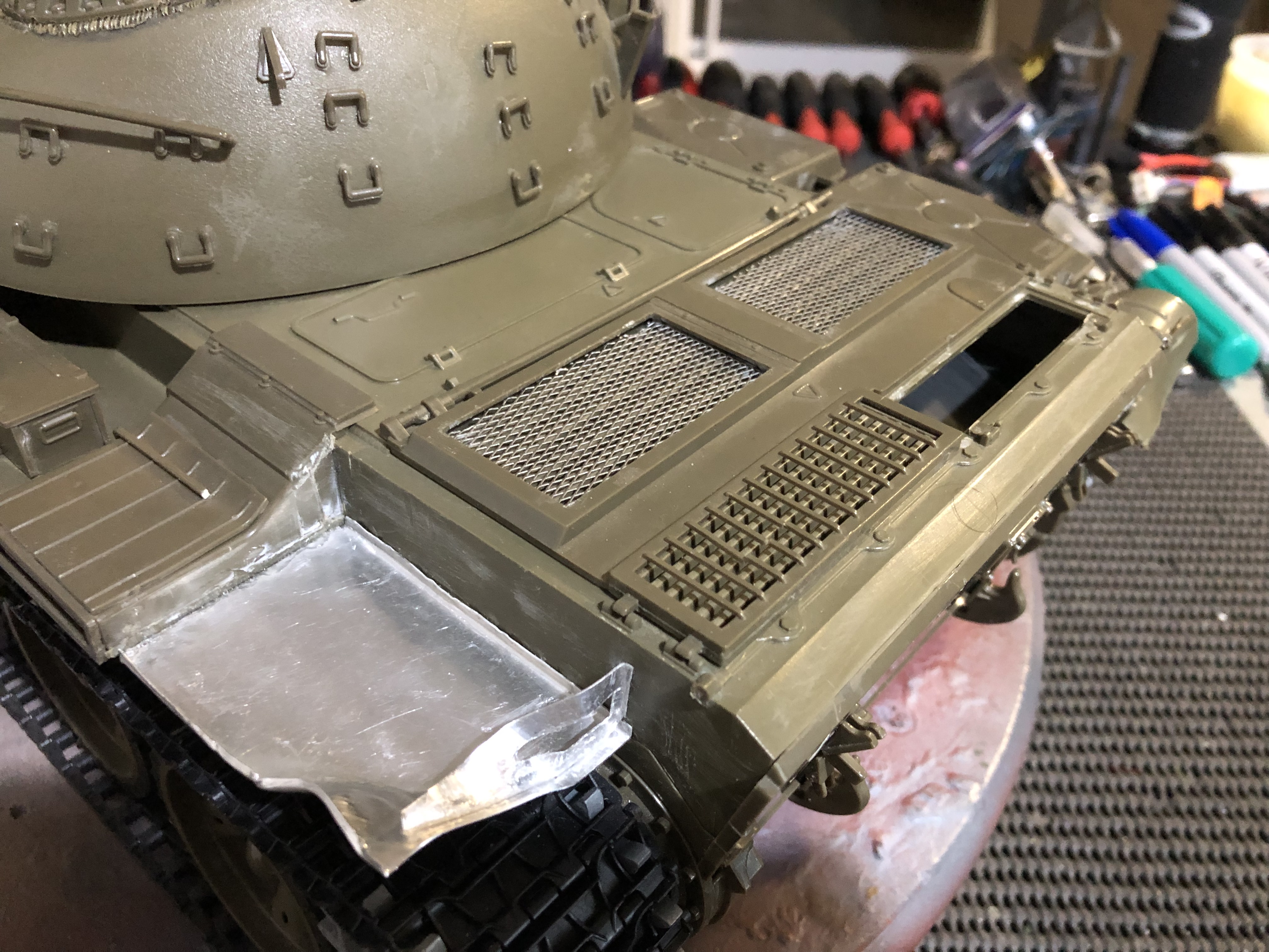

I found time & a bit of mojo to make a replacement rear guard section so I can rough it up a bit and create a bit more visual impact.
A bit of aluminum & a little bit of fitting & its an ok look.
Also used the last of my ZTZ99 engine deck mesh to fill in the vent louvers, not perfect but this entire thing wont be !
The weird behaving brittleness of the Hooben plastic is most disconcerting, its turns to white when its sanded, wants to fracture if its twisted, and doesnt respong to normal model cement/glue, only super glue.
Still, Im just happy to have one and I intend to make the best of it.

I was able to get the white bottle Plastruct glue to adhere styrene to it, but I also clamped the pieces I was gluing. It is some strange plastic like all Hooben kits, but sadly it is better than all the plastic on the kits after.

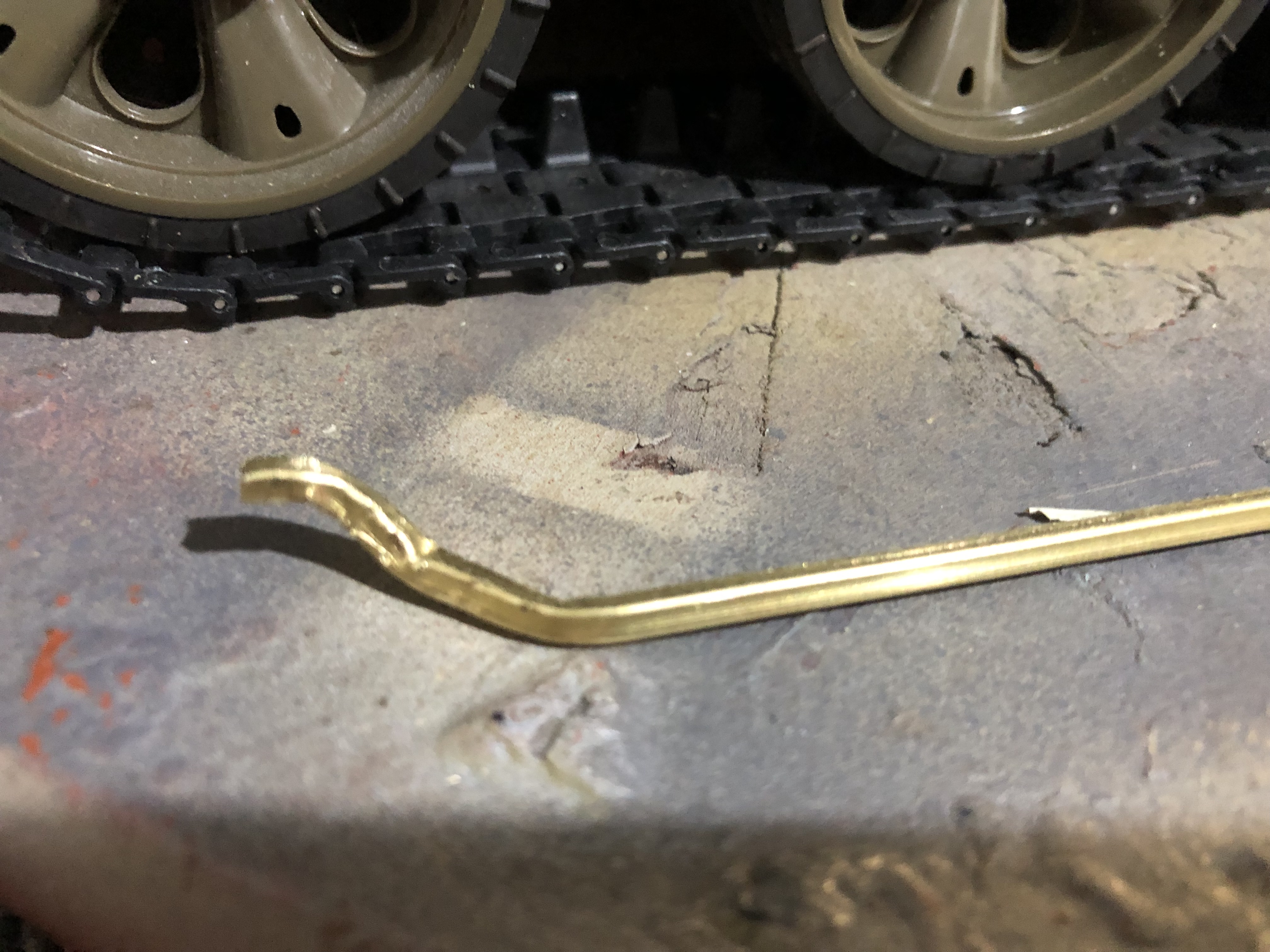

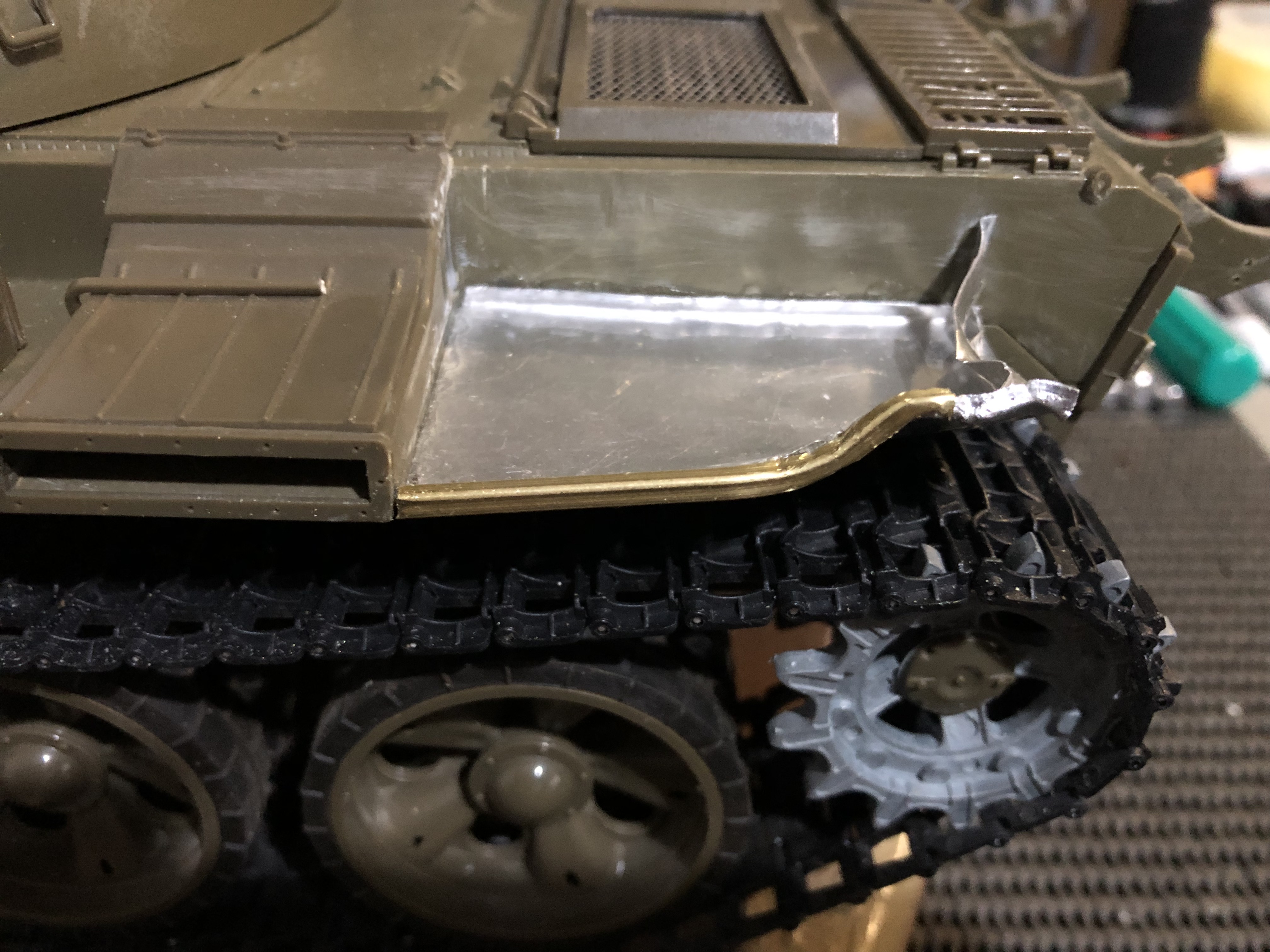

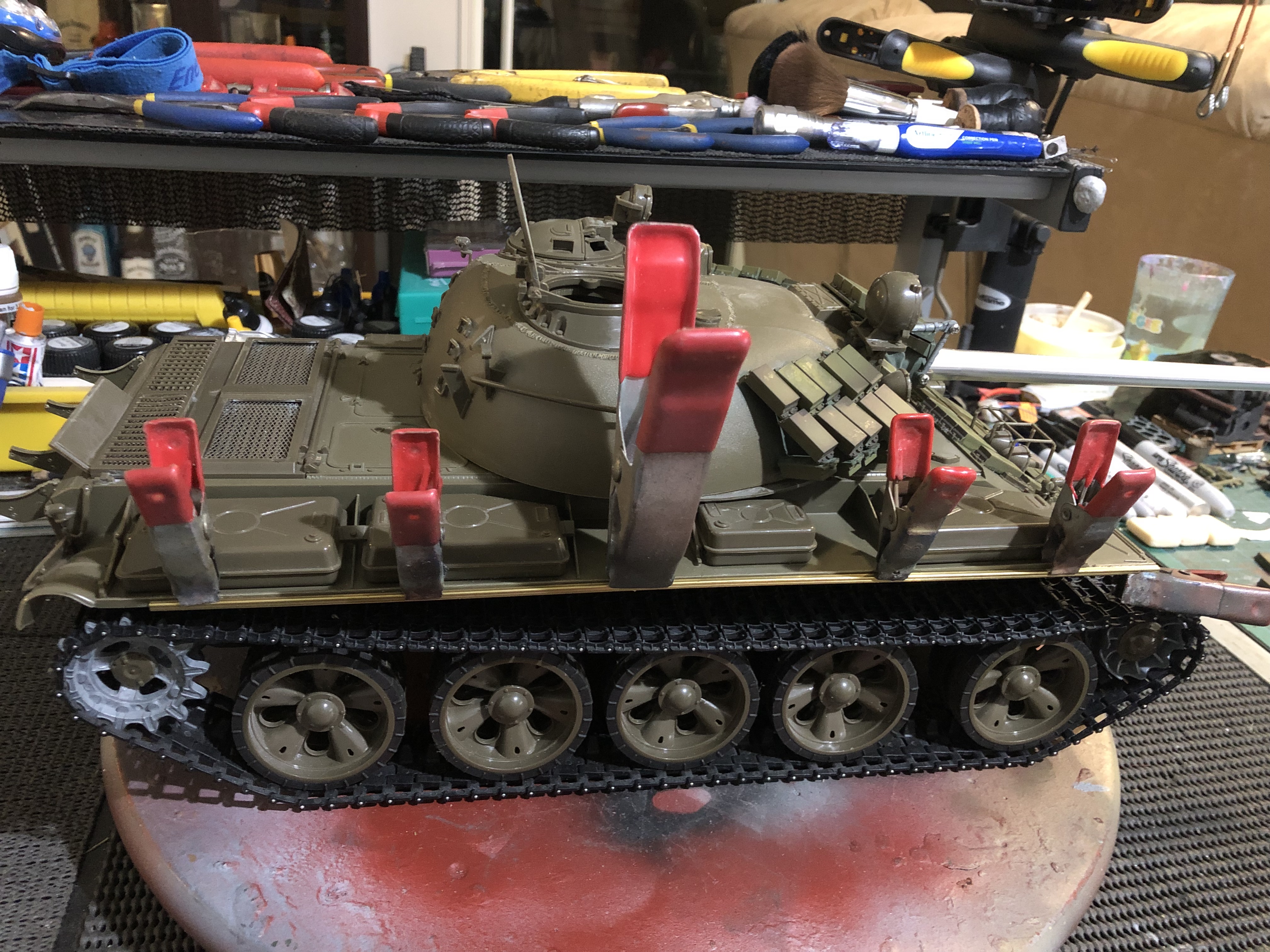

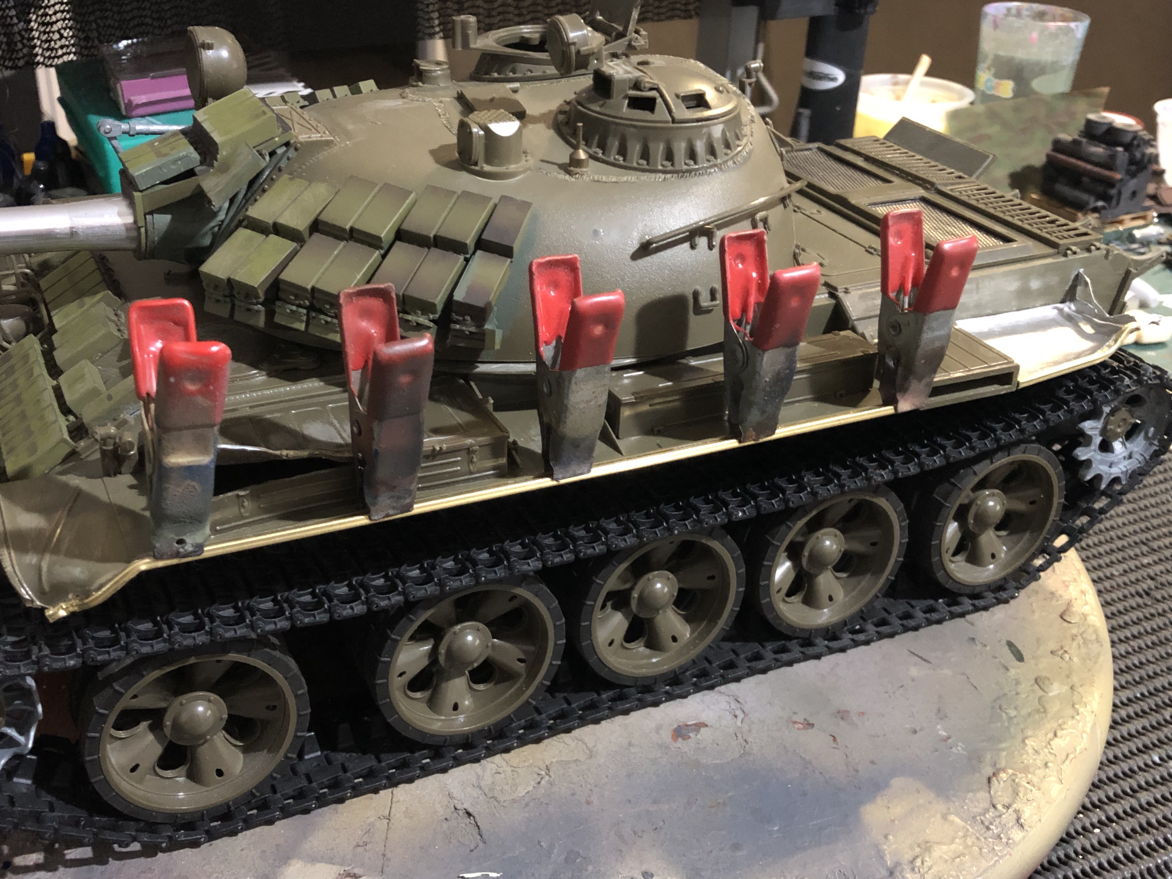

A little progress. I made some rubber side skirts out of a surplus pool patch used to repair leaks in vinyl pools that we used to have.
Quite thin and flexible, and fibre reinforced so should hold up if I fasten them right.
I've run a bit of brass square section along the side of the guard to space the drop out a bit from the track run.
Plan to secure it to the sides of the guards and bung the ERA blocks onto it in a near enough fashion.
Not all the AU T55's had it, some had no skirts, some had skirts , some had ERA on the skirts, some with skirts had no ERA, some had their skirts jammed into the upper track run with ERA blocks on them, like an explosive wedgie, more skirt action than a nightclub in Surfers Paradise :crazy:
Also trimmed the rear fuel drum mounting brackets & secured them in place ready to help hold the stowage shambles on ! Seems none of the earlier AU T55’s had the drums on the rear, well, where would the garden furniture go if they did eh ;)
Plus they still allow the hull to come apart easily for battery swaps.

For now, getting the other rubber guard mount on the other side was something to be a bit happy with.
As I do it to myself, getting the right rough look is much harder than a new/undamaged look. Forming the brass to match the disrupted plastic is no simple task.
She'll be right, I'll get er.
Get’n bent !

The metalwork looks great, Herman. The effect is heaps better than the wobbly, melted plastic!

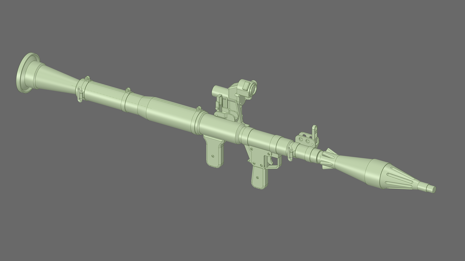

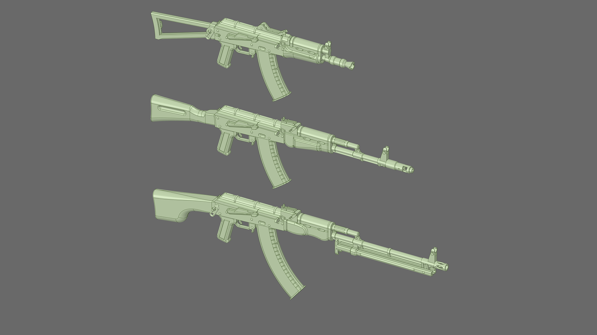

I spent some time over the weekend adapting my AKS-74U drawings into an AK-74, and figured I'd do the RPK-74 too since I was already halfway there. You can never have enough dakka!
The RPG was pretty straightforward (much like the internet, it is just a series of tubes), so I tried adding a PGO-7 scope to spice things up a bit. I can print it with folded iron sights, unfolded iron sights or with the optic attached, whichever you feel will best suit your theatre of operations. I've been printing some stuff for my wife the last few days, I'm hoping to get these done during the week. Let me know if there's any other esoteric stowage you'd like before I get all this stuff sent up to you.

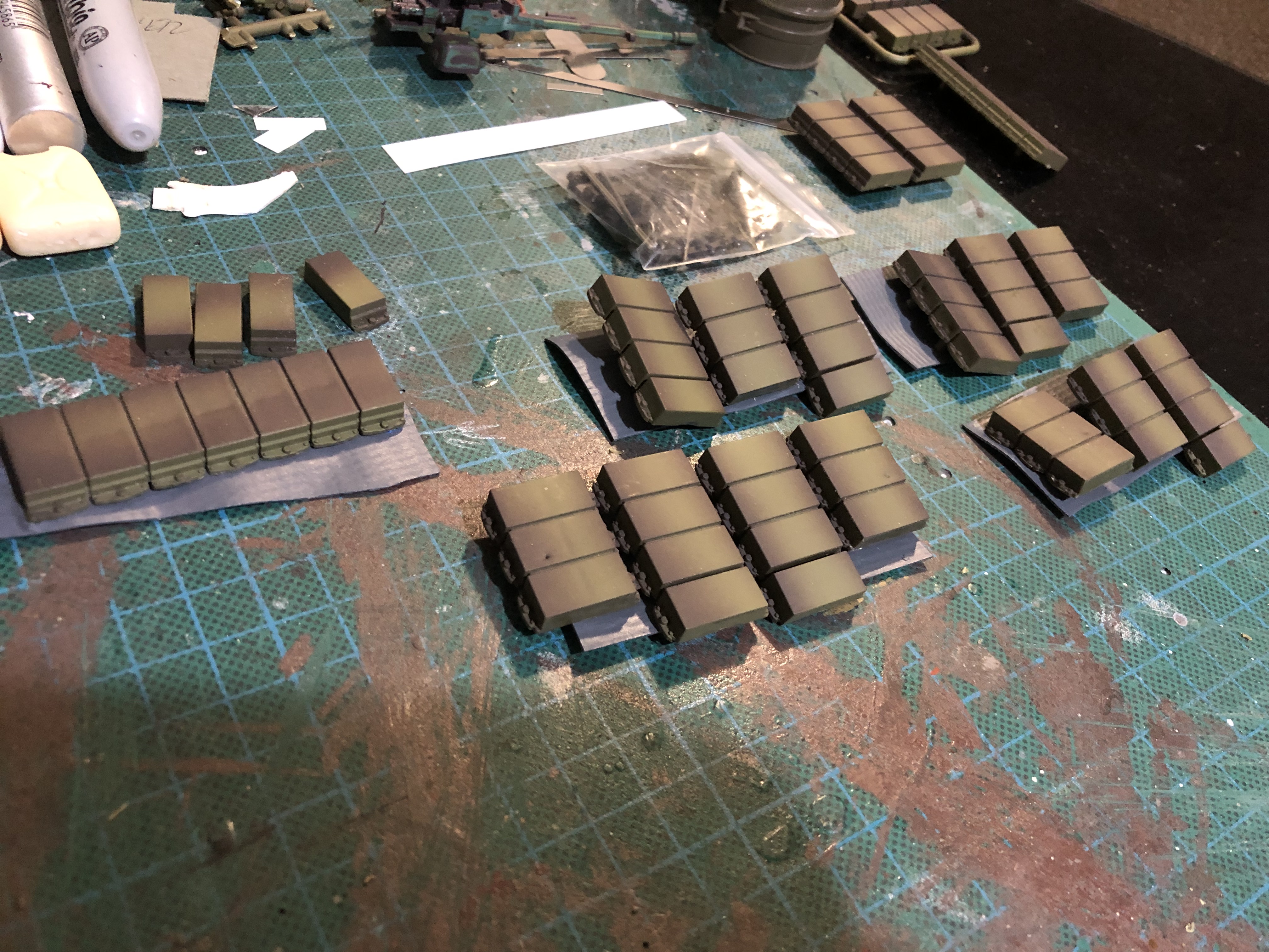

As for any more stowage, the only thing I could thing of would be the 100mm fixed ammo crates to suit the main rifled gun.
The T72 crates are of course 2-piece for the autoloader so are a lot smaller. I can use them as general stowage but not for this I reckon.
The longer one-piece rounds and the crates for them would still be much use to add onto any SU100 model, of which the forum members have lots of, myself included.
Plus the T55 versions that come out of the woodwork at times as they share the same gun (albeit with changes- not to the ammo)
Once you have completed the Wifes mission, the chairs, stools, 20L containers, AK74 variants and RPGs & 100mm crates can all erupt off the production line like the French Forward pack the other morning :'( :'(
